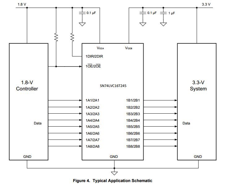

Hello Team,
A-ports is in partial-down mode if 3.3V system is down in the typical application of datasheet under the following conditions.
  • 1/OE=2/OE=L
  • 1DIR=2DIR=L
Therefore, both A and B-ports is in a high-impedance state.
    Is my understanding correct?
