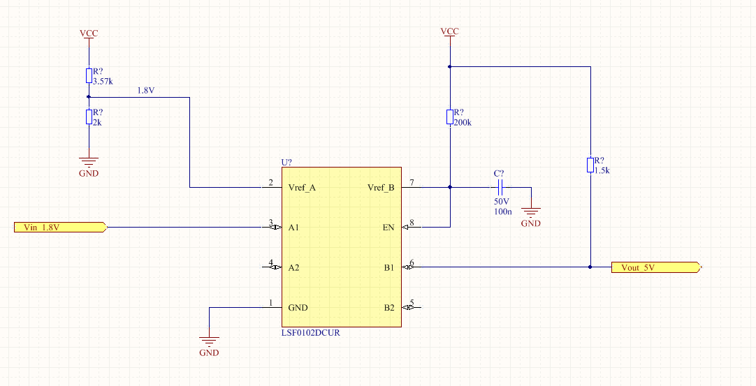

I am using LSF0102 for translating a (180Khz pulses) 1.8V signal to 5V signal.
In my board there is no 1.8V supply. I need only this signal to be translated, I dont want use LDO to generate 1.8V,
I have only 5V supply,   if i use 5V to voltage divide to 1.8V and connect to Vref_A as shown in the attached schematics, this will work?
or there will be any internal impedance will come in parallel?
BR,
