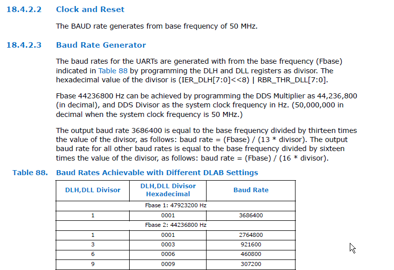

Currently my customer verification TI device TXB0304RUTR & TXS0104EPWR Fail,
Application 3.3V to 1.8V high speed UART up to 50MHz, Can suggest solution for me ? thanks.
Spec as FIG.

The Timing Requirements section of the TXB0304 datasheet states that it can support translaton of a 100 Mbps signal (i.e. 50 MHz clock) if the channel capacitance does not exceed 100 pF. Do we know the channel capacitance in this application?
