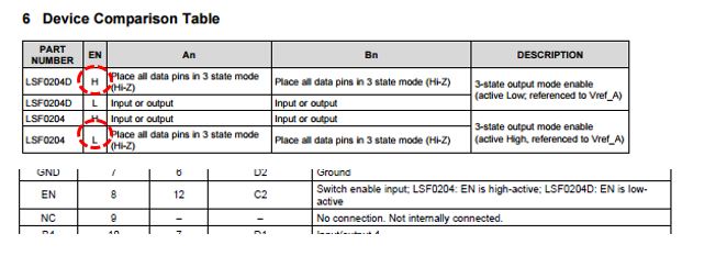

Please attached image of datasheet for LSF0204.
What is a correct active status to operate for LSF0204D?
1ST LSF0204D is "Active High " but 2nd LSF0204D isn't "active high".
Pin map mentioned "active low" for LSF0204D.
Nirav is correct.
To be clear - for LSF0204D:
EN | I/O State |
LOW | Enabled |
HIGH | Disabled (High impedance) |
