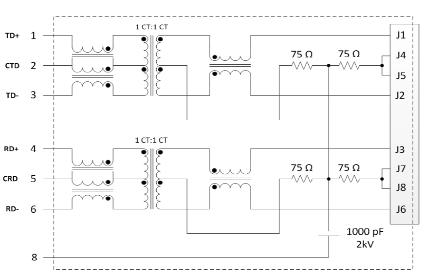

Hi Ross,
We now have tested a RJ45 jack with integrated magnetics which has a common mode choke on both sides (please see picture attached). The connected switch still establishes a link to the unpowered TLK110. Can you please tell us what the exact schematics of the magnetics should be?

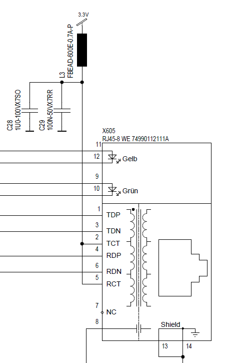

Hi Ross,
No there is no power to the TLK110 from an unexpected path. All the circuits are unpowered. Just the LAN cable is connected.
Yes, pin2 and pin 5 is tied to 3V3 rail. But not directly. There is a ferrit chip bead inductor in series (FBMH1608HM601) with 600Ohm @ 100MHz (please see picture attached, please note picture shows old RJ45 connector type).

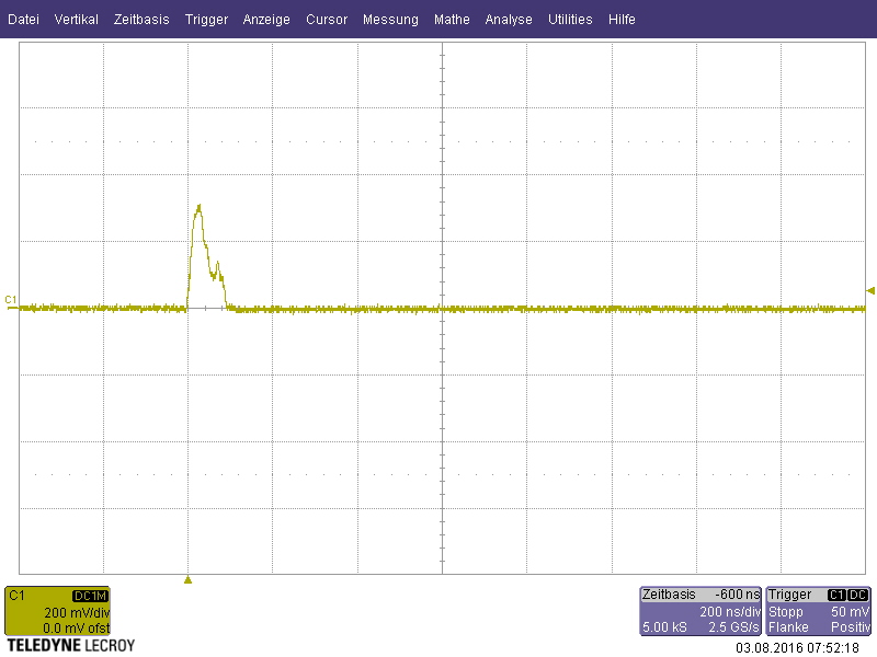

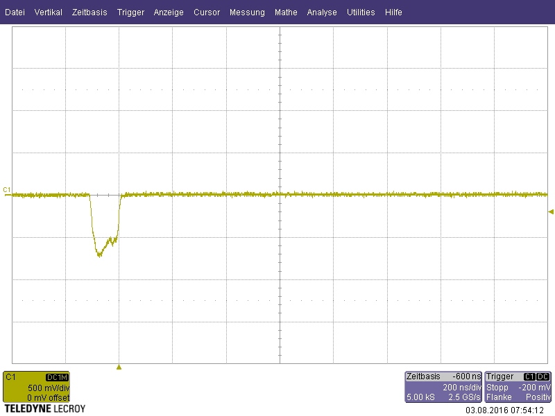

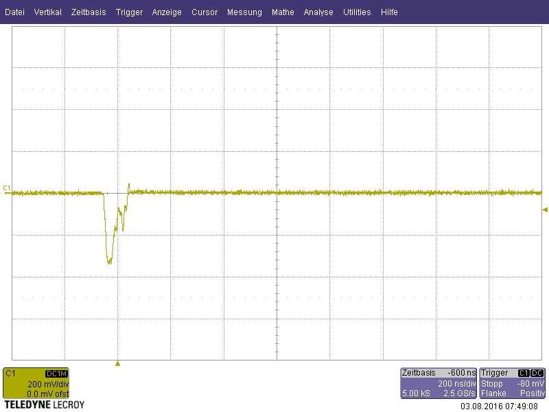

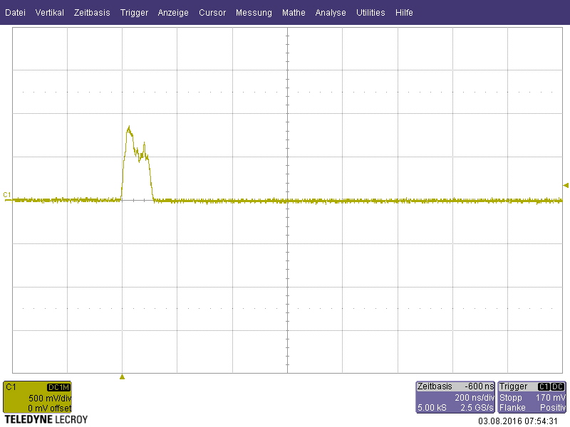

Attached are the signale that I have measured at the PHY (RD+, RD-, TD+ and TD-, please note the different scaling between receive and transmit signals).

Hi Patrick,
The link is because of the parasitic path that Patrick had pointed out in earlier posts.
It had been found that CMC between the device and magnetic reduces the risk of link in an unpowered state.
From what you have shown though is that the CMC is not helping to eliminate this issue.
You might need to try another RJ45 with CMC on the device side.

@ Martin: A Schottky diode from RD- (cathode) to GND (anode) and TD- (cathode) to GND (anode) does the trick. With this modification I cannot see a 10MBit/s link when the TLK110 is unpowered and I have the 100MBit/s link when I switch-on the board. Also 10MBit/s connection is still possible and Auto-MDIX is working fine.
My first attempt failed because I did not take into account that the signals at the PHY go beyond 3.3V rail (probably because of DC bias of center tap).
