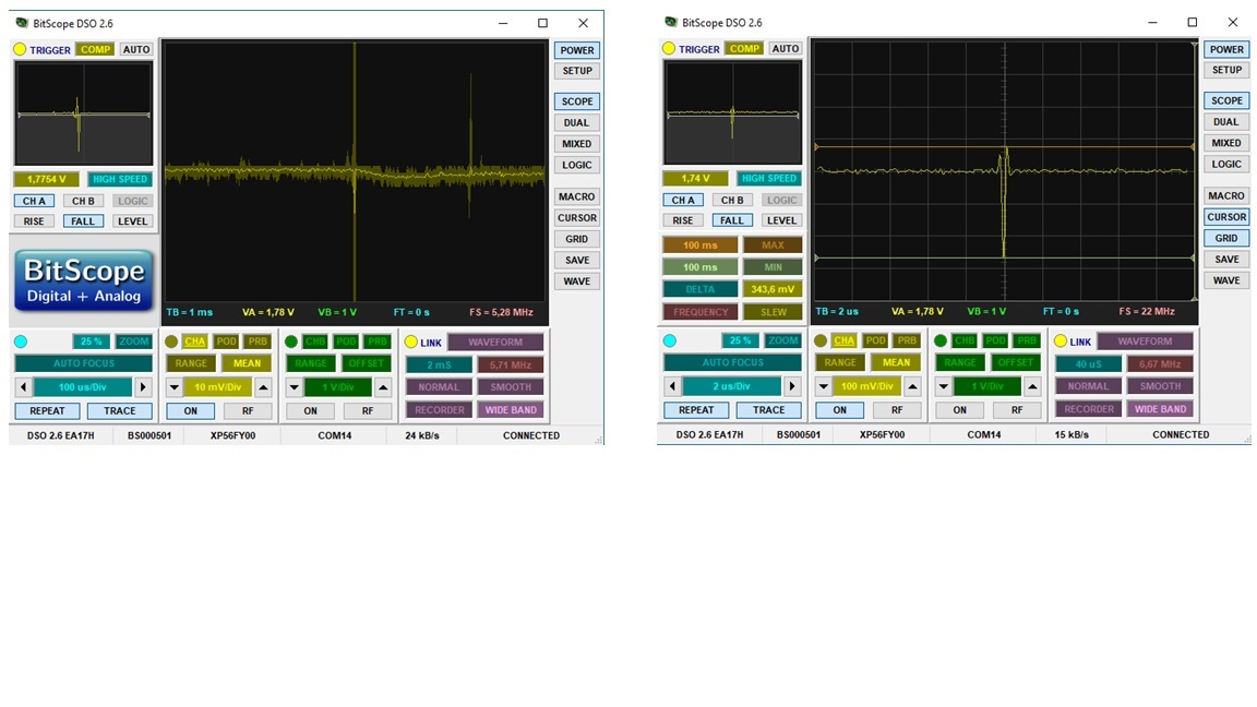

I have a problem with this I2C expander TCA6416ARTWR. everything is fine, but when I turn on a DC 12V 50W motor near to the PCB the registers of configuration are deleted. (without I2C traffic).
The sequence is this:
- turn on the electronic
- I set the I2C: reg 4, 5, 6 and 7 (00, 3F, 00, 3F)
- I read the configuration from this registers and they are fine (00, 3F, 00, 3F)
- no more traficc on the I2C bus
- turn on motor
- turn off motor
- I read the configuration register and they have been reiniciated (00, 00, FF, FF)
I don`t see Vcc noise and reset signal is 10K pull-up near to chip
I guess it is a noise problem, but this one seems too susceptive. what reason can to reiniciate the configuration? How can I improve the desing? Can you help my?

    There are one of two things that can reset the TCA6416A, either Vcc is lowered past it's reset voltage or the RESET pin is seeing a voltage that toggle the register reset.   I would add a capacitor at your reset pin first.  See if that fixes your problem.
    Make sure your scope is not bandwidth limited and look at both Vcc and RESET pins during the motor startup and shutdown.  Try and make low noise measurements, hopefully you are using short ground probes and make sure the probes have a high enough bandwidth to capture the event.
    My guess is that adding a decoupling cap on RESET will fix it.  You might have to play with the values.  It would be nice to capture the event that way we could get more information.  Please send waveforms if this doesn't fix it.

    My scope is bad (it is a USB scope) 20MHz 12Bit and my probes are worse ... (6MHz).. What features do you thik that I need?
    With this devices, I see:
    reset pin:
    I think that this es little variation

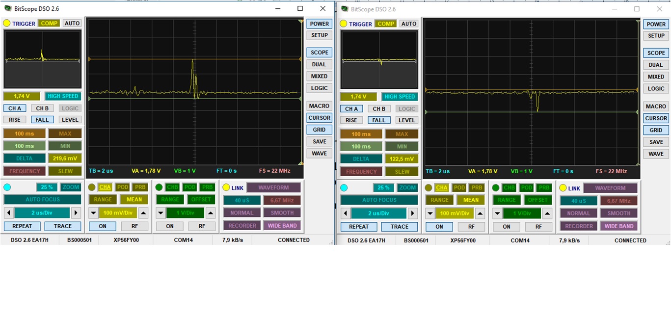

    With a 10uF in reset pin (the problem is smaller but if I move a lot of the motor the registers are deleted. the signal with 10uF:
    Finally, I disconect the reset pin and conect it to 1,8V near directly. The problem is similar to that of 10uF in reset pin. Then, I also connect 10uF in paralel and the problem is similar. signals:
    What do you think? I need a new scope...I guess....?

    Your scope probably isn't fast enough (wide enough bandwidth) to capture you noise event.  Also, what is your ground reference for the probe and also the ground reference for the device.
    It looks like you are using Altium.  Can you send me the packaged project so I can review the layout.  If the grounding and the location of the decoupling caps isn't done correctly then you might have issues like this.

    It's this:
    Hello Francis,
    U2 only with 22uF ceramic capacitor in RESET pin is OK. I can’t make it fail. Without this capacitor, if turn on the motor then U2 is restarted the 90% of the times. Without this capacitor and with a 100nF capacitor in VCCP, U2 is restarted too.
    The capacitor in RESET pin seems the solution. However I will add a capacitor in VCCP too in the redesign.
    Now I have only the same problem in U13 when I turn ON/OFF the motor. Then I connect the 22uF capacitor in RESET PIN then it improvement (of 90% of times to 10% of times). It’s less frequently that without the capacitor, but is a big problem too. In U13, VCCP and VCCI is the same connection. In the design, a 100nF capacitor is connect to this connection (C42).Then VCCP and VCCI have the same capacitor.  I’ve put a 22uF capacitor in parallel to C42 too but it don’t improvement.

    I'm glad to hear you have had some success in addressing the problem. To help improve things further, one thing that may make sense is to introduce some series resistance on the reset line in addition to the capacitor. This could help reduce the currents that flow when noise is induced via the cycling of your motor.
