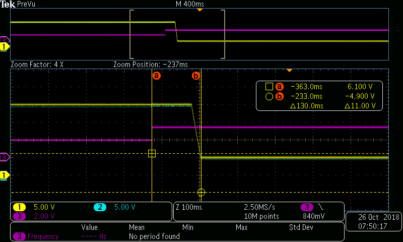

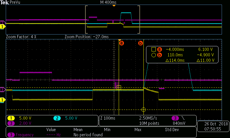

  • Hi Eric,
    I attached some screenshots from the oscilloscope. To me it looks like the voltage is rising fast enough.
    Yellow: VBUS
    Blue: VDC
    Red: CC line
    1st connect
    1st disconnect
    2nd connect:
    I am not sure why the CC line is going to 3,3V shortly before the negotiation.
    I also noticed, that the TypeCStateRegister (0x69) is reporting the Unattached.SRC state after disconnect, but the TPS is still sourcing VBUS, which is not right according to USB Type-C Specification Chapter 4.5.2.2.7.1 Unattached.SRC Requirements
