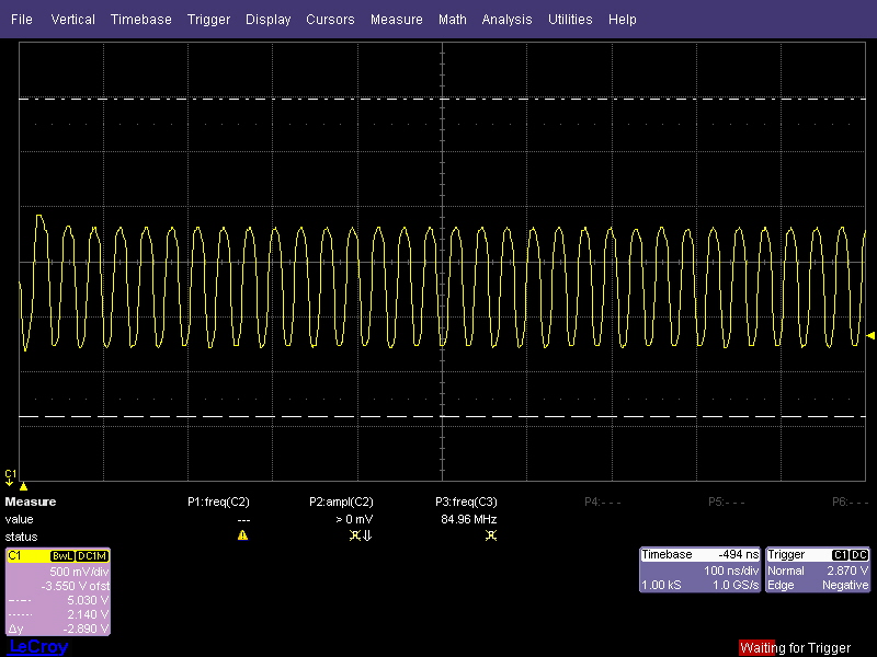

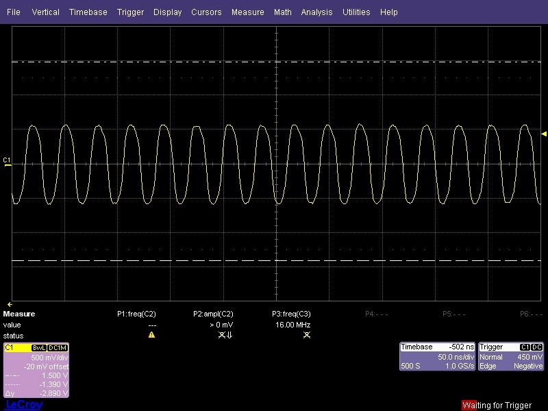

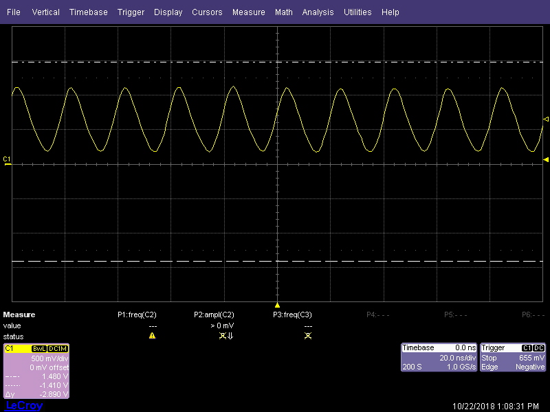

  • Hi Yaser,
    Here are scope shots of the noise.  In order of the images, they are on the Ri+ line, VCC, and GND line.  RI lines are most common.  sometimes vcc and gnd pick it up too.  Remember from the schematic, the vcc and gnd lines have a ferrite bead between them and their source 3.3v/gnd.  sometimes removing the bead will fix the issue, and sometimes it wont.  Also as a refresher, this sometimes happens with no cabling connected, and sometimes happens when a cable is connected but not terminated on the other side (left floating).

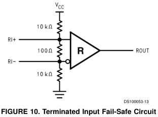

    Anyway, the LVDS receiver has high-impedance inputs, so when the signal lines are not actively driven, they are likely to pick up even weak noise. And when that noise crosses some threshold in the receiver, you get switching currents at the same frequency. For that case, you should add fail-safe resistors:
    It's possible that you get antiresonance between the parallel decoupling capacitors, and the beads might produce an LC oscillator. Try removing C357 and C359.
