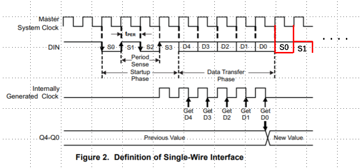

I have a question about TCA5405.
We want to output data continuously.
Is it need to interval next signal(S0) after sending(D0) ?
If it so, let me know how long interval it need.

Hello Kengo,
"Is it need to interval next signal(S0) after sending(D0) ?"
From my testing I found that if I did not add about ~20 microseconds of delay the output would sometimes not be set correctly. I suggest you leave a ~40 microsecond delay though just to be sure.
-Bobby
