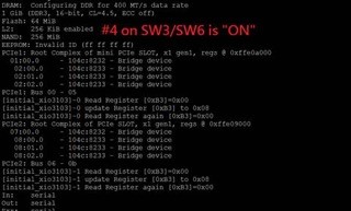

In our Design, We are using  two XIO3130 PCIE Switch and connected the UP Stream Port to P1020’s SerDes1 & SerDes2 Port.
One EEPROM (AT24C04D-XHM-T) is connected with Each XIO3130 Switch through I2C.
When we keep the SCL pin of I2C Low (SW3/SW4 -Pin#4 ON), we can see the all PCIE Switch in u-Boot but after keeping the SCL High(SW3/SW4 -Pin#4 OFF) the u-Boot can’t detect the PCIE Switch.
Here EEPROM is pre-programmed Externally as per TI Forum’s Guidance using Ardino.
We also share the Images for the u-Boot and EEPROM file for reference.

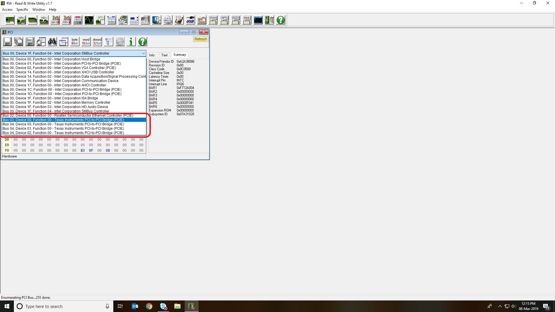

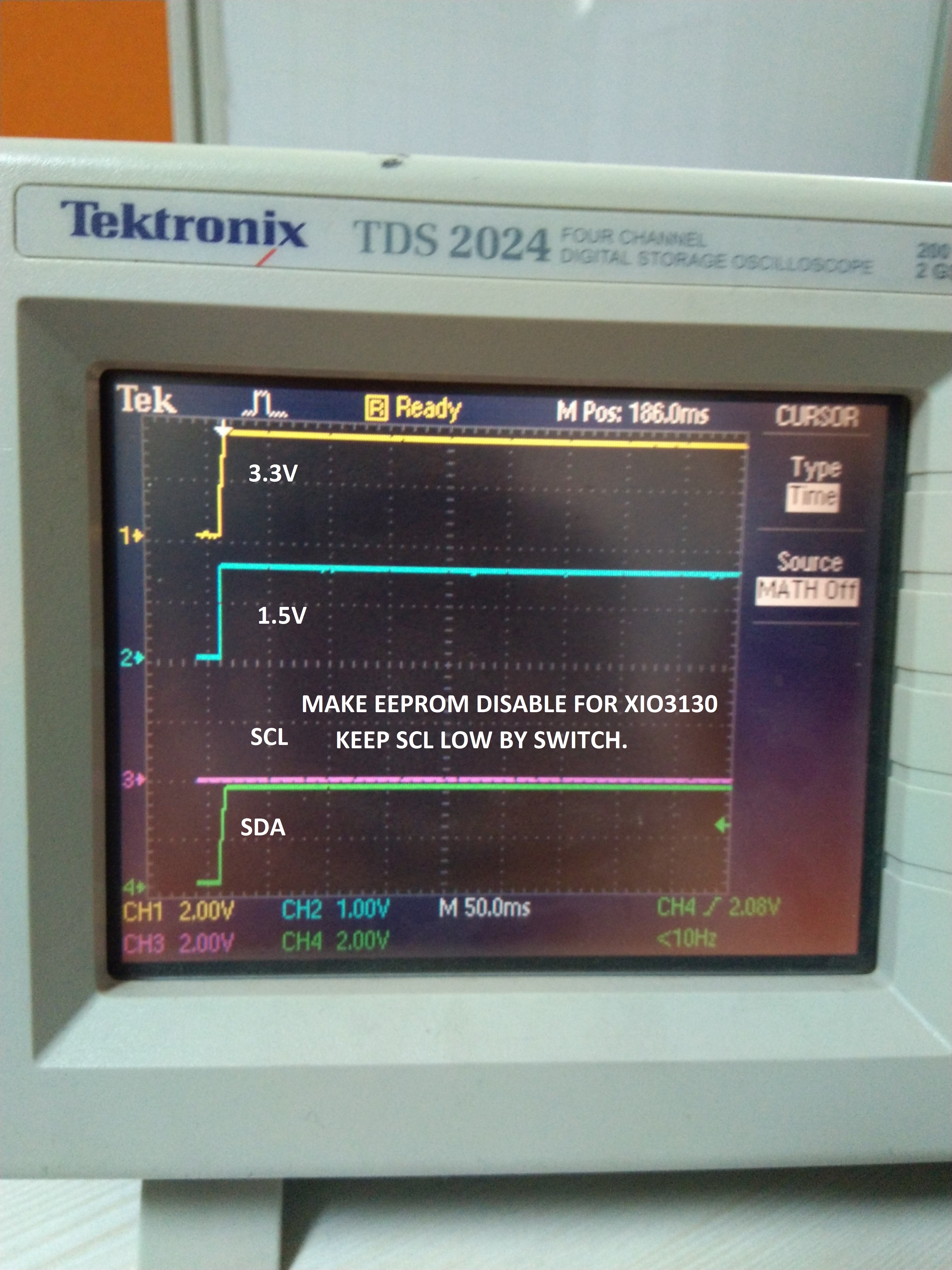

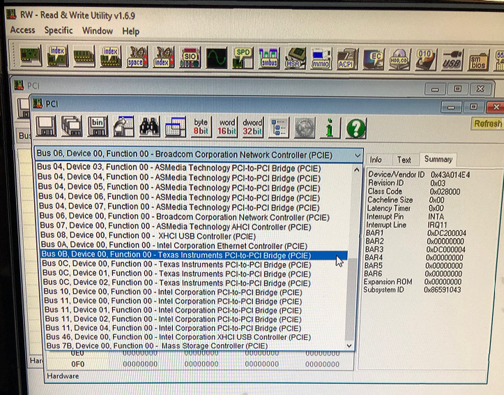

    Actually we can access the XIO3130 switch when we keep EEPROM Disable by making SCL LOW and that time Log display the PCIE Switch in u-boot but when we keep the EEPROM Enable by making SCL High and Log display the PCIE Switch is not Detect. Images are already sent in last post.
    We observe the same problem in all Assembled Proto-Boards (5 Qty).

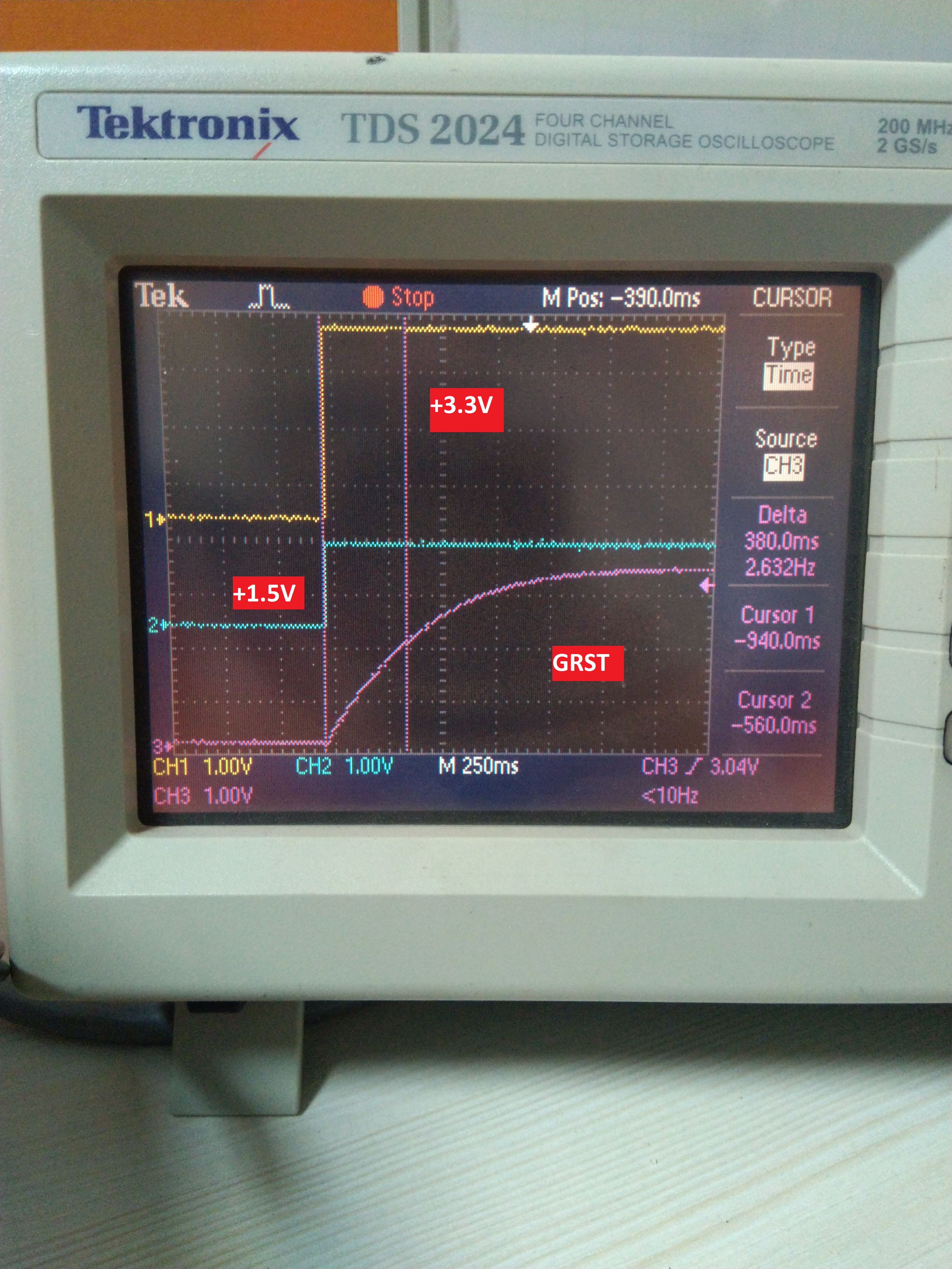

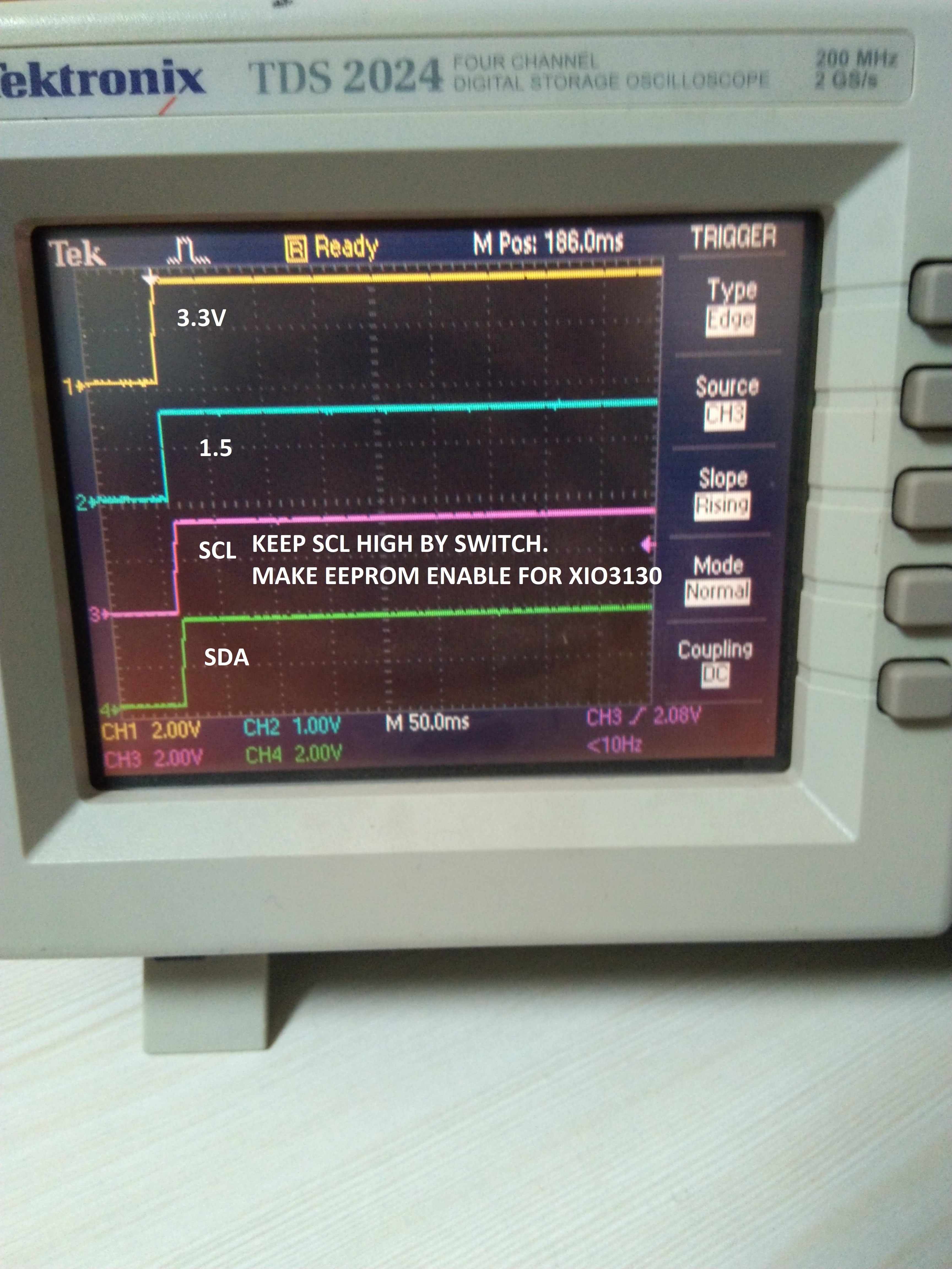

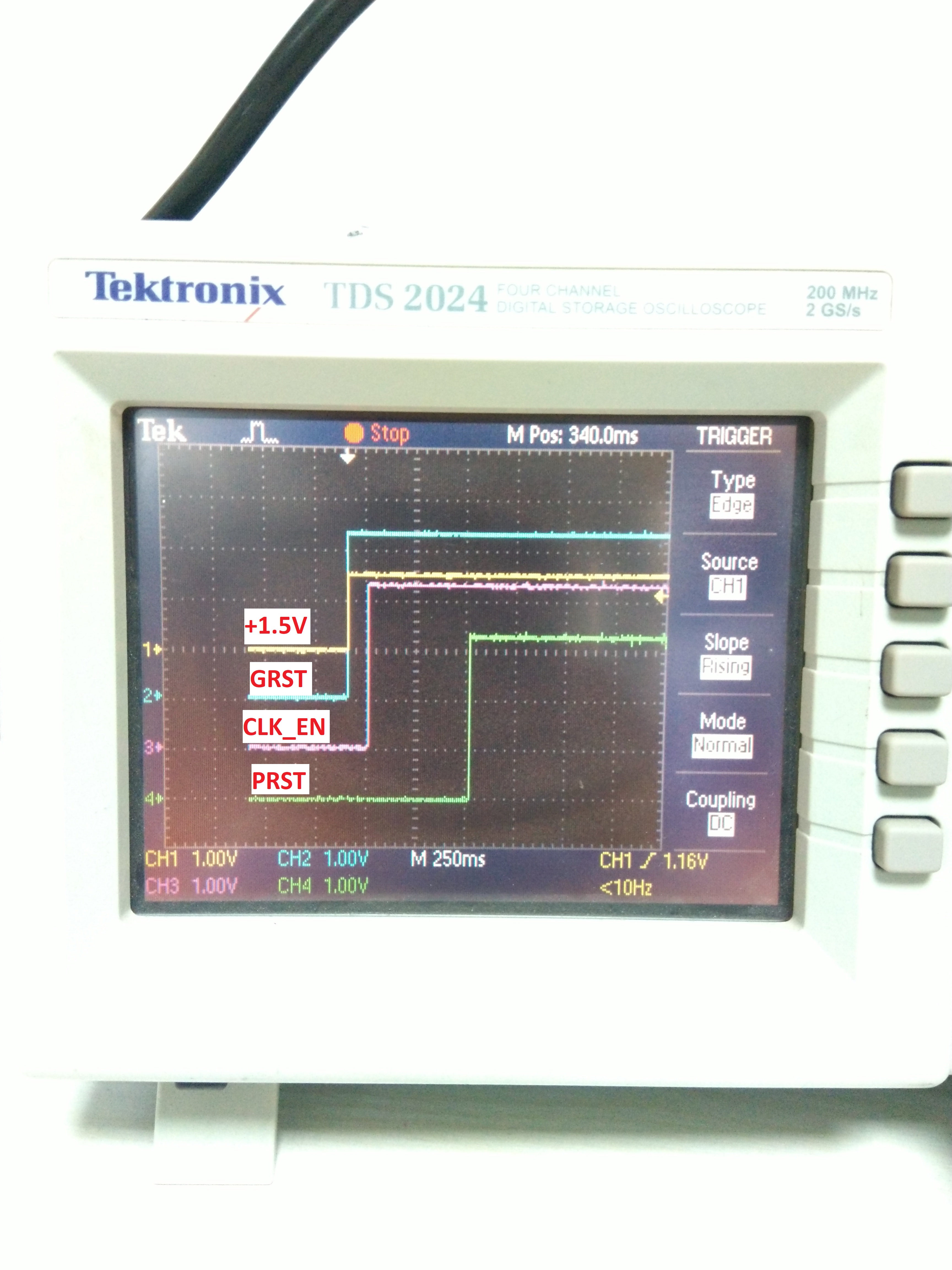

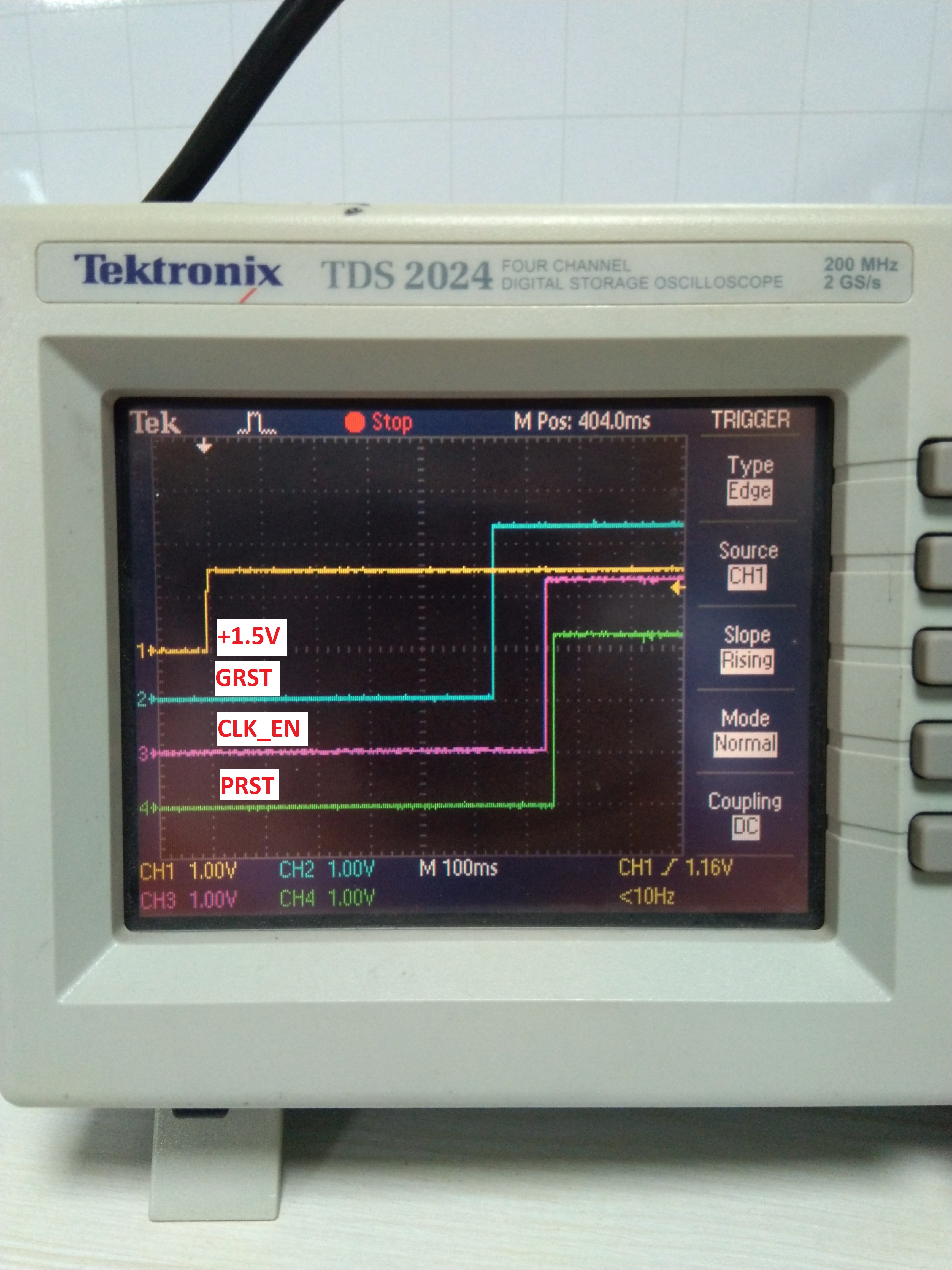

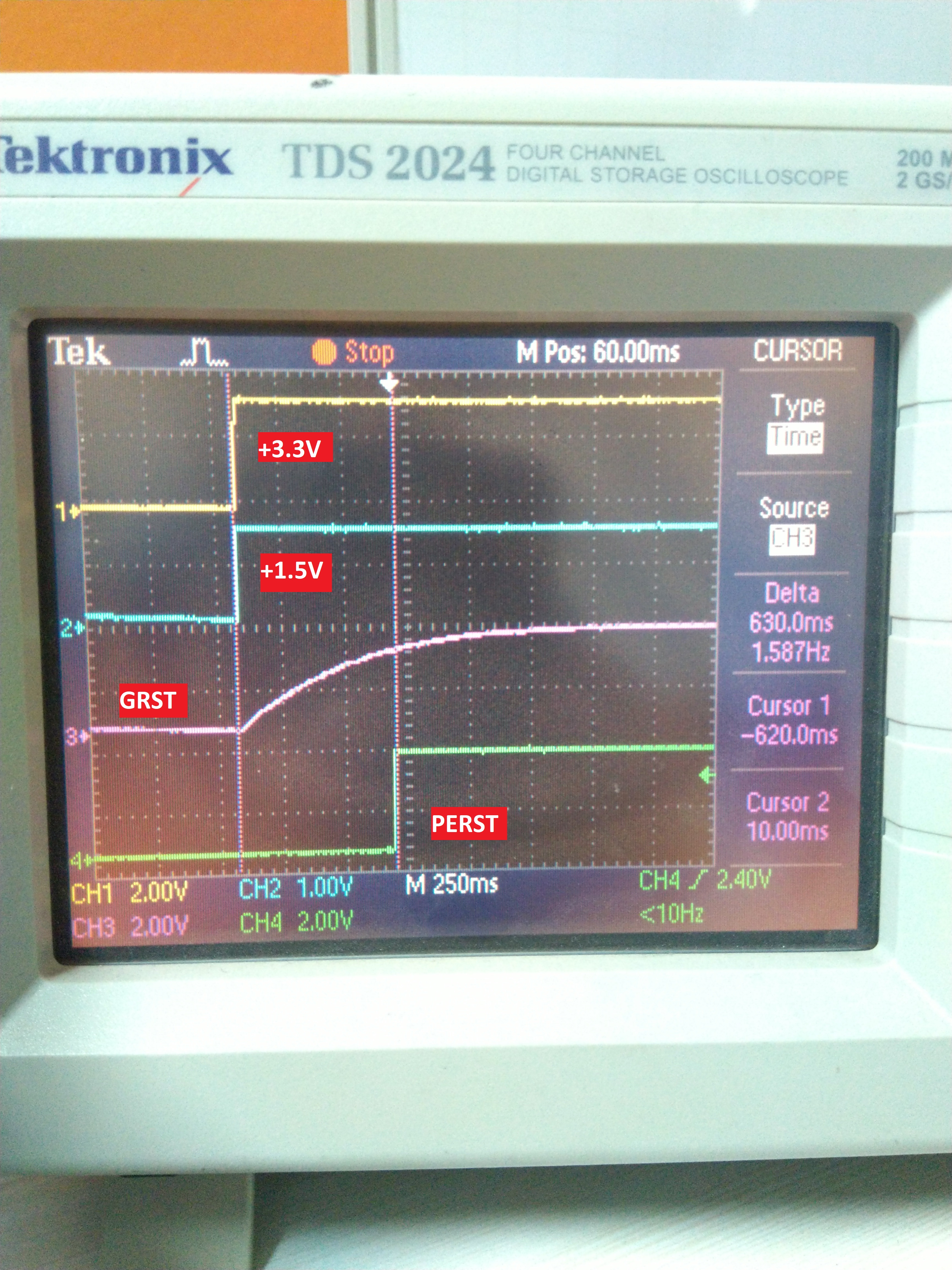

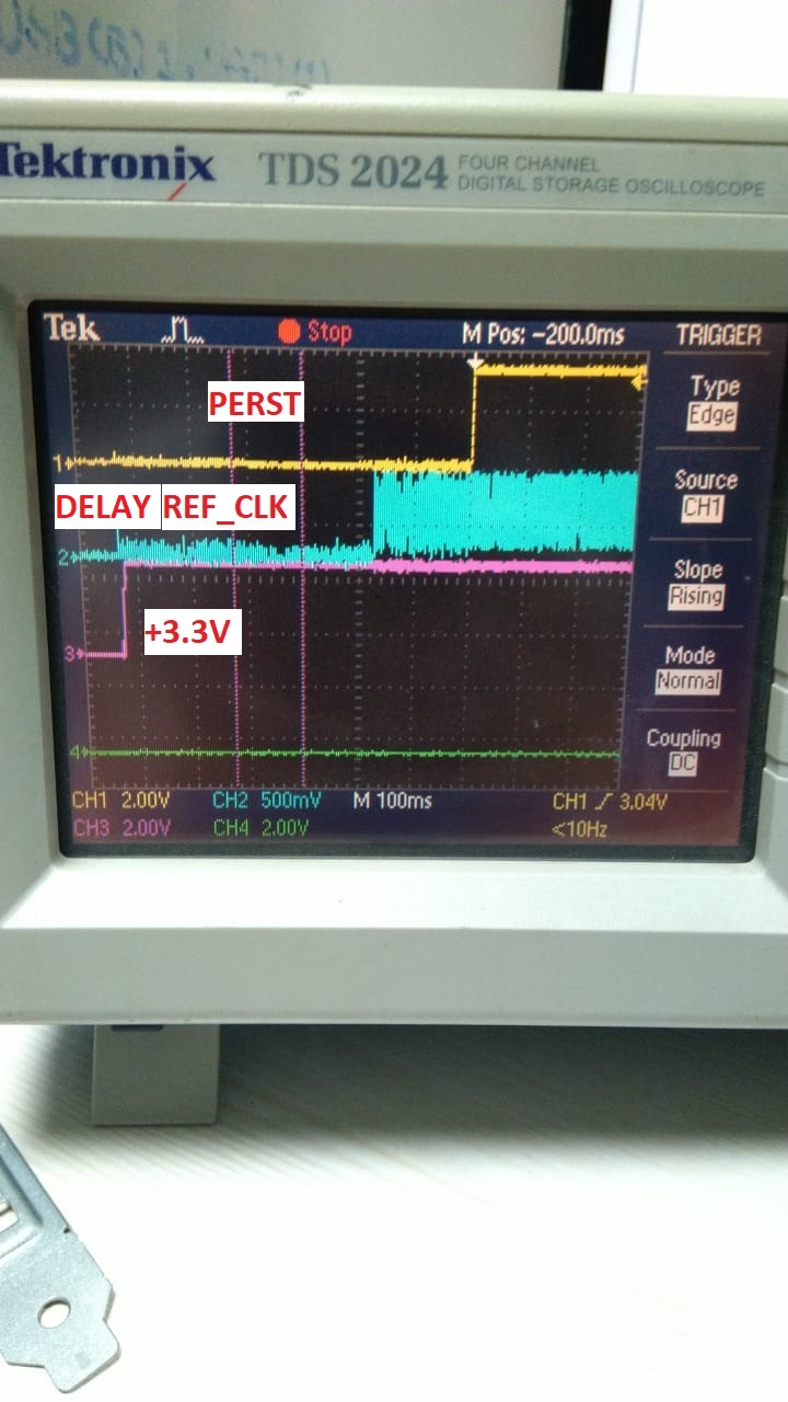

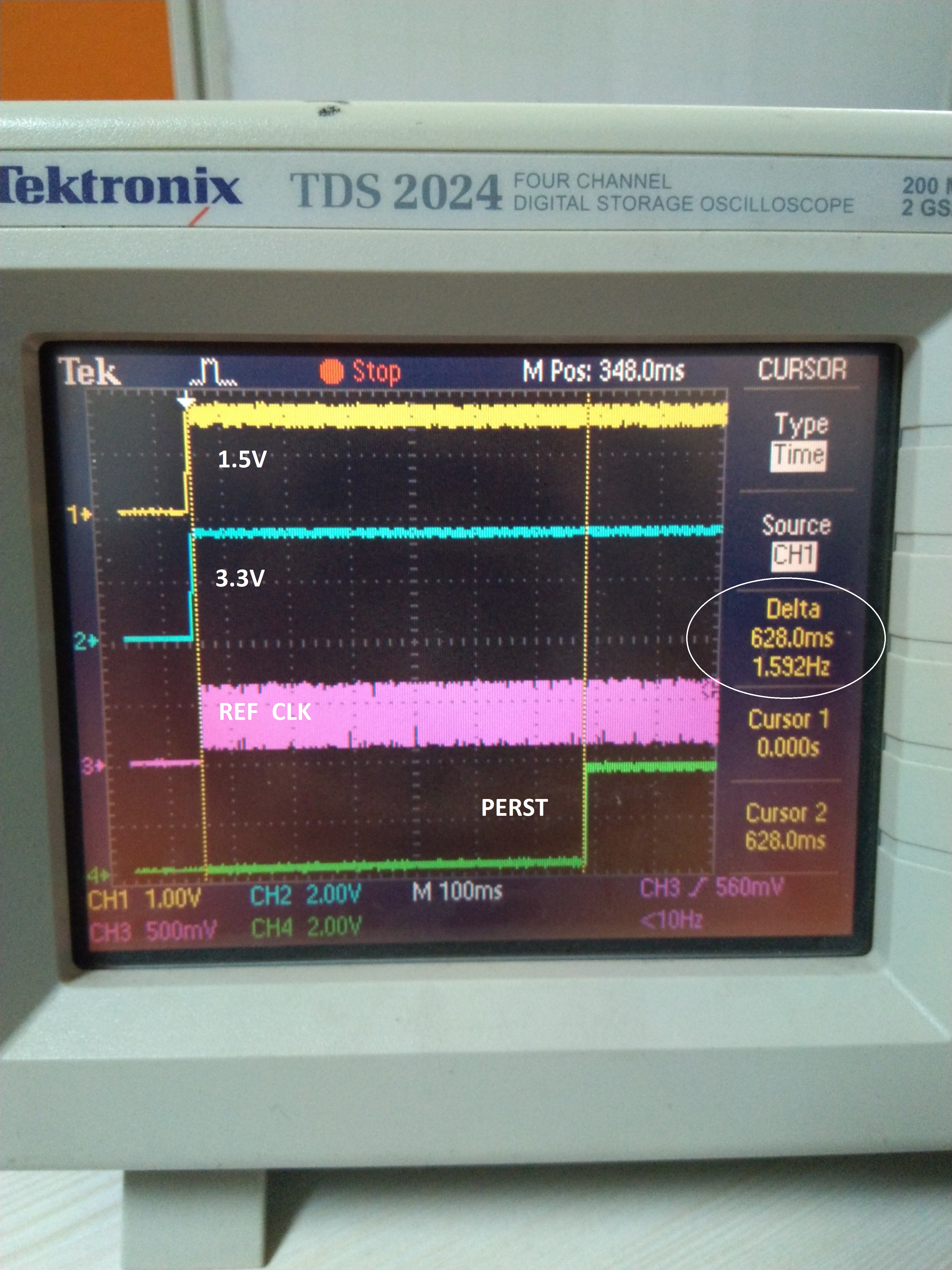

    I have attached the Images for the I2C and Power Up sequences in our Board as per your suggestion.
    Alpesh.
    Image-1: I2C_EEPROM_ENABLE.jpg
    Image-2: I2C_EEPROM_DISABLE.jpg
    Image-3: CLK TO RST_TIMING.jpg
    Image-4: VDD TO RST_TIMING.jpg

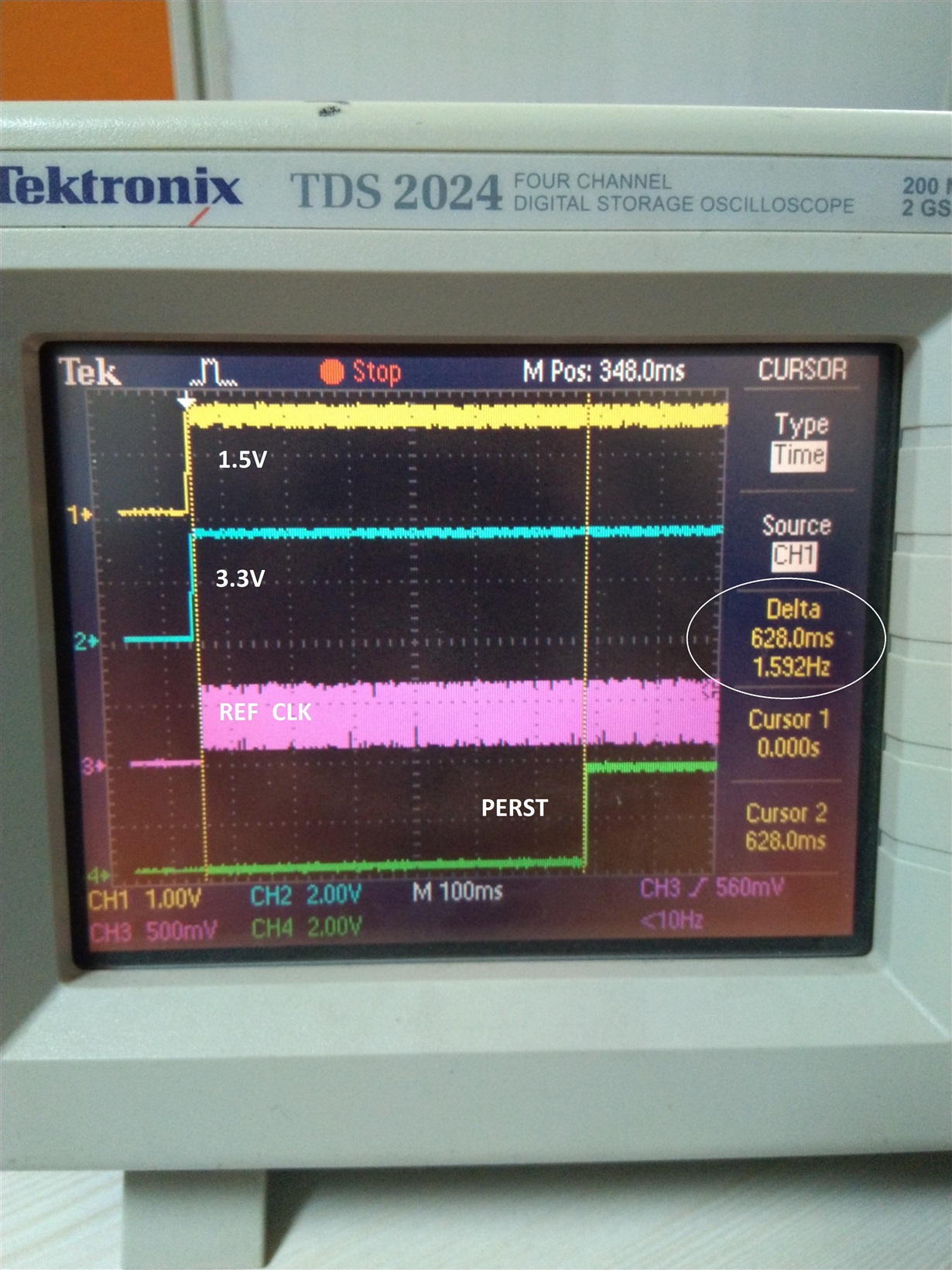

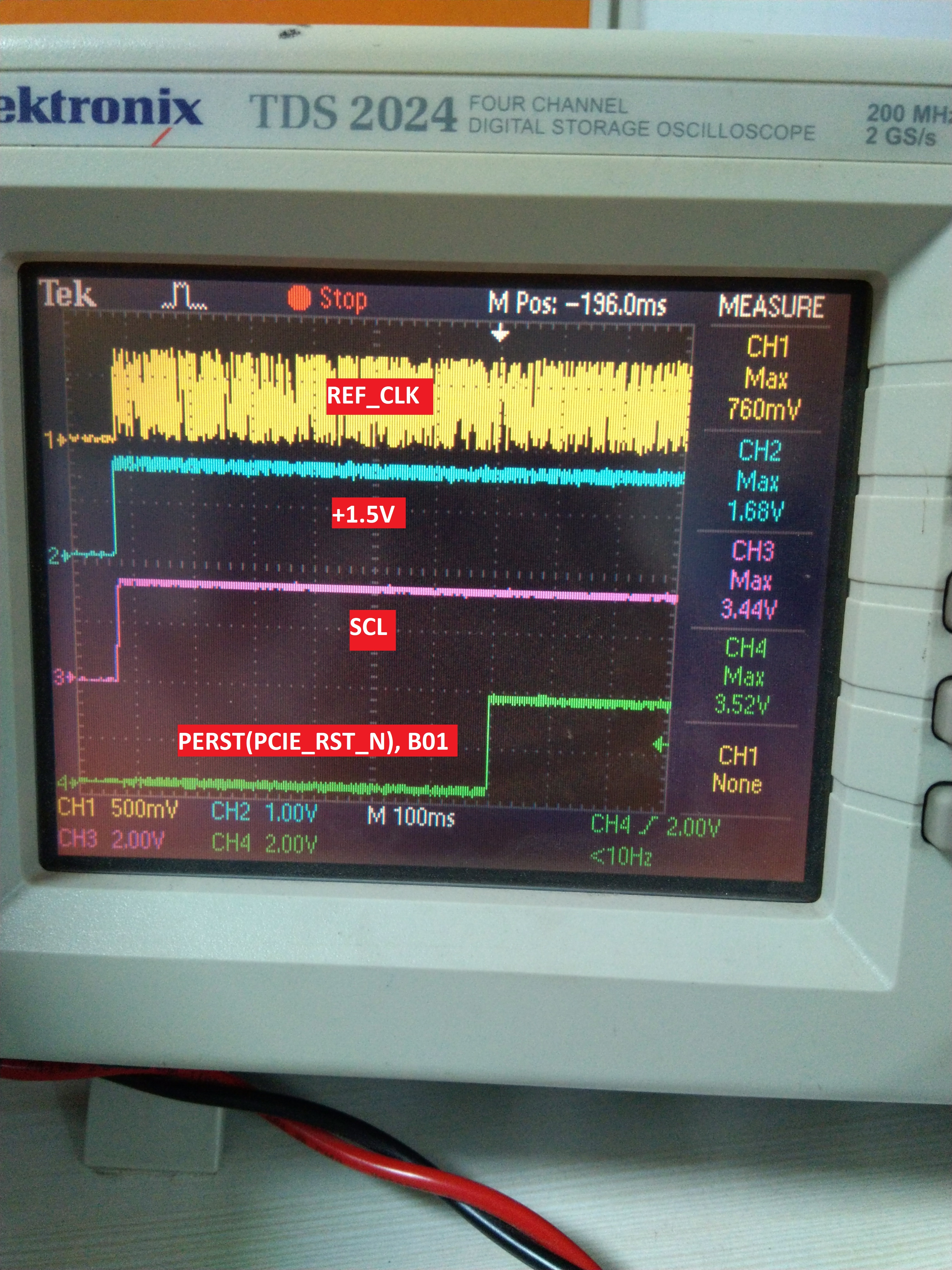

  • alpesh,
    Is there a PCB schematic that I could review for this application? Also I highly recommend a swap test in this case. Is GRST being asserted when power is stable?
  • Malik,
    Please provide your Professional Mail ID so I can share the Schematic. We will discuss the Schematic over there.
    I have no idea about the swap Test. Can you please guide me for that?
    We fix 4.7K  Pull up Resistor at GRST pin.

    What voltage is GRST pulled up to? We normally recommend to tie GRST to a "power good" signal for the 3.3 V or 1.5 V rails. (whichever comes up last)
  • Hi Malik,
    I have shared the schematic through E2E private message.
    Actually we have 7 Proto Board and all have same issue so I cannot perform the Swap Test.
    GRST is held Pull up with 3.3V now So shecked the voltage generated sequence and found that the +1.5V is generated Last then change the Pull Up from +3.3V to +1.5V but there is no change in result.

  • Alpesh,
    I have received your schematic and will get my notes to you (if any) by Friday afternoon.

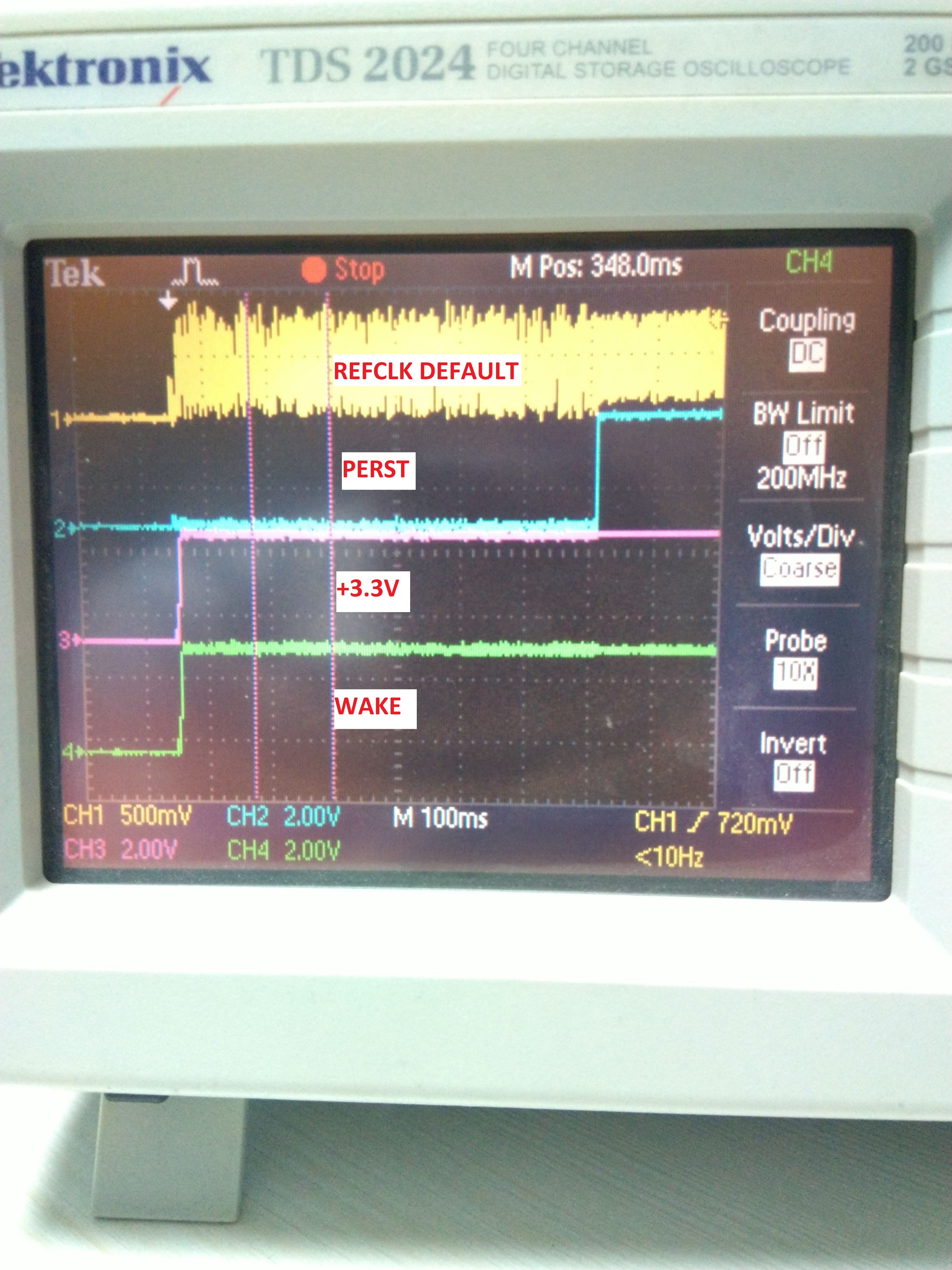

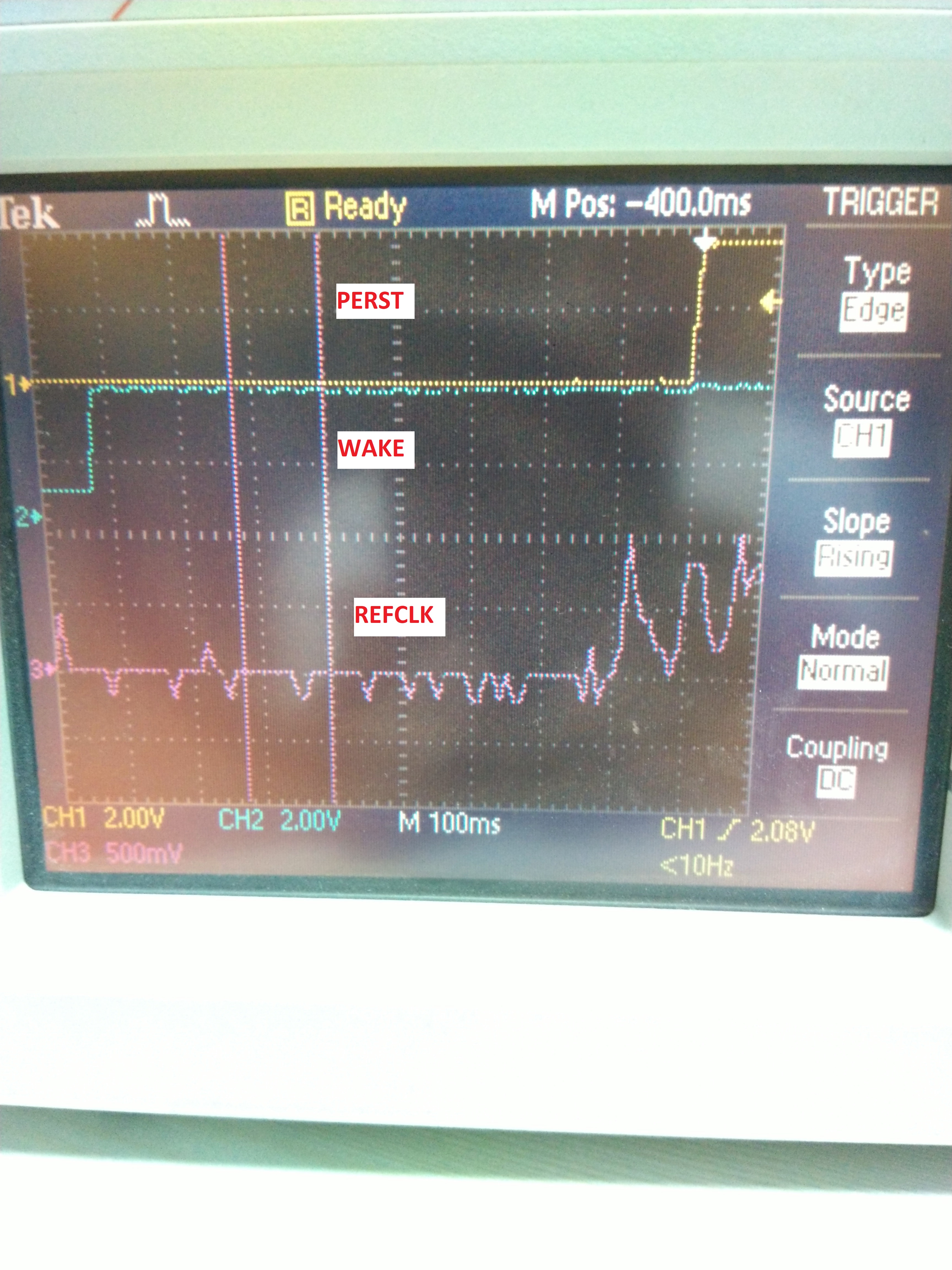

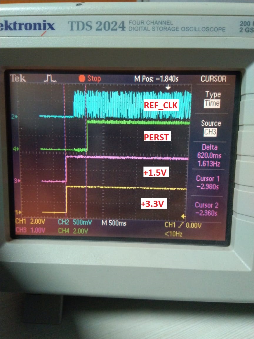

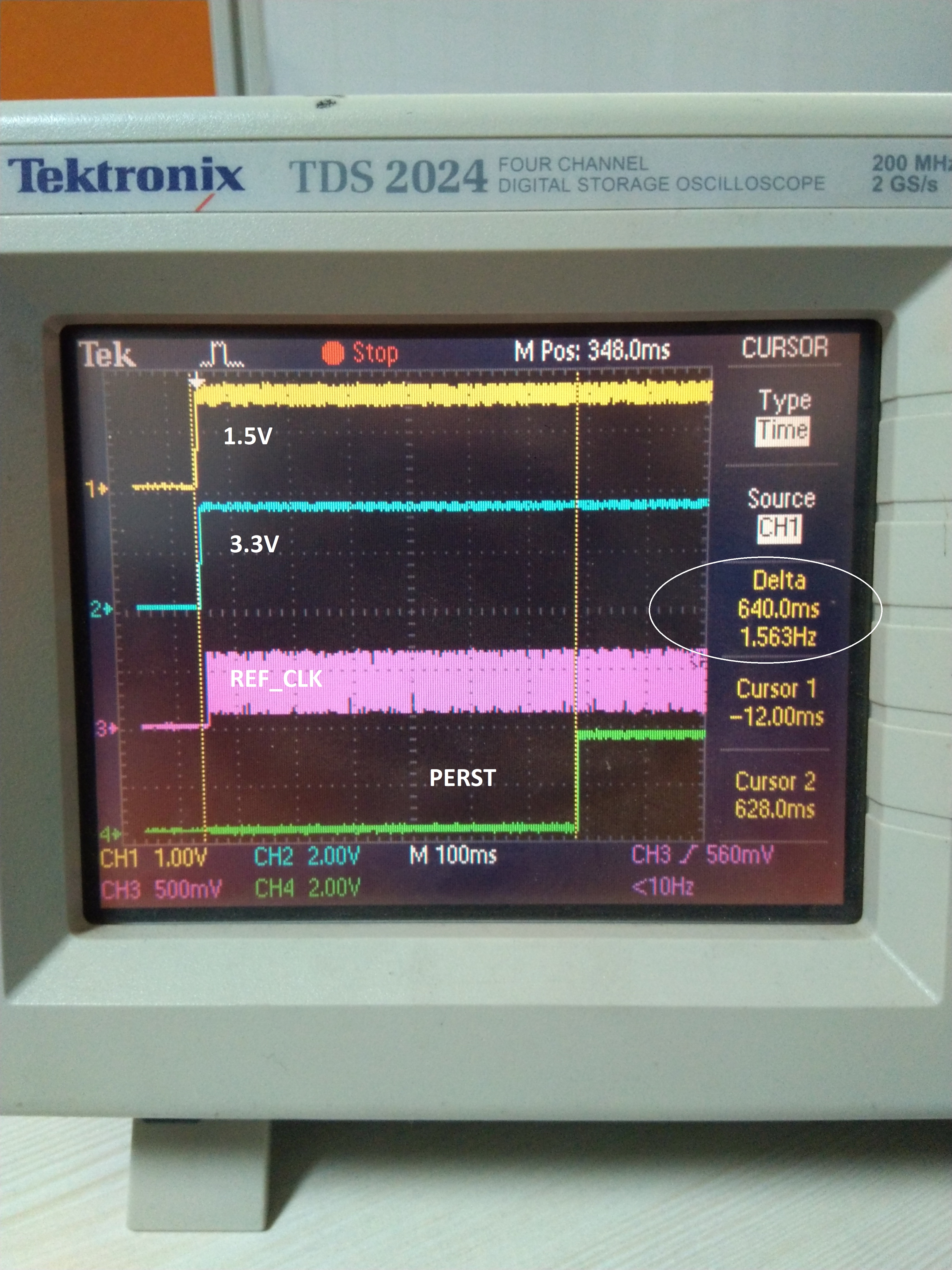

    Could you show SCL, PERST, REFCLK and 1.5 V on the same scope capture? Please include when PERST is de-asserted and 200 ms after this event.
  • Hi Malik,
    Thank you very much.
    Please find the attached Image as per your suggestion.
    Alpesh.
  • Hi Alpesh,
    I could not find any errors on my first pass through your schematic.
    My current suspicion is that XIO3130 is not coming out of reset correctly. This most likely has to do with the timing of GRST. Is it possible for you to monitor the current consumption of XIO3130 during your testing? If so, please measure I_1.5 or I_3.3 (current consumption from 1.5 V and 3.3 V rails respectively) to make sure they are at nominal values specified in 6.8 POWER CONSUMPTION of the data manual. Could you also try increasing the the delay between GRST and when power becomes stable? Try values greater than 10ms. See if this affects the current consumption of the device or your ability to read the EEPROM/Detect the XIO3130.

    1. Actually +1.5V and +3.3V are connected to Power Plane. So, we cannot measure the individual Current but we have measured the Total Input Power and Current which is mentioned below:
      1.     +24V@340mA is the constant current for the Design.
    2. We had Try to Increase the Delay in GRST by Hardware (RC), there is already 4.7K Pullup on GRST so we add the 100uF Capacitor from GRST to GND. I have attached the Images for the results.

    EEPROM: Invalid ID (ff ff ff ff)
    PCIe1: Root Complex of mini PCIe SLOT, x1 gen1, regs @ 0xffe0a000
      01:00.0     - 104c:8232 - Bridge device
       02:00.0    - 104c:8233 - Bridge device
       02:01.0    - 104c:8233 - Bridge device
       02:02.0    - 104c:8233 - Bridge device
    PCIe1: Bus 00 - 05
    [initial_xio3103]-0 Read Register [0xB3]=0x00
    [initial_xio3103]-0 update Register [0xB3] to 0x08
    [initial_xio3103]-0 Read Register again [0xB3]=0x00

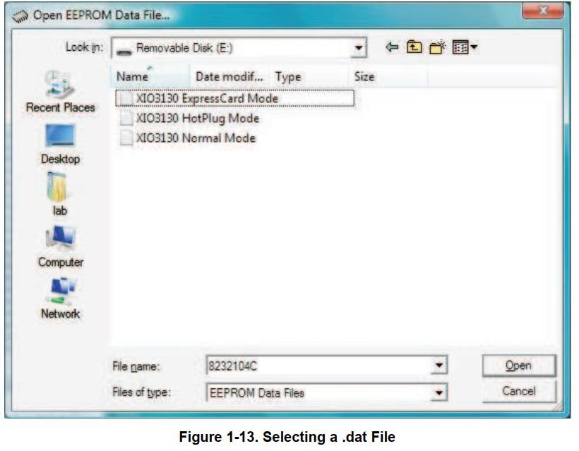

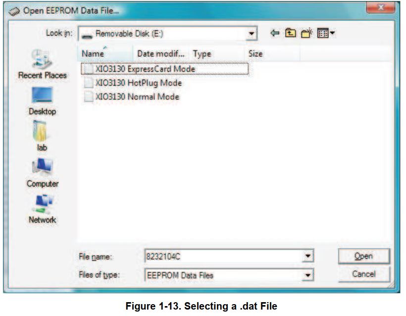

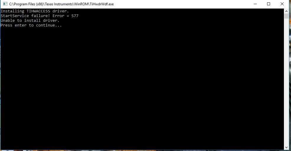

    We got Two new Assembled Proto Board. Can you Guide us How to Program XIO3130 and  External EEPROM?
    This Two Boards are totally Blank without any code in them. So we need to start from Fresh to get the proper configuration.
    If any Software need to program the ICs (XIO3130 & EEPROM), Kindly share the Software with us.
    Waiting for your Reply.
    Alpesh.

  • Alpesh,
    XIO3130 does not require programming for basic functionality. Advanced features disabled by default and do not require configuration register initialization for basic operation. However, to fully utilize advanced features within the XIO3130, custom software is required. Additional configurations are uploaded via EEPROM and following Table 3-3. EEPROM Register Loading Map in datasheet would be the best way configure EEPROM for advance settings of XIO3130. Does this answer your question?

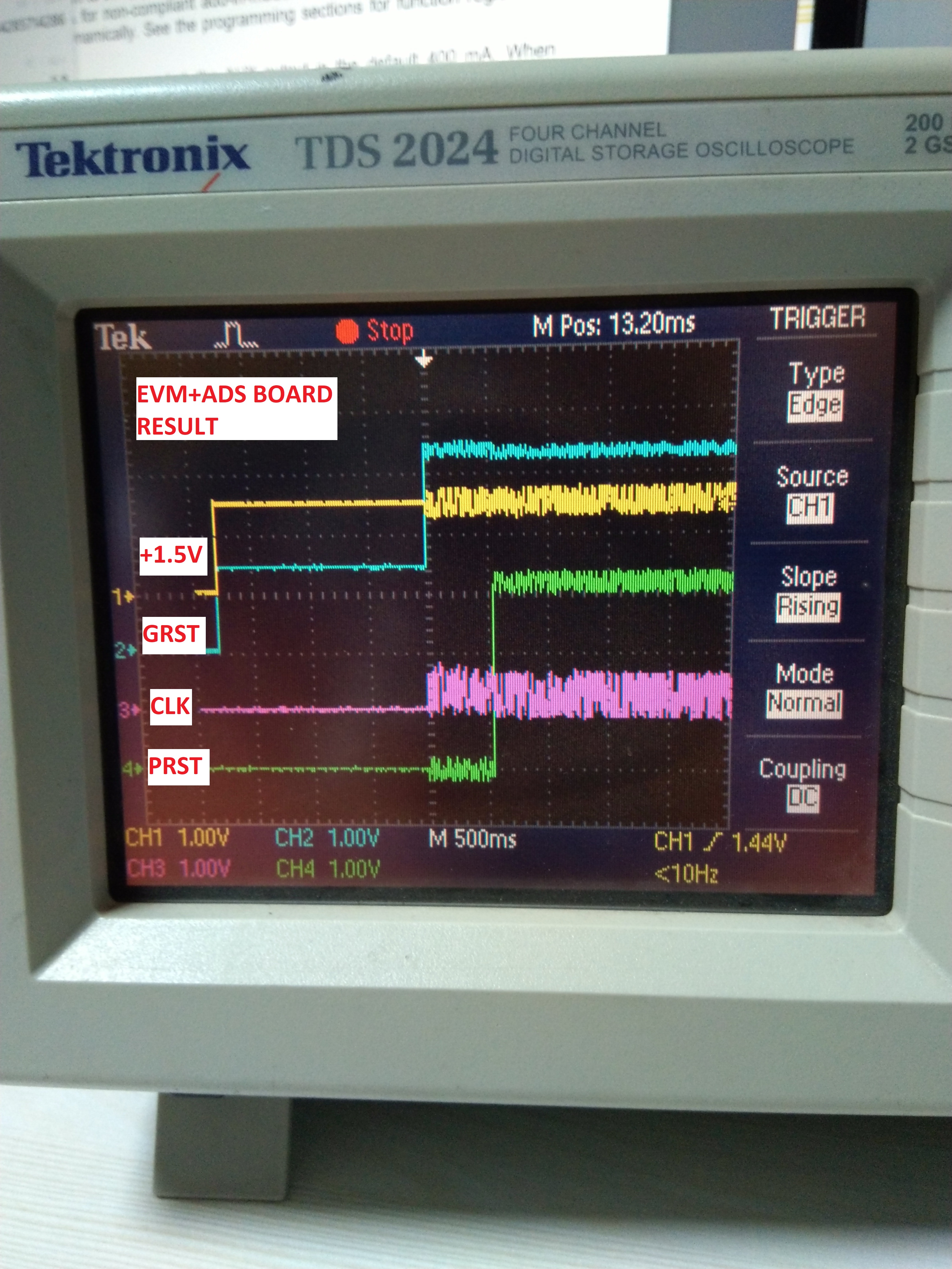

    Is there any observation on post Feb 7, 2019 11:40 PM. of GRST and PRST Signals?
    We have powered the XIO3130 EVM Board and observed that the SCL and SDA signals are pull High with 3.3V. Right now we operate XIO3130 in Normal Mode.
    Below are our finds:-
    • We need to know that onboard EEPROM is come with pre-loaded data -or- NOT?
    • If NOT than How we can write Data into EEPROM ? Any specific software is available for writing to on board EEPROM included with XIO3130 Development Board.
    • As per Our research, WINROM is the software for EEPROM but we can not find that software anywhere/opensource.
    • Please find an attached User Guide for XIO3130, refer Page-10 where you can find the file for EEPROM, where we can get those files.
    • For our development, we need those files and software to write into EEPROM and validate same.
    Alpesh.XIO3130 EVM User’s Guide.pdf

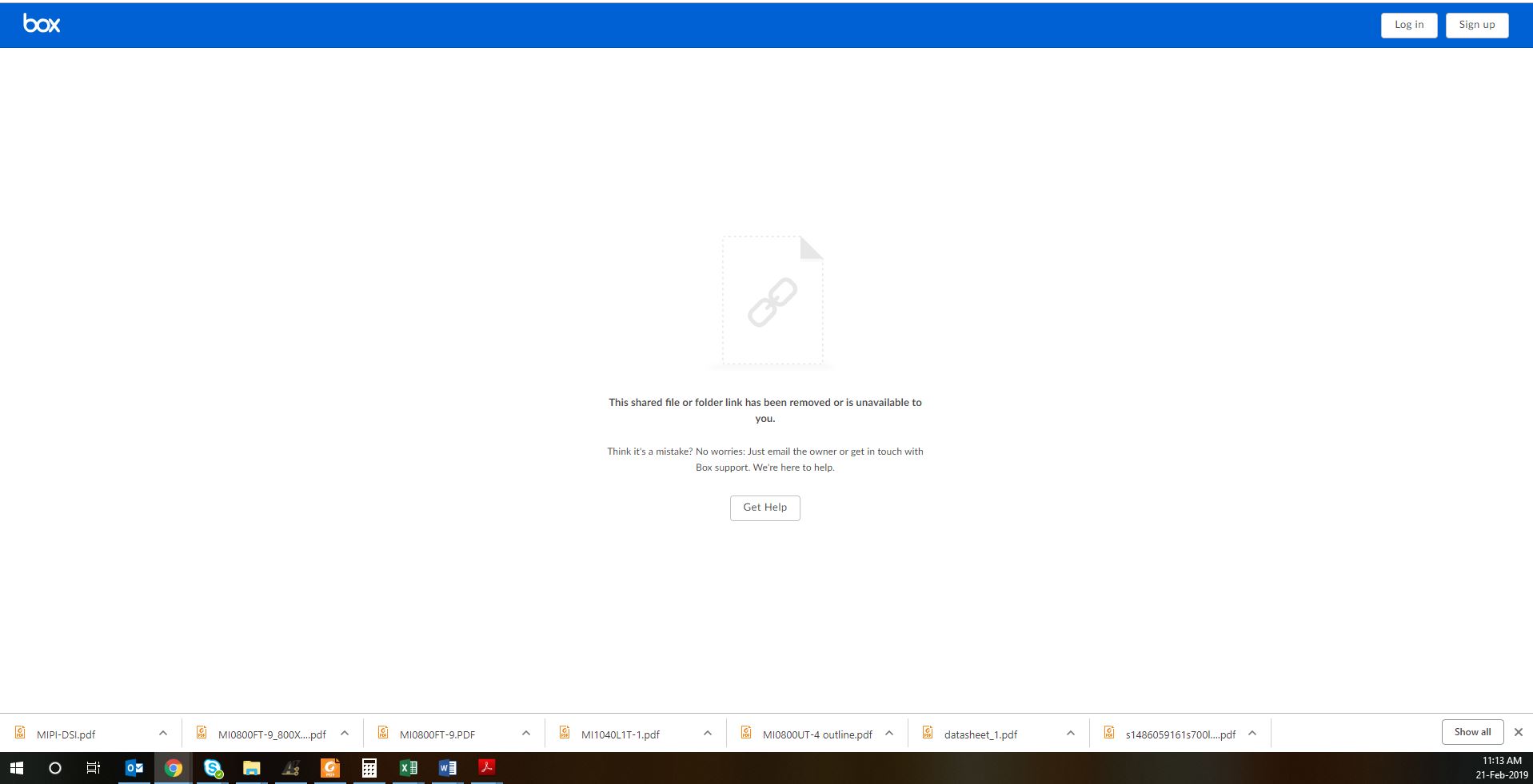

  • Hi alpesh,
    You can download the WinROM files here: txn.box.com/.../2o4xhc7nncogbsath1kitqlk17h468z9
    I.K.
  • Hi I.K.,
    Thanks for the Reply, But the link which you provided is not working.
    Please check the Attachment for your reference.
    Kindly share the active link for the download the winrom.
    Alpesh.

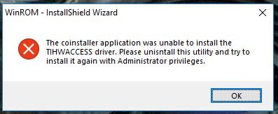

  • Hi I.K.,
    Thanks for the Reply.
    I have tried with WINROM_3.0 as per your last link.
    Sorry but we are not able to install WINROM software. Also we tried reversed  OS Compatibility like XP(SP-2 & 3), Vista, Windows7 & 10 but no luck on any of them.
    Please find the below Images for your reference.
    Waiting for your earliest response.
    Alpesh.
  • Hi alpesh,
    My suggestion would be try updating your drivers or running the installation as administrator. Also, try installing the TopHat software included in the folder to see if that makes a difference.
    This tool is quite old and is not really supported anymore (we only provide it upon request) so unfortunately there's little we can do to help with installation issues.
    I.K.

  • Hi alpesh,
    1. The EEPROM is pre-configured for normal-mode operation (ie a generic PCIe switch).
    2. I'm attaching these files here for you to download:
    /cfs-file/__key/communityserver-discussions-components-files/138/XIO3130_5F00_dat_5F00_files.zip
    3. The latest procedure is the implementation guide: http://www.ti.com/lit/an/slla295a/slla295a.pdf and EVM user manual: http://www.ti.com/lit/ug/sllu108/sllu108.pdf
    You can also reference Table 3-3 in the datasheet for suggested programming values for the EEPROM.
    I.K.

  • Hi I.K.,
    We keep the SCL High, Load the EEPROM with Express Card Mode code and set Dip Switch for Express Card Mode.
    As per your suggestion, we add some delay in REF_CLK but there is no any progress.
    Please find the attached Image for your reference.
    Does we have anything for read/write on EEPROM of EVM XIO3130? Which we can compare with our board result.
    Alpesh

  • Hi alpesh,
    I use a program called "RWEverything" (you can find a download through Google) to verify functionality of the EVM. When configured in normal mode operation, the XIO3130 should show up as three "Texas Instruments PCI-to-PCI Bridge" devices when plugged into a PCIe slot on the computer:
    I.K.
  • Hi alpesh,
    Are you able to replicate my above post with the EVM on your system? The above is what you should see when the EVM is configured for normal mode operation, and is what I see in our lab.
    I.K.
  • Hi I.K.,
    Sorry for the late response as we faced issue with detection of EVM in PC so make changes in BIOS and resolve it.
    Now we get the same result as you mentioned. I have attached the Image for the same for your reference.
    I have also check the Signals between EVM and PC Mother board (PERST, REFCLK, WAKE). In which the sequence is like that : Wake(High) -700ms REFCLK - 100ms PERST(High).
    Also check the same signal in our board and the sequence is like that : Wake (High) - same time REFCLK - 650ms PERST(High).
    Then make modification in CLOCK DRIVER and added delay in REFCLK using ARDUINO. Now the Sequence is like that :-  Wake(High) - 450ms REFCLK - 170ms PERST)High).
    Still there is no changes in Result and we are not able to detect the XIO3130 Switch.
    In EVM and Our Board, We keep the EEPROM in Normal Mode by Dip Switch and also Program EEPROM in Normal Mode.
    I have attached the Images for each iteration here for your reference.
    Note:- When EVM is connected to PC, Keep PC OFF then Supply +5V Externally to EVM and then Turn ON the PC to detect EVM. Without External (Delayed-After PC ON) Power Supply, EVM is not detecting by PC.
    Alpesh.
  • Hi alpesh,
    External power should be supplied to the EVM before the PC is turned on so that the datasheet power sequence is obeyed, so I believe that's expected behavior.
    In regards to the rest of your post, are you saying that you can see the XIO3130 in the RWeverything program on our EVM, but not on your own board? If this is the case I wonder if there's just an issue with the units you have on your boards. Would it be possible to swap the unit on the EVM with the unit on your board to see if the EVM starts showing issues and also to see if your board starts working correctly?
    I.K.

    Observation:-
    In EVM, WAKE UP signal is going to Down stream port and Master where as in our board it is going to Down stream only. Is it required to connect with Master as it is Pull High signal?
    Waiting for your reply.
    Alpesh.
  • Hi alpesh,
    I have already received your schematic from Malik. So far it looks okay but I will continue to review it and let you know if I have any comments. Since you are able to get the EVM to work correctly I believe the issue is with either your board or with the units on your board.
    For the WAKE# signal, please reference section 3.8 of the implantation guide (www.ti.com/.../slla295a.pdf) for information about this signal. I believe it depends on your implementation.
    I.K.

  • Hello I.K.,
    We have successfully performed swap Test but the result is same.
    Our Observation:-
    • We tried to follow up Power Sequence as per XIO2001 but didn’t get succeed result.
    • We are able to get the timing between 1.5V Power, GRST and CLKEN but not able to get PRST timing as that signal is controlling internally from Processor.
    • If we changing the timing span of GRST and CLKEN towards to PRST signal than we are able to get those timing, but 1.5V Power timing is more than mentioned in Datasheet. We observe in log that PCIE is Disable. Kindly Provide your thoughts.
    • As per XIO2001 datasheet, minimum timing requirement for PRST is 100mS after Power On, but more timing may be not an issue. Currently we are getting around 500mS on Scope, but still we are not succeed. Is is OK to have more than 100mS?
    EVM Observation:-
    • We have connected EVM-XIO3130 with Proto-Board and it can read EEPROM from EVM and Proto-Board can detect XIO3130 as PCIE switch. For timing, Please refer Image - EVM+ProtoBoard.jpg.
    Kindly Provide your feedback.
    Alpesh.
  • Hi alpesh,
    Is the 3.3V timing also correct for the power up sequence? In the 2nd scope screenshot there should also be at least a 100us delay between the REFCLK and PERST#. Also, it should be okay for PRST to de-assert after 500ms.
    Additionally, per the email discussion, have you tried switching the position of the AC coupling caps on the TX/RX pins on the upstream/downstream ports on your board?
    I.k.
  • Hello I.K.,
    • +3.3V and +1.5V are generating at same time as they are using common input supply, we have already verify on scope.
    • In second screen shot, each block is 100mS so REF_CLK and PRST is approximately 20mS.
    • Thanks for conforming PRST Timing.
    • For UP STREAM, AC Coupling Caps are on right Place (Near to the TX side of each Device).
    • For DOWN STREAM, We will change AC Coupling Caps for TX Line and Keep you Update.
    Meanwhile if you find anything, Please keep us posted to moving forward.
    Alpesh.
