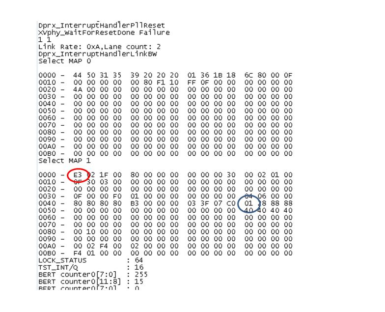

SN65DP159: SN65DP159 issue with Xilinx IP Core DisplayPort RX Subsystem v2.1 on FPGA Kintex-7
Part Number: SN65DP159
Other Parts Discussed in Thread: TMDS181

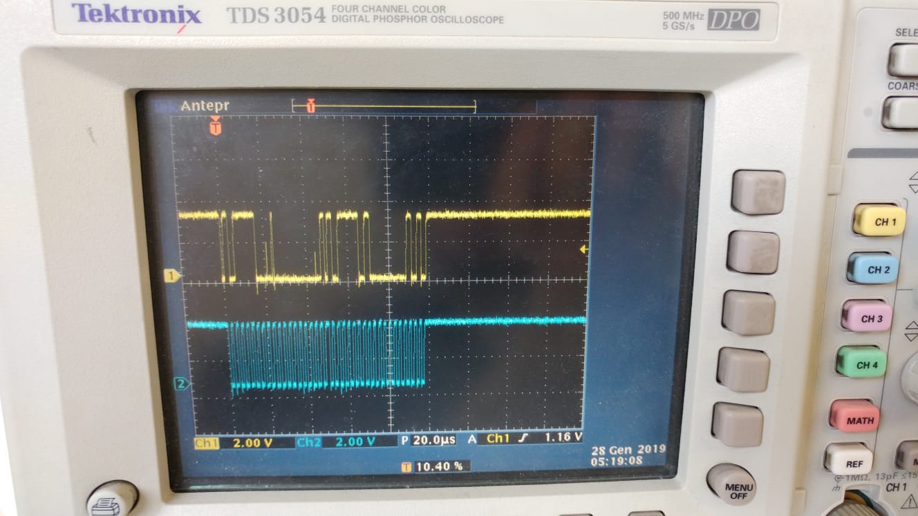

we are trying to integrate in our FPGA kintex-7 XC7K70T-1 the Xilinx DisplayPort RX Subsystem v2.1 to receive a  DP1.2 flow. (our application requires to send the flow to two MiniDisplays).
We need to use 4 lanes @5.4Gbps each.
We have designed the board from scratch, and we mounted the needed SN65DP159 following the SLLA358 application note .
But we are facing lots of issues:
1) with one board (in the following the SN02board) we are able to negotiate the DP link but with some limitations:
a) never at the maximum needed value 5.4Gbps
b) most of the time setting 2.7Gbps, connecting to a Windows 7 Dell laptop with DisplayPort on docking station; and when the link is correctly negotiated it works very well, very stable.
c) never connecting to a test pc with a NVIDIA GPU with native DisplayPort output
2) with the second board (in the following the SN04 board)
a) never, at neither 5.4Gbps or 2.7Gbps or lower
b) same situation connecting to Laptop or test pc.

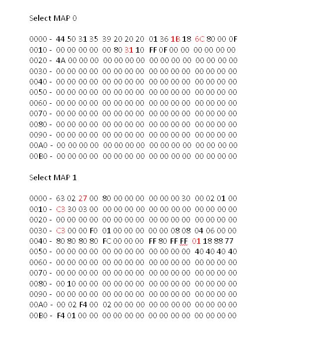

With both the SN02/SN04  boards when the link is not working we used the diagnostic command XDpRxSs_ReportDp159BitErrCount from Xilinx driver (it reads the retimer registers)
and we have seen that there are errors at the Retimer inputs (while no errors are traced when the link is established, and in fact the ink is very stable). Please check attached logs , obtained setting to 2.7Gbps to have also a  working situation (both the logs are related to the SN02, nut the SN04 not ok is identical to the SN02 one).
Can someone support us?

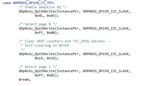

Could some retimer configuration values be incorrect? we have followed the configuration suggested within the Xilinx reference design
What could we investigate on?

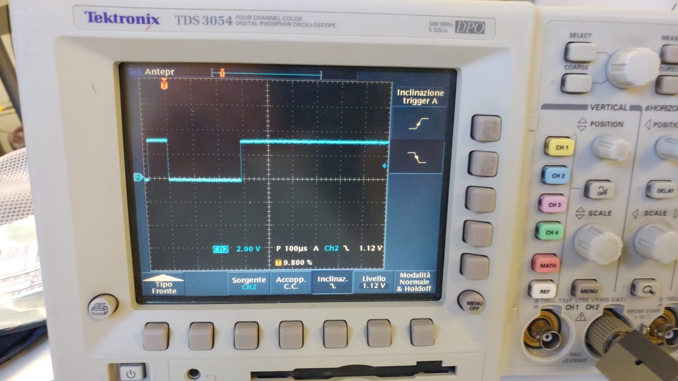

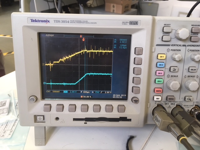

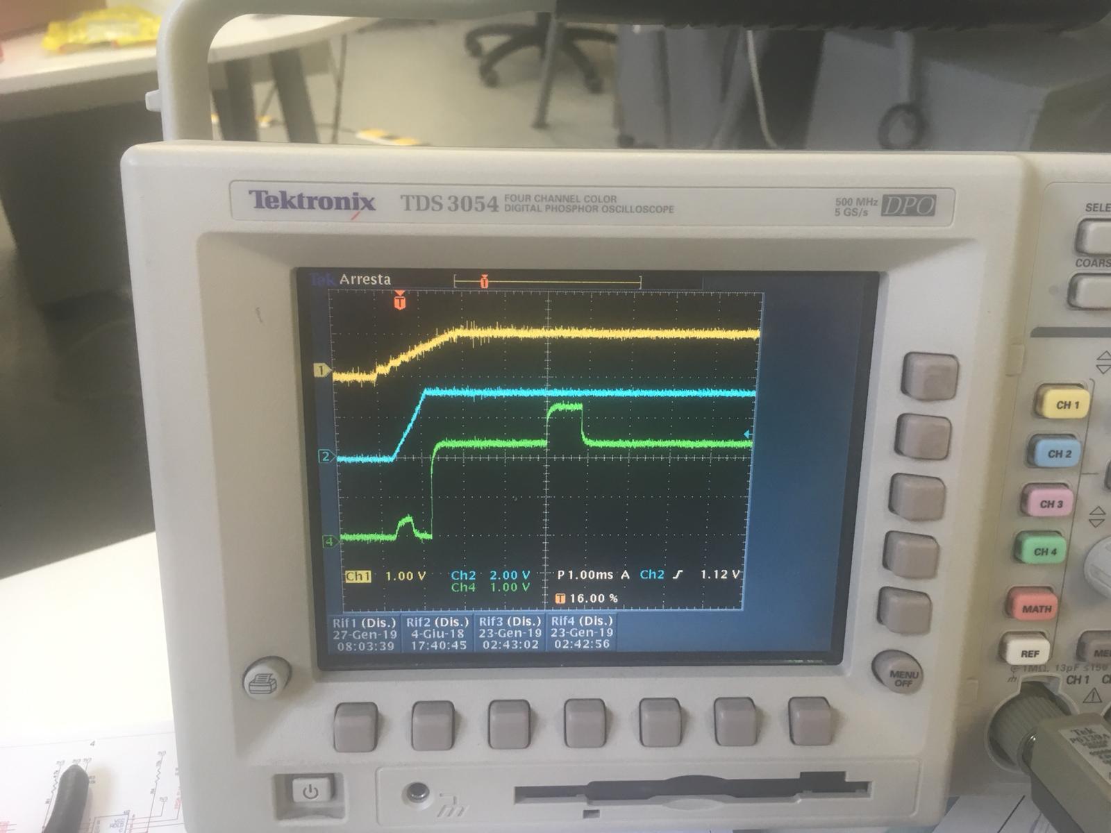

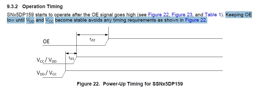

We are suspecting an issue with the retimer reset: in fact it seems that when the SN02 is correctly working, the link proceeds in working correctly if we reprogram the FPGA, even if we do this action many times. On the contrary if we power cycle the board, sometimes the link is ok and sometimes not.
Thanks a lot in advance. We are in a big hurry due to a pressing schedule
Bye
Giovanna

    Blue is 3V3
    Yellow is 1V1
    Green is OE
    We discovered that  we had a missing resistor on the OE signal of the retimer.
    After soldering the resistor the situation changed, as you can see in the picture below.
    Do you think that it should work (better) now?
    Giovanna

  • Hello Nicholaus,
    the first photo is related to the incorrect situation, without the pull down resistor (the designer forgot it).
    In the second photo (with resistor)the transition you are seeing in the OE is not intended to be a reset. It is a sort of spike, an undesired disturb whose origin is not clear to us.
    BTW since it does not reach 0.8V we expect this does not disturb. Are we right?

  • Hello Nicholaus (and David, and anyone who'd like to help).
    I'd like to recap the current situation.
    1) SN04 now works as SN02 (i.e. sometimes ok and sometimes not ok). To have this improvement we have "played on HW" to modify the relationship between 3V3 and 1V1
    2) as you know we have added on one board (SN04 in particular)  a resistor to pull down the OE. This modification unluckily  has not improved the situation. We have also enforced our reset cycle we provide via FPGA (check below picture) to have the OE down for 100 usec before going up as written in the datasheet,  but no improvement.
    Honestly we expected that the pull down should help also based on the datasheet where we find:
    From this paragraph we understand that, if OE is low until Vdd and  Vcc are stable, the special timing relationship described in fig 22  are no more needed.  is this understanding correct?
    If yes, the resistor should solve the issues with OE ...am  I right?

  • Giovanna
    VCC can be powered up before VDD or VDD can be powered up before VCC, the important thing is for OE to be hold low until both VCC and VDD are stable, and then drive OE high.
    You can drive OE pin with an external circuit or have an external capacitor on the OE pin (the internal pullup and external capacitor create the RC time constant delay). Can you do another scope capture showing the VCC, VDD and OE power up sequence between the passing and failing case?
    Can you also please send me the DP159 register dump, include page 1 between passing and failing case?
    David
  • Hi Giovanna,
    I am working with David to get this resolved.  The code that you suggested was not what I had in mind.  I do not have the Xilinx reference design, but I believe the filename has the text "DP159" in it.  It has the DP159's initial configuration, TP1, and TP23 handlers in it.  It's described on page 54 of the Xilinx DisplayPort RX Subsystem v2.1 Product Guide. Search for the project for the text "TP1" and you should be able to find it.
    "Determine the PLL lock of DP159. If achieved, change PLL mode based on the lane rate. Continue programming, after the DP159 PLL lock."
    Let me know if you need more direction.
    This is also where you could add the register dump, as David suggested, to report all the values of the DP159 registers in the TP3 stage.
  • Hello guys,
    thanks for supporting us.
    Is the part of the code you intend to modify the following one?
    Function XDpRxSs_Dp159Config of source file xdprxss_dp159,.c:
    /* Wait for PLL lock */
    while ((ReadBuf == 0) && (Counter <
    XDPRXSS_DP159_LOCK_WAIT)) {
    XDpRxSs_Dp159Read(InstancePtr,
    XDPRXSS_DP159_IIC_SLAVE, 0x00, &ReadBuf);
    ReadBuf &= 0x40; /* Lock status. */
    Counter++;
    We've found a loop for PLL lock and XDPRXSS_DP159_LOCK_WAIT is set to 512. Should we change this value as per your suggestion, trying lower values? (8-16-32??)
    Anyway based on the code even if the PLL lock is not reached, the code execution proceed when the counter reaches the desired value in the loop .....
    Unluckily the Xilinx debugging functions does not work and we are not able to check the Counter value when we exit the loop(BTW we know that the debugging functions have to be removed, as per your suggestions)

    We will provide the complete register dump.
    Cheers
    Giovanna

  • Hello David,
    first of all we have a news about the issue 5 (not working P2000 Quadro Invidia graphic card): with linux os and drivers DP link works. It works with the instabilities noticed on the other graphic cards but ...well...at least it works.
    Regarding the instabilities:
    based on your reply we understand that if we keep OE low with the pull-down we are fulfilling the design requirements on this point, am I right?
    Anyway the resistor has not solved the instability issue ...
    Please check below the requested signals at power up :
    first image is in a working case.
    Blue is 3V3
    Yellow is 1V1
    Violet is OE
    The second image is a  not working case.
    Blue is 3V3
    Yellow is 1V1
    Green is OE
    (Please notice that the unwanted transition on OE signal is present also in the first image even if it does not seem)
    Anyway while doing these trials we noticed that the power chip was not constrained (by mistake) . It can be fixed to provide a 2/4/8 msec ramp signal. But surprisingly we noticed that by fixing any of these values the DP link does not work at all! We expected instead to have the good behaviour by fixing the 8msec value.
    We are trying to provide the register dump ...we have faced another issue and unluckily I still do not have them.
    BTW if you have any comment or suggestions about the below descripted behaviour, we'll greatly appreciate.
    Cheers
    Giovanna
  • log_pn2_dp159dump_ok.txt
    Successfully ran Spi polled Example
    XCLR to low
    === Initializing ===
    XCLR to high
    === PS0 ===
                DisplayPort Pass Through Demonstration
                       (c) 2015 by Xilinx
                       System Configuration:
    = XDpRxSs_ReportCoreInfo =
    DisplayPort RX Subsystem info:
    DisplayPort Receiver(DPRX):Yes
    IIC:Yes
    Audio enabled:No
    Max supported audio channels:2
    Max supported bits per color:8
    Supported color format:0
    HDCP enabled:No
    Max supported lane count:4
    Max supported link rate:20
    Multi-Stream Transport mode:No (SST)
    Max number of supported streams:1
    DP RX Subsystem is running in: SST with streams 1
    System capabilities set to: LineRate A, LaneCount 4
    **************************r*****************************************
    In this configuration the RX acts as Master whilethe TX is used to
    display the video that is received on RX. This mode operates on the
    clock forwarded by DP159. CPLL is used for RX and TX
    VPHY PLS 0
    VPHY PLS 0
    RX Link & Lane Capability is set to A, 4
    --           DisplayPort RX-TX Demo Menu           --
     Select option
     1 = Change Lane and Link capabilities
     2 = Link, MSA and Error Status
     3 = Toggle HPD to ask for Retraining
     4 = Restart TX path
     5 = Switch TX data to internal pattern generator
     6 = Switch TX back to RX video data
     w = Sink register write
     r = Sink register read
     z = Display this menu again
     x = Return to Main menu
    Please plug in RX cable to initiate training...
    VPHY PLS 0
    Dprx_InterruptHandlerPwr
    Select MAP 0
    0000 - 63 00 3F 00 80 00 00 00 00 00 00 33 00 02 01 00
    0010 - 0F 30 03 00 00 00 00 00 00 00 00 00 00 00 00 00
    0020 - 00 00 00 00 00 00 00 00 00 00 00 00 00 00 00 00
    0030 - 0F 00 00 F0 01 00 00 00 08 0F 08 01 04 06 00 00
    0040 - 80 80 80 80 70 00 00 00 07 3F 7F 7F 01 18 88 88
    0050 - 00 00 00 00 00 00 00 00 00 00 00 00 40 40 40 40
    0060 - 00 00 00 00 00 00 00 00 00 00 00 00 00 00 00 00
    0070 - 00 00 00 00 00 00 00 00 00 00 00 00 00 00 00 00
    0080 - 00 10 00 00 00 00 00 00 00 00 00 00 00 00 00 00
    0090 - 00 00 00 00 00 00 00 00 00 00 00 00 00 00 00 00
    00A0 - 00 02 FF 00 02 00 00 00 00 00 00 00 00 00 00 00
    00B0 - F4 01 00 00 00 00 00 00 00 00 00 00 00 00 00 00
    Select MAP 1
    0000 - 23 01 3F 00 80 00 00 00 00 00 00 33 00 02 01 00
    0040 - 80 80 80 80 12 00 00 00 F8 3F 00 FC 01 18 88 88
    Dprx_InterruptHandlerLinkBW
    = XDpRxSs_ReportDp159BitErrCount =
    LOCK_STATUS         : 64
    TST_INT/Q           : 16
    BERT counter0[7:0]  : 255
    BERT counter0[11:8] : 15
    BERT counter0[7:0]  : 0
    BERT counter0[11:8] : 0
    BERT counter2[7:0]  : 0
    BERT counter2[11:8] : 0
    BERT counter3[7:0]  : 0
    BERT counter3[11:8] : 0
    Dprx_InterruptHandlerPllReset
    XVphy_WaitForResetDone Failure
    1 1
    Select MAP 0
    0010 - C3 30 03 00 00 00 00 00 00 00 00 00 00 00 00 00
    0030 - C3 00 00 F0 01 00 00 00 08 0F 08 08 04 06 00 00
    0040 - 80 80 80 80 F8 00 00 00 FF 0F FF FF 01 18 88 77
    Select MAP 1
    0040 - 80 80 80 80 FE 00 00 00 80 FE FF FF 01 18 88 77
    LOCK_STATUS         : 64
    TST_INT/Q           : 16
    1 1
    Select MAP 0
    0010 - E1 30 03 00 00 00 00 00 00 00 00 00 00 00 00 00
    0030 - E1 00 00 F0 01 00 00 00 08 08 08 08 04 06 00 00
    0040 - 80 80 80 80 FF 00 00 00 07 FF FF FF 01 18 78 77
    Select MAP 1
    0040 - 80 80 80 80 FC 00 00 00 C0 FF FF FF 01 18 78 77
    LOCK_STATUS         : 64
    TST_INT/Q           : 16
    0 0
    Select MAP 0
    0030 - 0F 00 00 F0 01 00 00 00 08 00 08 00 04 06 00 00
    0040 - 80 80 80 80 80 00 00 00 FC 07 F8 FF 01 28 88 88
    Select MAP 1
    0000 - E3 01 3F 00 80 00 00 00 00 00 00 33 00 02 01 00
    0040 - 80 80 80 80 77 00 00 00 1F FC 3F 80 01 28 88 88
    LOCK_STATUS         : 64
    TST_INT/Q           : 16
    0 0
    Link Rate: 0x6,Lane count: 4
    Select MAP 0
    0030 - C3 00 00 F0 01 00 00 00 08 00 08 08 04 06 00 00
    0040 - 80 80 80 80 F4 00 00 00 3F F8 FF FF 01 18 88 77
    Select MAP 1
    0040 - 80 80 80 80 F1 00 00 00 E0 F8 FF FF 01 18 88 77
    LOCK_STATUS         : 64
    TST_INT/Q           : 16
    0 0
    Link Rate: 0xA,Lane count: 2
    Select MAP 0

    0000 - 23 00 3F 00 80 00 00 00 00 00 00 33 00 02 01 00
    0030 - C3 00 00 F0 01 00 00 00 08 08 08 08 04 06 00 00
    0040 - 80 80 80 80 FB 00 00 00 03 F0 FF FF 01 28 88 77
    Select MAP 1
    0040 - 80 80 80 80 F8 00 00 00 3F 3F FF FF 01 28 88 77
    Select MAP 1
    LOCK_STATUS         : 64
    TST_INT/Q           : 16

    TST_INT/Q           : 16
    1 1
    Select MAP 0
    0030 - 0F 00 00 F0 01 00 00 00 08 06 08 00 04 06 00 00
    0040 - 80 80 80 80 29 00 00 00 0F 1F 01 C0 01 18 88 88
    Select MAP 1
    0040 - 80 80 80 80 53 00 00 00 0F 7F FF FC 01 18 88 88
    LOCK_STATUS         : 64
    TST_INT/Q           : 16
    0 0
    Dprx_InterruptHandlerTrainingDone
    > Interrupt: Training done !!!(BW: 0xA, Lanes: 0x4, Status: 0x77;0x77).

    Unfortunatelly register dump seems to damage training pattern procedure so you will find two run into the same log, the first one with dump enabled, the second without to show "working/not working" condition
    1) "log_pn2_dp159dump_ok.txt" contain dump register in a situation where restarting FPGA disabling DP159 register dump go to a full working condition
    2) "log_pn2_dp159dump_ko.txt" contain dump register in a situation where restarting FPGA disabling DP159 register dump go to a not working condition
    Please see attached log with dp159 register dump.
    As already mentioned working condition seems to be related to an "hot" power-on (power-on just after a power-off) while not working condition seems to be related to a "cold" power-on (power-on after a long time unpowered condition)
    Cheers
    Giovanna
  • Sorry I attached the same file twice.
    Select MAP 0
    Select MAP 1
    LOCK_STATUS         : 64
    TST_INT/Q           : 16
    1 1
    Select MAP 0
    Select MAP 1
    LOCK_STATUS         : 64
    TST_INT/Q           : 16
    1 1
    Select MAP 0
    Select MAP 1
    LOCK_STATUS         : 64
    TST_INT/Q           : 16
    0 0
    Select MAP 0
    Select MAP 1
    LOCK_STATUS         : 64
    TST_INT/Q           : 16
    0 0
    Select MAP 0
    Select MAP 1
    LOCK_STATUS         : 64
    TST_INT/Q           : 16
    0 0
    Select MAP 0
    0040 - 80 80 80 80 FD 00 00 00 7F FF FF FF 01 28 78 77
    Select MAP 1
    0040 - 80 80 80 80 FD 00 00 00 F8 FF FF FF 01 28 78 77
    LOCK_STATUS         : 64
    TST_INT/Q           : 16
    0 0
    Link Rate: 0x6,Lane count: 1
    Select MAP 0
    0040 - 80 80 80 80 03 00 00 00 1F 00 3F E0 01 28 88 88
    Select MAP 1
    0040 - 80 80 80 80 70 00 00 00 F0 1F C0 80 01 28 88 88
    LOCK_STATUS         : 64
    TST_INT/Q           : 16
    0 0
    Select MAP 0
    0030 - C3 00 00 F0 01 00 00 00 08 06 08 08 04 06 00 00
    0040 - 80 80 80 80 F2 00 00 00 03 FC FF FF 01 28 88 77
    Select MAP 1
    0040 - 80 80 80 80 F9 00 00 00 03 FF FF FF 01 28 88 77
    LOCK_STATUS         : 64
    TST_INT/Q           : 16
    1 1
    Select MAP 0
    Select MAP 1
    LOCK_STATUS         : 64
    TST_INT/Q           : 16
    0 0
    Link Rate: 0xA,Lane count: 4
    Select MAP 0
    0040 - 80 80 80 80 FC 00 00 00 1F 07 FF FF 01 18 88 77
    Select MAP 1
    0040 - 80 80 80 80 FA 00 00 00 FF 0F FF FF 01 18 88 77
    LOCK_STATUS         : 64
    TST_INT/Q           : 16
    0 0
    Select MAP 0
    1 1
    > Interrupt: Training lost !
    LOCK_STATUS         : 64
    TST_INT/Q           : 16
    1 1
    LOCK_STATUS         : 64
    TST_INT/Q           : 16
    0 0
    Dprx_InterruptHandlerNoVideo
    Dprx_InterruptHandlerVideo
    20 vblanks
    200 vblanks
    = XDpRxSs_ReportLinkInfo =
    LINK_BW_SET (0x400) status in DPCD = 0xA
    LANE_COUNT_SET (0x404) status in DPCD = 0x4
    LANE0_1_STATUS (0x043C) in DPCD = 0x77
    LANE2_3_STATUS (0x440) in DPCD = 0x77
    SYM_ERR_CNT01 (0x448) = 0xFFFFFFFF
    SYM_ERR_CNT23 (0x44C) = 0xFFFFFFFF
    PHY_STATUS (0x208) = 0xF000FF
    = XDpRxSs_ReportMsaInfo =
    RX MSA registers:
            Clocks, H Total                (0x510) : 1800
            Clocks, V Total                (0x524) : 1375
            HSyncPolarity                  (0x504) : 0
            VSyncPolarity                  (0x518) : 0
            HSync Width                    (0x508) : 16
            VSync Width                    (0x51C) : 5
            Horz Resolution                (0x500) : 1600
            Vert Resolution                (0x514) : 1200
            Horz Start                     (0x50C) : 48
            Vert Start                     (0x520) : 119
            Misc0                          (0x528) : 0x00000020
            Misc1                          (0x52C) : 0x00000000
            User Pixel Width               (0x010) : 4
            M Vid                          (0x530) : 18022
            N Vid                          (0x534) : 32768
            M Aud                     (0x324) : 0
            N Aud                     (0x328) : 0
            VB-ID                          (0x538) : 0
    LOCK_STATUS         : 64
    TST_INT/Q           : 0
    *** Detected resolution: 1600 x 1200***
    cycle 0
    *** Detected resolution: 1600 x 1200 @ 60Hz, BPC = 8, Color = 0***
    Selecting Format 1      4:3     24bit RGB       60.00P
    modeline 1600 1200 1800 1375 152 134 16 5 32 36 48 0.323 60.00 12.121 148.500 4Lane x 2
