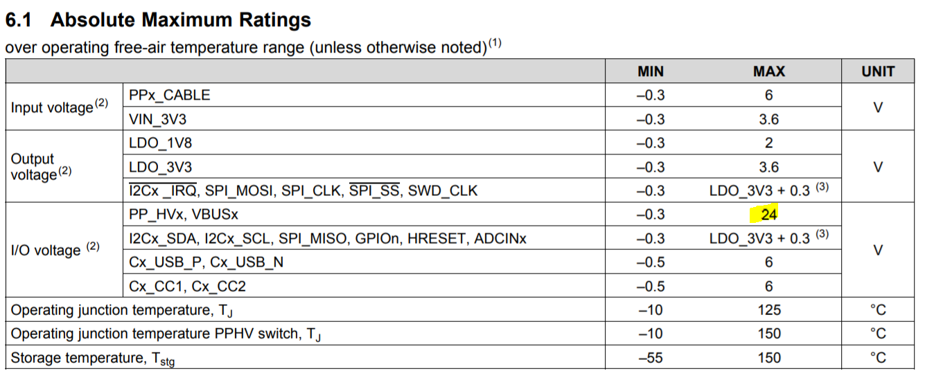

From the application note slva994, we can set the OVP trip point at 24V.
But we found that the absolute maximum rating of VBUS pin is only 24V also.
Does it means that 987D will be damaged once the VBUS becomes higher than 24V?
