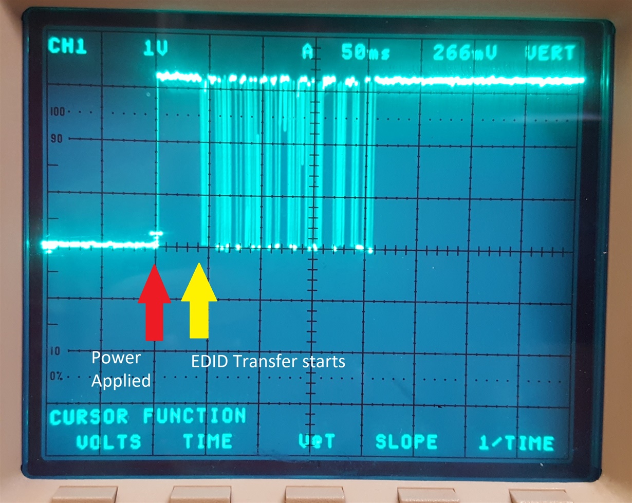

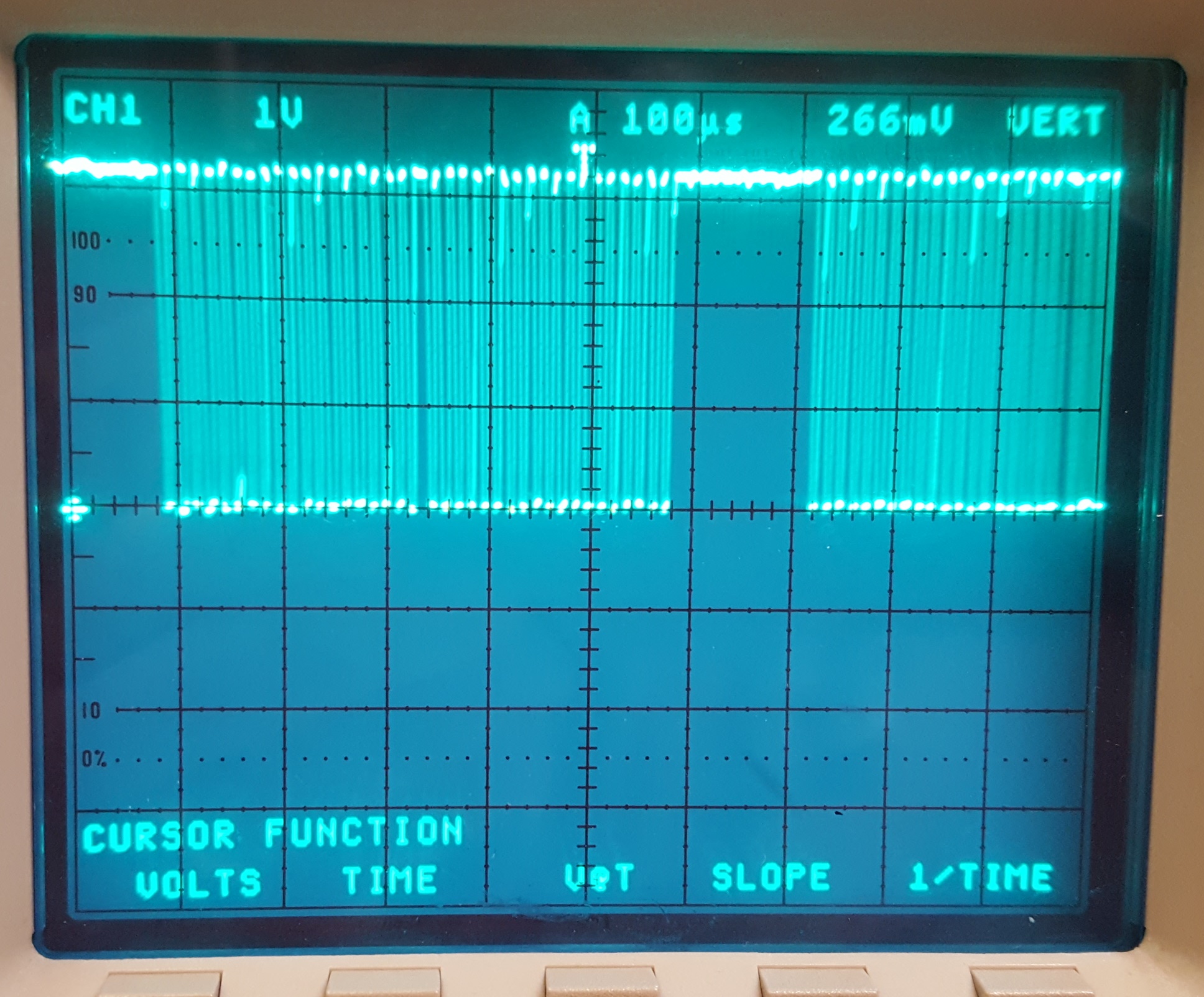

  • Hello Mike,
    We tried to capture the EEPROM-Deserializer I2C lines to check if there is any data transfer between EEPROM to Deserializer. But we could not see any data on I2C lines.
    We tried setting 0x4F(1) bit to 1 and capture the EEPROM-Deserializer I2C lines but when we read back the 0x4F(1), it was 0.
    Result: We could not see any data on I2C lines and also 0x4F(1) bit was 0 even after setting it to 1.
    Please clarify us on which DDC bus you are talking about between EEPROM-Desializer. Because we have only I2C lines (Pin number 45 and 46 of deserializer) connected between EEPROM-Deserializer.
    Thank you,
    Prathibha

  • Hi Prathibha,
    I see that 949 0x50(4) is high, which is good.  You must test for this before setting 0x4F(1).
    You mentioned that the EEPROM 7-bit address is 0x50.  In that case, you must write 0x50 to 949 register 0x51(7-1).  You have it programmed to 0xA0 so the 948 is looking for the EEPROM at that address.
    949 0x50(3) is low.  This must be high before reading the SRAM.
    949 0x54(5) is preventing remote EDID read.  Check the MODE_SEL_0 and MODE_SEL_1 strapping, it looks like you have it strapped differently than reported.  This bit needs to be low.
    Mike

    • Power up the SERDES pair with a scope probe on the 948 SCL,SDA, and system power.  Trigger on the rising edge of system power.  If the EEPROM matches the EDID address in the 949 and the 948 sees the EEPROM on the I2C bus, the EDID transfer will look like the image below.  Note that the waveform is compressed and there is some aliasing; close-up images follow.
    • Close-up of I2C clock
    • Close-up of I2C data
    • If the I2C activity is very short (a byte or two) then the 948 did not see the EEPROM or the 949 was not configured correctly.

    I powered down, removed the EEPROM and then powered up to observe a failed EDID load.
    • Very short clock burst at the 948 I2C upon system power-up

  • Hello Mike,
    Below are the waveforms which we capture.
    1. Ch1-Supply and Ch2-PDB
    2. Ch1-PDB and Ch2-MODE4 pin and MODE_SEL1 switch
    Thank you,
    Prathibha

  • Hi Prathibha,
    I don't see anything wrong with the procedure, just with MODE_SEL1 coming up wrong then correct after PDB.
    This suggests that the MODE_SEL1 pin is ramping up at a slow rate.  Is there a capacitor on MODE_SEL1?  If yes, the RC delay on the pin would explain this behavior.  Please check for that.
    Can you try to PDB both 948/949 at the exact same time?
    Mike
