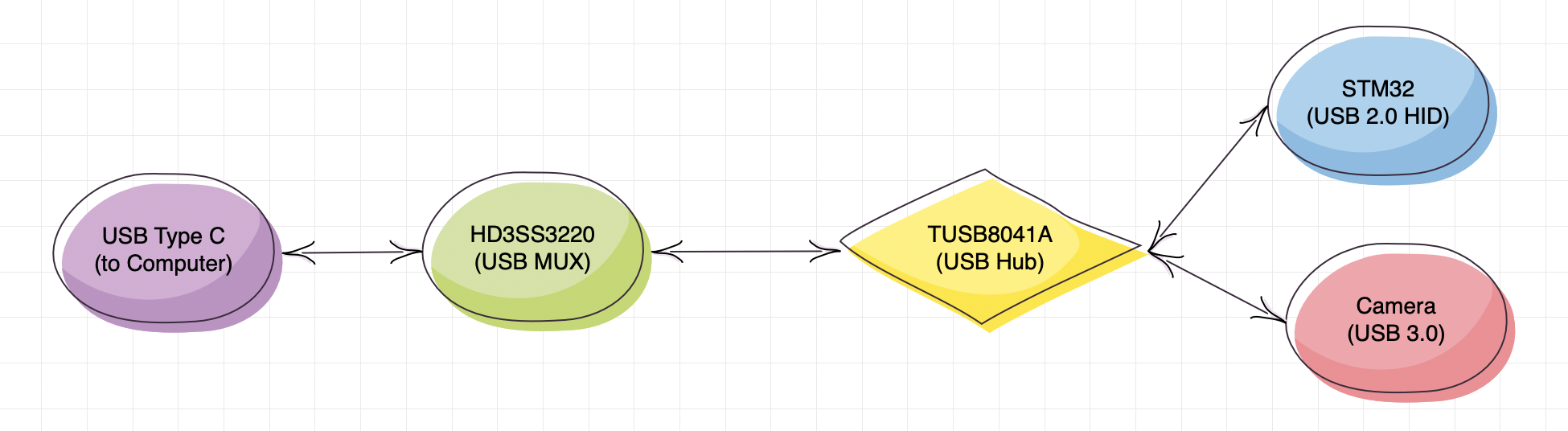

  • can you draw block diagram for different cases?

  • Not entirely sure what you meant here, but here is a block diagram of the board.

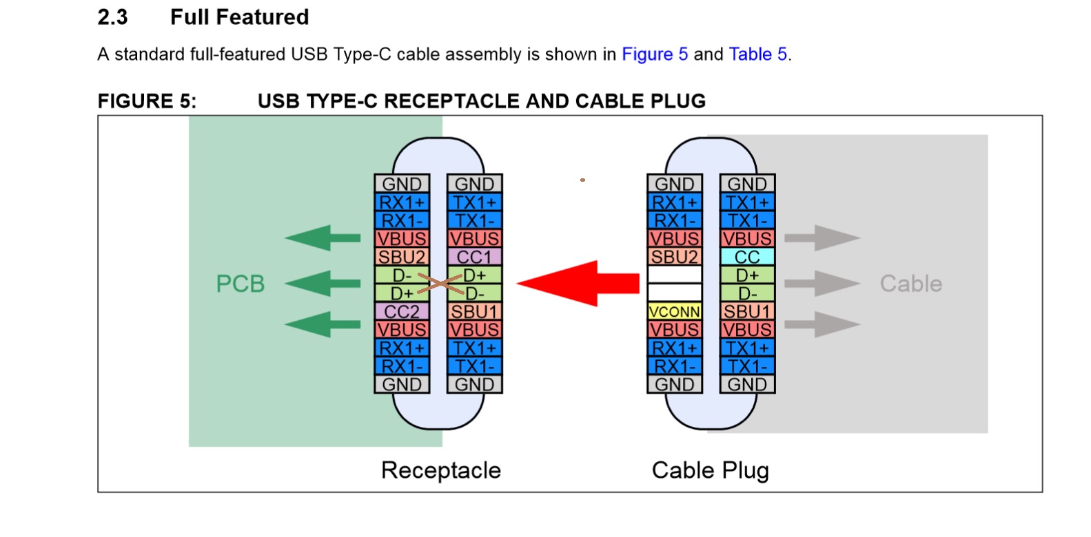

  • for type-C cable, only has D+/D- on one side. In order to make cable work on both sides, you have to short D+ to D+ and D- to D- on Type-C receptacle.
  • Thanks for replying Brian,
    As a non-native English speaker, the word "short" typically means connecting something to ground or another net. I can see in the originally mentioned Figure 12 of the HD3SS3220 as well as the illustration above that the wires are crossing. I fully understand that the D+/D- signals must be on both sides of the connector in opposite order for the cable to work in both orientations. I also know I had this wrong in my schematic/board - thus it would only work as a USB 2.0 hub when the cable was in one orientation.
    What I do not understand here is the word "short" since I cannot see any "short" (as I know it) in the 2.3 illustration above.
