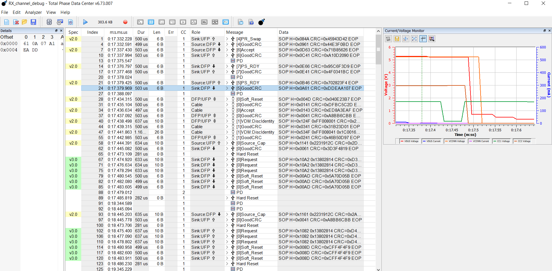

Issue still remains there. We can have certain FWs made with your “application tool” which are not suffering this issue. But almost all the time we are configuring some parameter we also see that port1 start cause Hard Reset issue as well. Hard Reset is only visible when port1 ends up to power sink. So basically when plugging in DFP or if we make PR_SWAP to sink. PD-sniffer logs attached. CC-lines and VBUS looks good in oscilloscope.

    Would you be able to share a scope capture  that includes VBUS, CC, and VBUS current? This was the last request from the previous thread and would be the starting point.

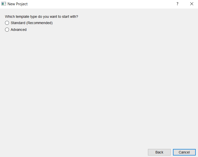

  • And if I am using standard template I cannot map I2C3 to GPIO5&6.

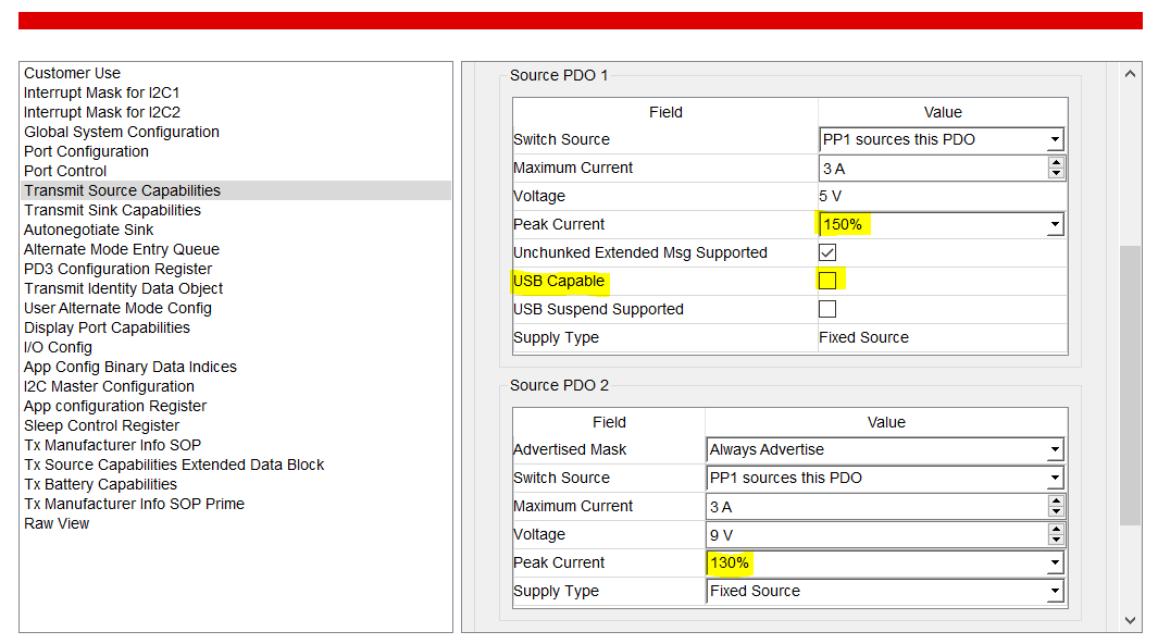

    Also, I noticed that in your non-working project, you have changed the peak current values of the source capablilities PDOs to 150% and 130%. I would recommend having the peak current at 100%, depending on your application again there might be an OVP/UVP issue which could be causing a reset. Also, is there a reason you have unchecked USB capable? You have it checked for the working project, so you may also need to check this box.

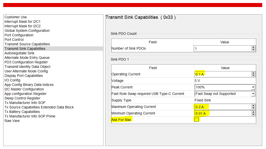

    For the sink capabilities, I see that you have changed the values for "operating current", "maximum operating current" and "minimum operating current" on the non-working project. I'm not sure how much current your other device needs, but you may need to adjust it accordingly because at the moment your operating current for the Sink PDOs is only 0.1A. However, our default settings for this device have the operating current at 0.9A, the maximum operating current at 3A and the minimum operating current at 0.9A. Therefore, I would also recommend changing these back to the default values and also checking the "Ask For Max" box.

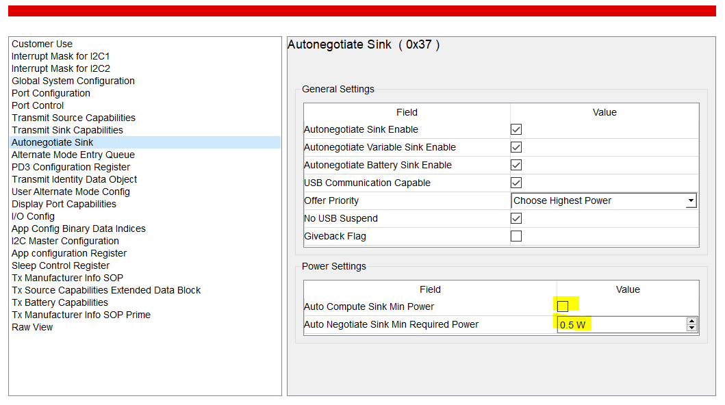

    Another setting I noticed that you may have changed is in the Autonegotiate Sink Register. I see that you do not have the "Auto Compute Sink Min Power" checked. I would recommend checking this box and changing the min required power value to 15.25W as this is our default setting.

    Is your project with advanced template as I need I2C3 in my application?
    Thanks, -teemu
  • Hi Teemu,
    Yes, the project file that I attached is in advanced mode for your application. You can go ahead and import that project or load it into the GUI version 6.1.1.
