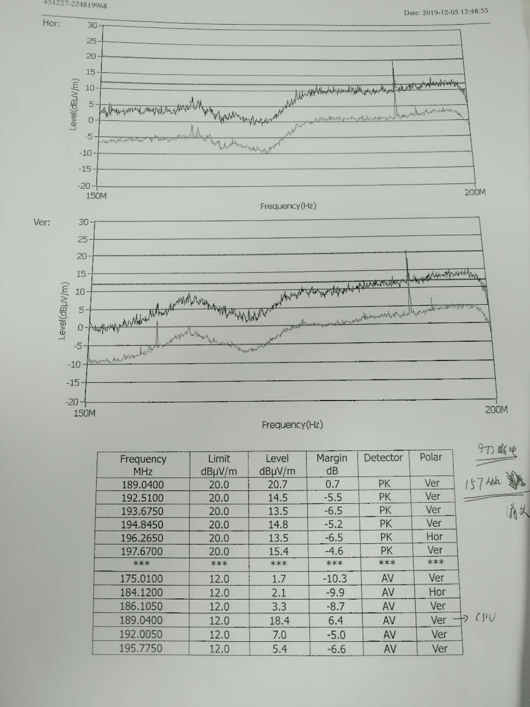

My customer use 933/934 and met EMI issue.
  • 157.25MHz: over 3.2dB
  • 188.7MHz: over 7.5dB
Because PCLK=62.9M,so 188.7MHz is because three times of PCLK.
Because when power off 933, 157.25MHz is disapper, so 157.25MHz is because of 933.
Any advice about fix out 157.25MHz and 188.7MHz?Thanks!
1) 933 and 934 both  work
you can see:
  • 157.25MHz: over 3.2dB (compare to margin)
  • 188.7MHz: over 7.5dB (compare to margin)
2) 933 off, only 934 work
3) 934 off, only 933 work
  • Hello Amelie,
    which clocking mode are you using, PCLK or External CLK?
    Which Mode are you using, 10-bit, 12-bit HF or 10-bit LF?
    You know EMI is a system issue not a device issue, so we may need to review your schematics and Layout!!

  • Hello Amilie,
    When using the 10-bit mode, the PCLK is divided by 2, hence the resulting frequency is 62.9MHz /2 = 31.45MHz. If you multiply this frequency x5 = 157.25MHz.
    You may ask them to reduce the VOD as following:
    • Write in REG 0x04[7:6] the value 0b’01. (Default = 0b’10)
