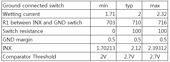

    -. I'd like to double confirm it about that. The max. 1.7V of VCSI_DROP_OPEN is caused by internal resistance at current sink, regardless of the exteral resistance. Is it correct?
    -. In addition, belwo is an example of Grounded connected switch. Is the calucation right? Which threshodl should I use? min or max?

  • Hi Sam,
    as the external Resistors will impact the current flowing into INx the voltage drop will change due to the internal components (resistors, switches, etc.). The exact voltage drop is best measured on the TIC12400EVM
    Can you add more details which instruction you are using to create the attached matrix? And can you add the units to all rows?

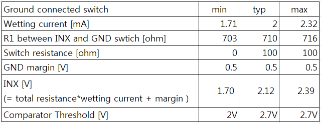

  • Hi Amboise,
    Sorry. I added the units in the table. I used the equation of INx = total registance(R1+Switch R) x wetting current + GND shift margin. Is it okay? Also, to select the comparator threshold, what value should I use, min or max?
    Sam Lee
  • Hi Sam,
    your calculations look good, for the threshold voltage you have to check with chapter 5.2 in out configure guide. The selection of Vth also depends on Vsource (VS).
