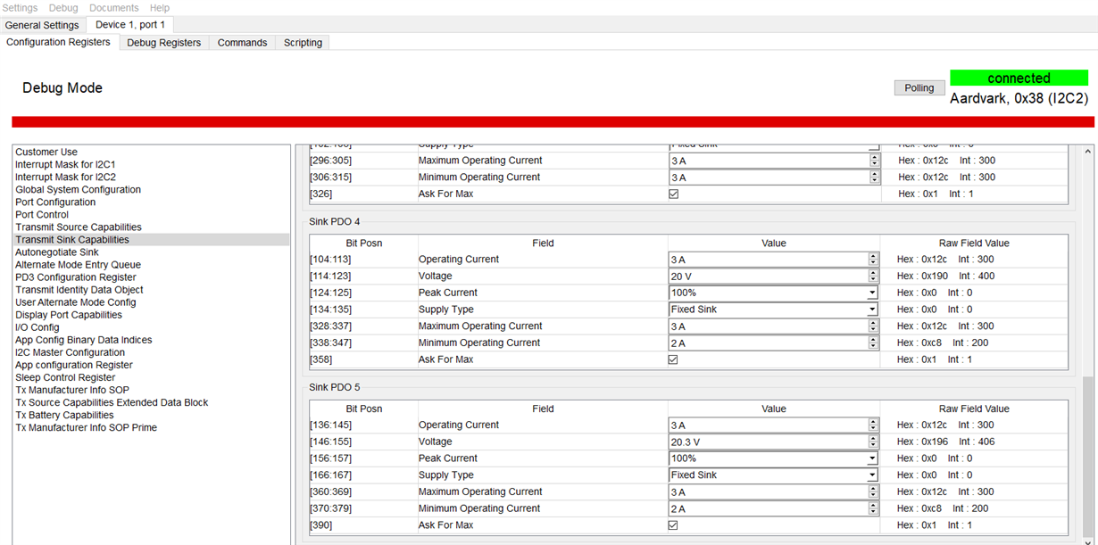

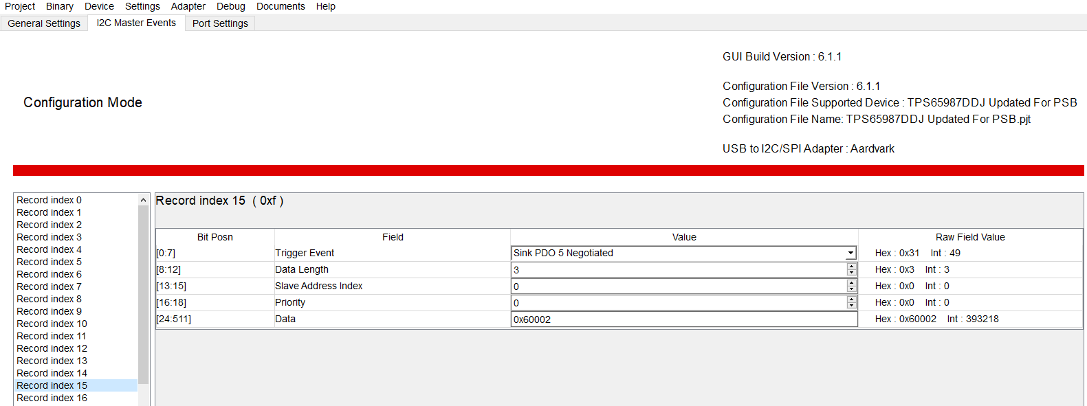

The problem I'm having is that when a PD contract is negotiated, the TPS65987 is not sending the I2C message to the BQ25703A that sets the charge current for the connected battery, and thus the battery doesn't charge.  Some screen shots below show the problem.  First shot shows the active PDO, which matches Sink PDO 5 shown in 2nd picture.  3rd picture shows that this PDO being negotiated should trigger the sending of the I2C message to set the current on the BQ25703A.  I have the "App Config Binary Data Indices" Port 1 I2C Record Number of Indices set to the correct value (15), since that's all I have.  Other I2C messages based on other event triggers are being sent properly, so I know everything else is working the way it should.  I did try one experiment to set the Event Trigger to the closing of the PP Switch...when I did this, the message was correctly sent, and the battery charged.
The problem, as I see it, is that the TPS65987 is for some reason not recognizing that PDO 5 is being negotiated/used, and is therefore not generating the event to send the I2C message.  How do I fix this?

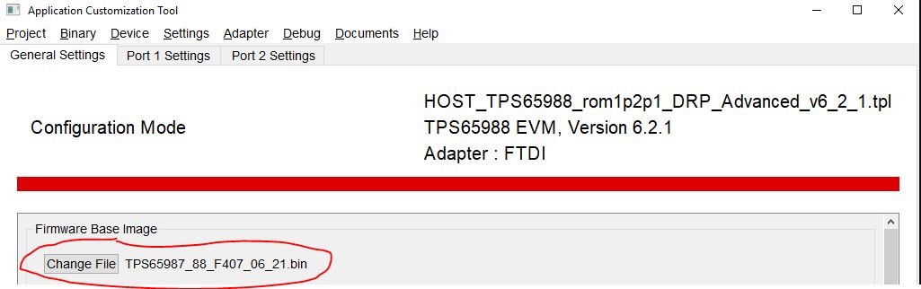

  • Hello Kedar,
    I feel like I'm missing something.  The version of the Application Customization Tool that I'm using is version:  6.1.1
    This seems like the most recent version that I can find:  http://www.ti.com/tool/TPS6598X-CONFIG
    However, in other forum posts, I see people referencing what look like later/newer versions (in this post someone mentions version 6.2.3:  https://e2e.ti.com/support/interface/f/138/p/871010/3226850?tisearch=e2e-sitesearch&keymatch=TPS65987DDJ%20firmware#3226850)

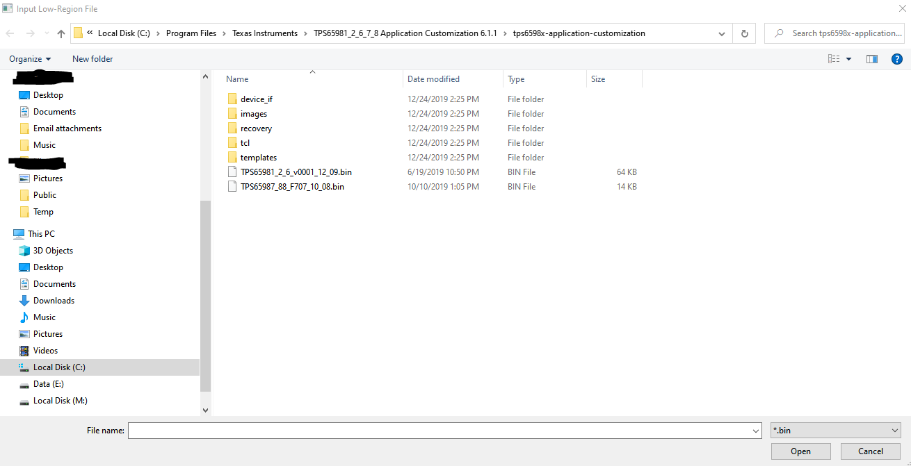

    In the 6.1.1 version, when I click on the "Change File" button under "Firmware Base Image", the only options I see are shown below.  How do I find the firmware version you mention above (F708_12_3x)?
    Thanks!
    Ted
  • Hi Ted,
    My apologies. I seem to have misquoted the version number as F708_12_3x, instead of F807_12_3x. The title of this E2E issue mentions "TPS65987DDJ", but the GUI tool version you are mentioning supports TPS65987DDH.
    Can you confirm the device version of the board you are using?
    If you are using TPS65987DDH, then the GUI application version and the binary being used are correct.
    If it is a TPS65987DDJ board you have, may I know where you sourced it from?
    Also, It appears that the project configuration is missing the I2C Master Event configuration.
    Did you get a chance to look at our application note at http://www.ti.com/lit/an/slvae18/slvae18.pdf. This has detailed steps on setting up the device for I2C Master.
    Let me know if you face any issues with this.
