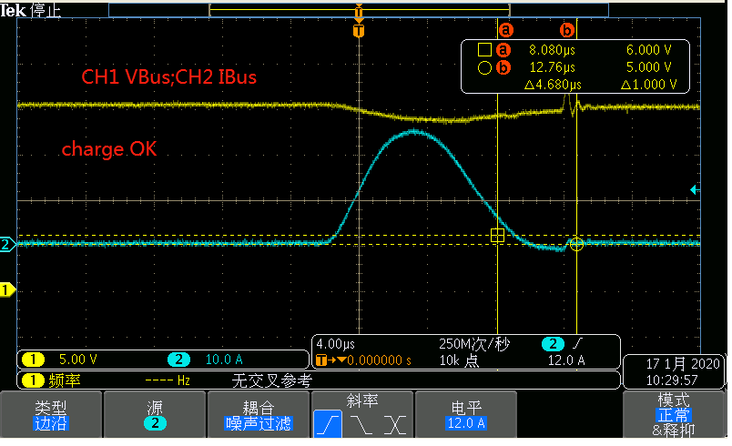

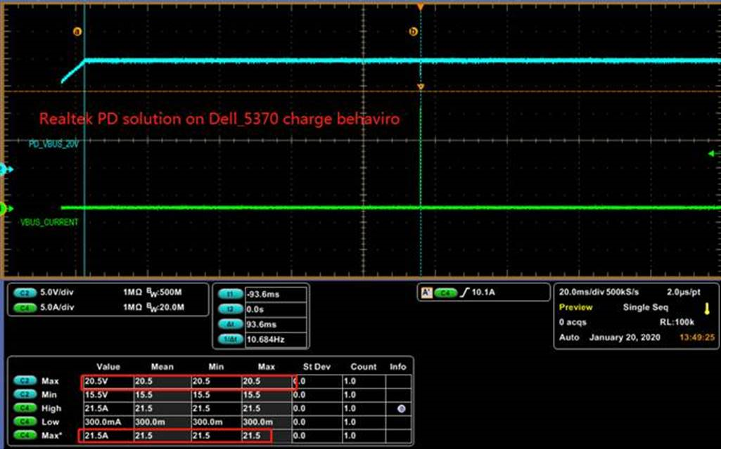

 there is a question from our compatibility test, from  TI's document (see the below picture) said ,the behavior control in10mS for the average current.if over the max setting value( max 20V/5A,peak current 150%

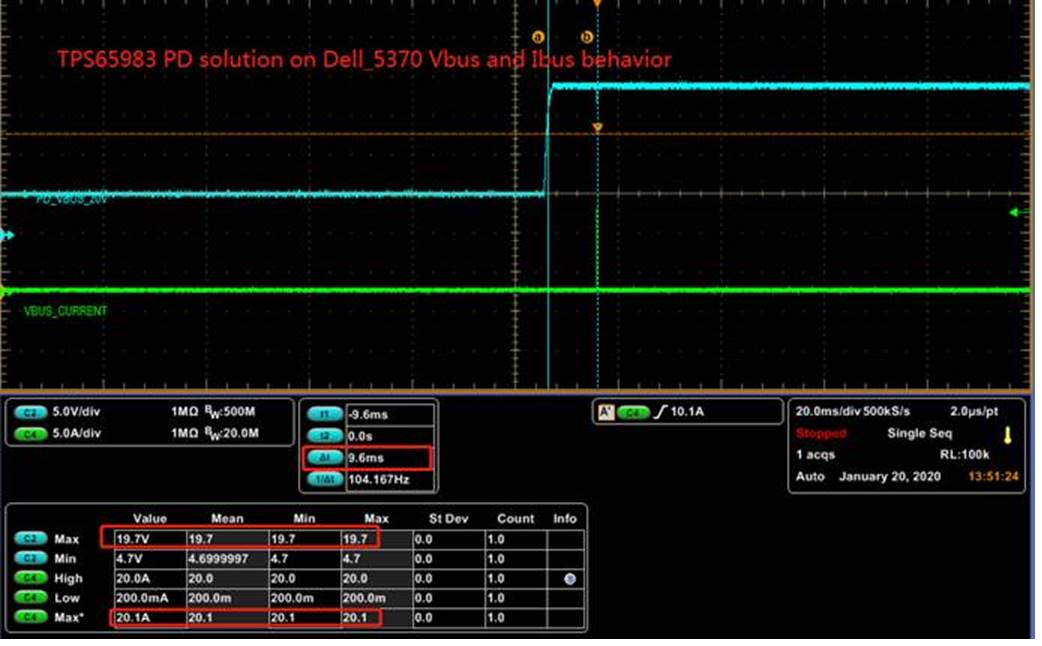

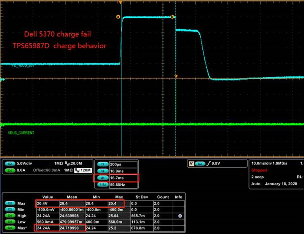

but  the NB of Dell_5370 out of the 10mS and peakcurrent(inrush) reach 25A max(see the caputre1).so,it's charge fail on it .
i  checked other's soulution(TPS65983), same as condiftion test, the behavior can meet TI's document(see the capture2).and charge OK.
the same time, i checked other suppiler PD solution(Realtek), they Vbus ahead IBus more(reach 93mS),it's charge normal,
is the Realtek's PD solution didn't follow PD spec? or our TPS65987D didn't follow PD Spec?
if fix this issue, could you help me confirm and add some suggestion for this solution.

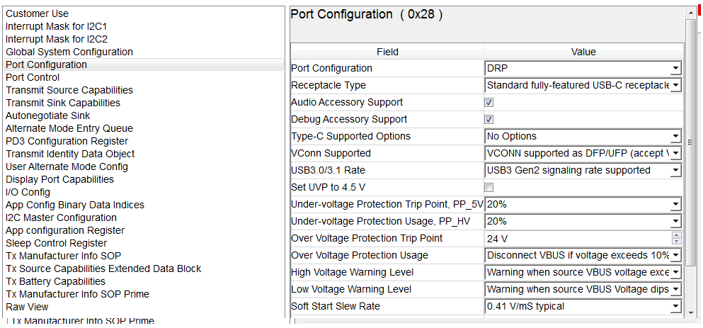

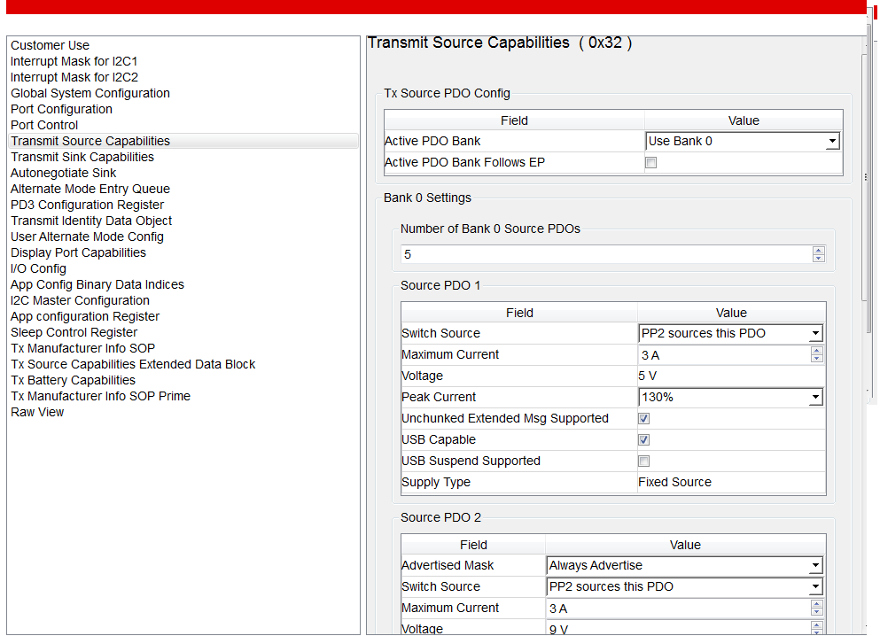

  • Hi,Emma:

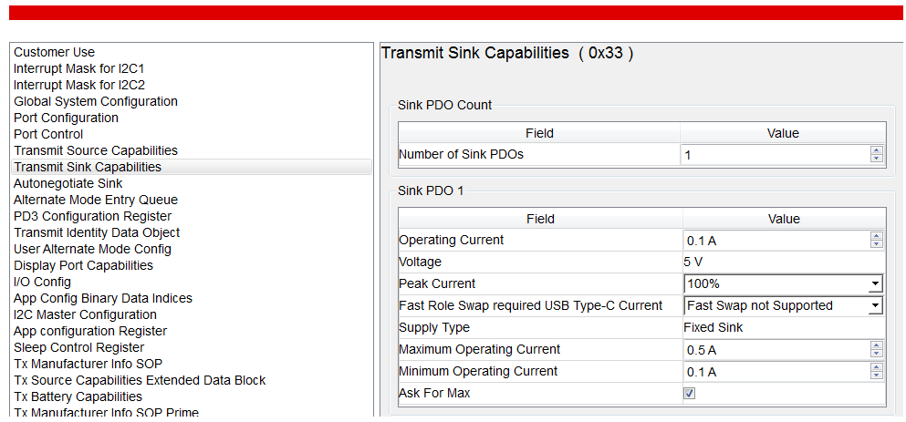

     No,we are using it on Docking station as a power source(the 0X33&0x32 setting as below),about the port configuration,
    how to setting can cover the NB of Dell_5370 PD charge ?
    could you help us confirm and instruct the setting on FW tool?

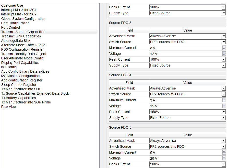

    Could you show me your full list of source caps? Also, could you provide scope shots that capture the overcurrent situation in higher resolution? Right now it is difficult to tell where your current is spiking and how high it's spiking. I also cannot see the current increase for the circuits that have working charging. It appears to be 0 A.
    Emma
  • Hi,Emma:
      supplement the source caps as below.and attached the zoom in the inrush current for NB of Dell_5370.(one for fail ,the other for OK(smoothly on other docking)).
    kindly hope you add your comment for the issue(charge fail).
    thanks!

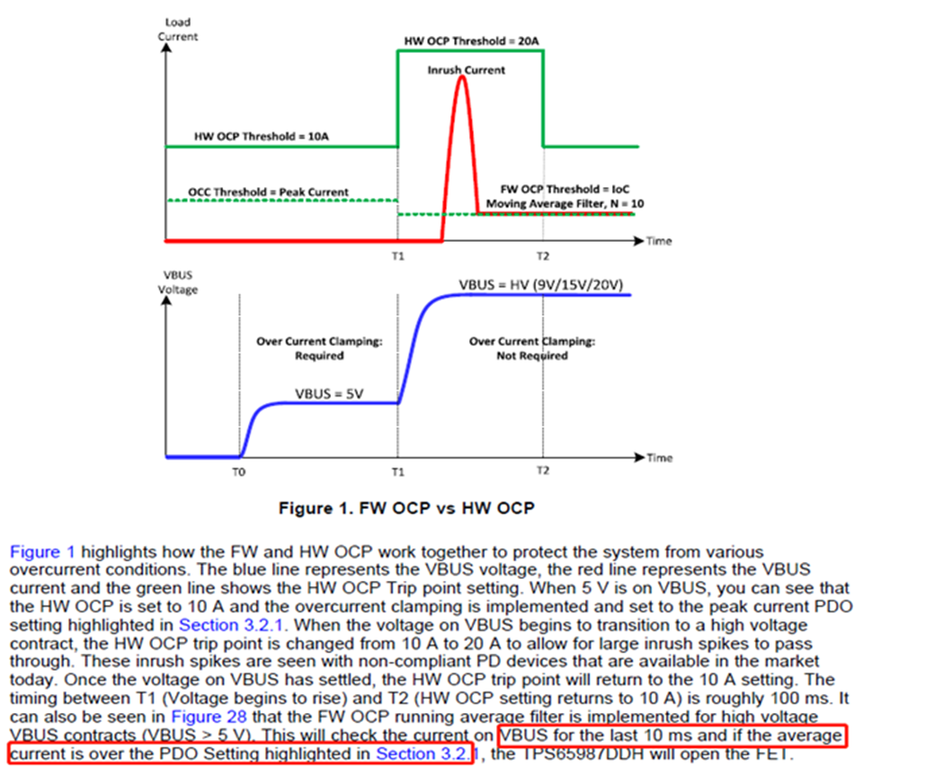

    You are hitting our overcurrent protection (OCP) with the sink you are connecting. The TPS65987D will increase its HW OCP trip point from 10 A to 20 A during the transition to a high voltage contract. Anything above 20 A, and the part will open the VBUS FET to protect the system. Your inrush current is spiking up to 24 A, so the device opening the FET to protect the system is expected behavior.

    Yes, i know this behaviro been reach to OCP on the system. your means said ,it been chareg  if the spike current decrease to 20A..and the system support to 20A be automatically by itself,is right?
    so the same as test condition, the TPS65982 and realtek been chareg normal for the inrush within 20A.
    could you provide some solution to us for the inrush decrease? or other good ideal cover this issue?
    thanks!
    Yes, if the current spike is 20 A or less, the device's OCP point will not be triggered.
    Bypass capacitors are a good tool to use to decrease inrush current. Ensure that you have the recommended bypass capacitors on your inputs, shown below.
    Section 9.2.1.2 Detailed Design Procedure from the TPS65987D datasheet explains some of the capacitors you can have at your Type-C connector, shown below.

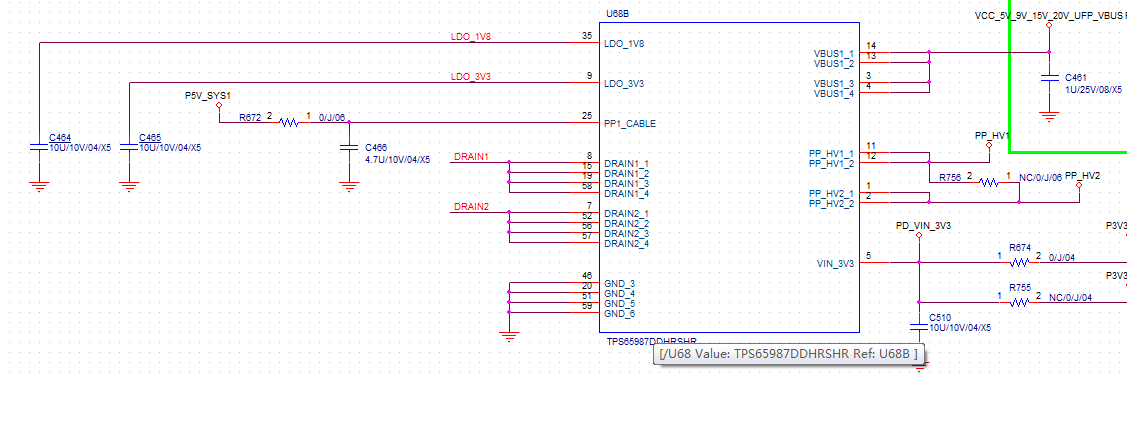

      i am follow the design from EVM on our the schematic(see as below),but the issue can't improve on this NB of Dell_5370.
    could you have antoher solution recommend ?and  Soft-Star setting on FW tool or HW portion for it ?
    kindly hope you give good feedback to me.
    thanks!

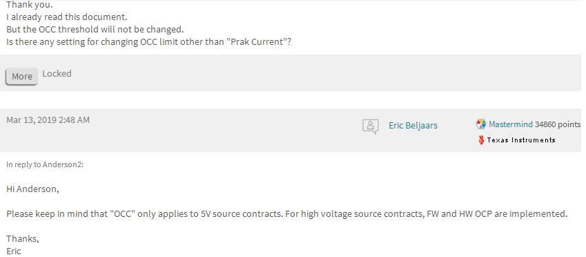

    Iocc is dependent on what you set the Max Current to be in your PDOs. The Overcurrent Clamp Point's min must be greater than, or equal to, the max current you set in the GUI. It is described in detail in the TPS65987DDH Power Path Performance and Protection app note.

    The table and over current clamping, OCC, only apply when sourcing 5V, as described above. That is why the table does not extend past the values shown.
    When negotiating a high voltage contract on VBUS (VBUS > 5 V), the TPS65987DDH will dynamically adjust the hardware OCP trip point from 10 A to 20 A while the VBUS voltage is transitioning from 5 V to the negotiated high voltage level.

    The hardware OCP point being moved from 10 A to 20 A is described in 3.1 FW OCP vs HW OCP and also 3.3 Hardware Overcurrent Protection (HW OCP)

  • Hi,Emma:
       yes, the document is said the 10A to 20A for HW OCP max when the PDO voltage change to higher from 5V,if settled will return to 10A.
                and the HW OCP is dynamically changing the OCP piont during the voltage transition,it seem for inrush relationship.
       but the FW OCP point doesn't describe any higher voltage,only explain the 5V item.

    So the Over Current Clamp (OCC), refers to the current limiting that we do on the 5V source contracts only.

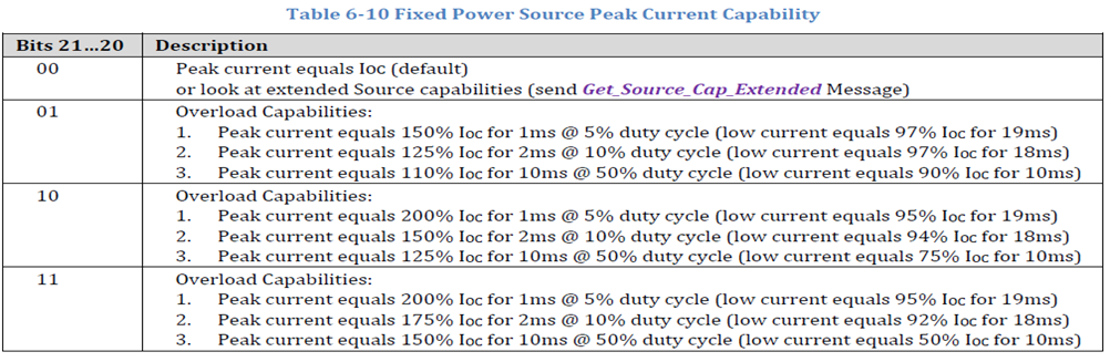

    The OCP follows the guidelines talked about in Table 6-10 Fixed Power Source Peak Current Capability from the PD spec, posted earlier.
    The GUI peak current settings directly reflects these bit options described in the PD spec table.
    Setting a peak current of 130% means the device will have the following overload capabilities:
    Setting a peak current of 150% means the device will have the following overload capabilities:

  • Hi,Emma:
      understand it!
    but i can't find any  the value of peakcurrent on PD spec for the 130% correspond bit 01,and 150% correspond   bit 10.
    and they're 3 types(ie:1,2,3) value respectively on every bit,
    how to correspone  among the 3 types when i setting 150%(PD spec is bit 10) on TI's Tools?
    and i setting different peakcurrent(130%,150%)on TI's Tool(application configuration tool),
    their OCP value same as touch above 8A when i tested the OCP point by Power-Z+E-load.
    if follow PD spec for the peakcurrent, like that,they should be different OCP point.
    but the result don't it.

    The value of the peak current is the percent of the Ioc.
    To read more about the peak current testing, check out the PD spec. There are multiple sections that you can read to learn more about the peak current. Section 6.5.1.10 Peak Current Field discusses that the 3 (1, 2, 3) types are different combinations of % overload. So numbers 1-3 can apply to your test. If 150% (10) is selected, then the overload condition can maintain:
    Peak current equals 200% IOC for 1ms @ 5% duty cycle (low current equals 95% IOC for 19ms)        or
    Peak current equals 150% IOC for 2ms @ 10% duty cycle (low current equals 94% IOC for 18ms)      or
    Peak current equals 125% IOC for 10ms @ 50% duty cycle (low current equals 75% IOC for 10ms)    or

    Actually 01 and 10 share the overload condition at 150%. However, 01 can only withstand 150% Ioc for 1ms where 10 can withstand 150% Ioc for 2ms. So their overvoltage point may be the same with different timing cutoffs.

    Section 6.5.1.10 Peak Current Field discusses that the 3 (1, 2, 3) types are different combinations of % overload. The Power Path Performance and Protection app note explains how the TPS65987D meets the PD spec requirements.
    The GUI tool options apply to the PD spec table 6-10, so the GUI options do not only look at peak current.
