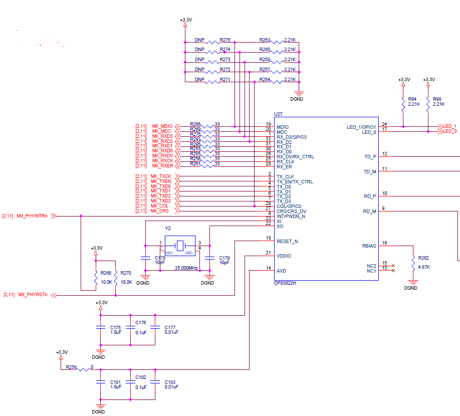

Schematic is setup as follows:
The goal is to use lwip. Using Saleae Logic Analyzer I am seeing contention on the MDIO analog reading where the signal in the data portion of the message is not able to drive high. We believe it is a configuration issue, but are unsure if it is a configuration issue of the processor, or the PHY.  R275 is populated on the MDIO line with a 2.2k resistor.
For further insight the lwip example has been used as a base, and The pin configuration described above, and UART setup has been the only modifications to software.
C:\ti\controlSUITE\device_support\f28m36x\v220\F28M36x_examples_Master\enet_lwip\m3\ccs
Testing with a router: Router Wired port <---Ethernet Cable---> Board
Expectation is the Board Eth port LEDs would respond, and the Router LED would respond. As an additional check the Ethernet cable was connected to the laptop instead of the board and the LEDs on both router and laptop were on.
We believe the contention seen to be the issue and are unsure if it is on the processor, or PHY side setup issue? Let me know if any additional information would be helpful to confirm setup.
    May I know why you think it is a contention issue. The Digital side of your Saelae shows that the microcontroller is trying to Read PHY address 0 and register address Can you check if the PHY is out of reset?  If the PHY address is properly configured to be address 0.
    Sudhar
  • This data portion of the signal (analog) appears to be attempting to go high in 4 places, and are unable to reach high. This is what I am calling contention.
    The five bit address is on RX_D3_RX_D2, RX_D1, RX_D0 & COL. RX_D0-D3 are internally pull low, so if no resistor is placed, then the default will be 0. For COL, internally pull up, however, we have 2.2K resistor pull down, so we change the bit to 0 as well. This is how the address is setup right now, this should result in a PHY address of 0.
  • The signal appears okay to me
    following the pattern :
    <idle><01><10><AAAAA><RRRRR><Z0><XXXX XXXX XXXX XXXX><idle> for the read operation as shown in the PHY datasheet.
    Can you please check at the PHY end if it is out of reset by probing the RESET_N pin of PHY
    Sudharsanan
  • Highlighting the section of concern in the image above:
    4 sections of this wave form appear to be not fully low, and not fully high. The two peaks in the image the left and right of the image representing high. The logic analyzer "appears" to capture a successful message but, would be misleading if the correct data message has those highs in it. Also there is no explanation for this contention (What I am calling contention).
    I will work on probing PHY RESET_N, and get back to you.

    ok. I see that. Hope the R263 is not populated now.
  • RESET_N on the PHY is showing 3.29 volts, so high, meaning reset is not active.
    We have tested several configurations regarding the pullup resistors:
    Originally R263 was populated this was showing contention
    Then R263 removed and R275 populated, continued to see contention, switched software settings on MDIO pin from GPIO_PIN_TYPE_STD, to GPIO_PIN_TYPE_OD_WPU, and then GPIO_PIN_TYPE_OD with no luck.
    And now we have removed R275 and made software pin type changes with no luck.
    If you could highlight and confirm what hardware/software configuration should work? and I can try those again to confirm.
