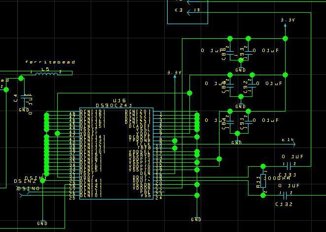

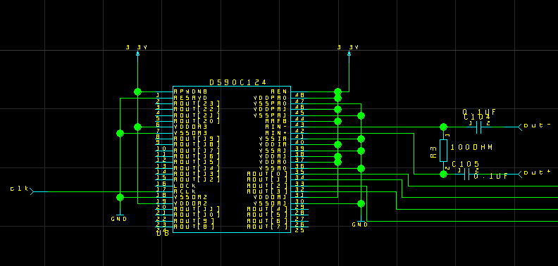

This is with reference to DS90C241/DS90C124.. wanted to know the reason as to why the PLL in serialiser (DS90C241) doesn't get locked to TCLK when VCC is powered due to which I don't get output at serialiser. Similar problem arises with deserialiser (DS90C124). Have shorted TCLK of DS90C241 to RCLK of DS90C124. Is there any problem in this? Please reply

    It is not typical to have the recovered RCLK output tied to the TCLK input.  Can you upload a schematic showing the DS90C241/DS90C124 devices?
    What is the TCLK frequency?  It should be between 5-35 MHz.
    Is TPWDNB = Logic 1 (High) ?
    Is RPWDNB = Logic 1 (High) ?
    Lee

    I would not generally associate these devices with USB, RS232, and Ethernet applications.  Looking at the schematic, the Control and Data inputs all seem correct and follow datasheet guidelines.  The Clock input looks like it is drawn as an "output" on the schematic.  The input Clock is very important to the operation of the DS90C241, what is the frequency of the input clock?  What are the logic levels of the input clock?  The input clock signal should have monotonic edges and a typical amplitude of 3.3V.

    I do not think you have the DS90C241 and DS90C124 connected correctly.  Do not connect the clocks together.
    Start with just the DS90C241 and connect a 3.3V clock to the TCLK input.  Once a valid clock is available on the DS90C241 input, the serializer should be able to lock to it and output the serial data.
    Verify with an oscilloscope that the frequency and voltage levels of the clock meet the datasheet specification at the TCLK input.
    Tell me more about the USB,RS232,RS485, and Ethernet signals you are sending into the DS90C241 device. What are the voltage levels of these signals and how are they related to the clock signal?
    Lee

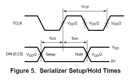

    The DS90C241 has a parallel clock input range of 5 to 35 MHz, the device can only accept data inputs which toggle slower than 35 MHz or 17.5 Mbps. This means that if you strip away the half duplex nature of USB and force it to stream constantly in one direction, then you will only be able to support USB1.0 or 1.1 speeds.
    Please confirm which USB spec you are trying to use.
    Also, as noted previously you will need to provide the input TCLK from either the same clock domain as your highest speed data or ensure that the TCLK is much much faster than the incoming parallel data to over sample. Note, over sampling the data, may result in added jitter to the output signal.
    You also mentioned that the TCLK and RCLK were tied together. Please provide the full schematic for your board so that we can better understand how the system is connected. A block diagram would also be helpful.

    Data Inputs must maintain a constant phase relationship between the input Clock to the serializer.  This means that the data is synchronous with the serializer input Clock.
    Serializer Clock and Data signals must meet all datasheet electrical specifications.
