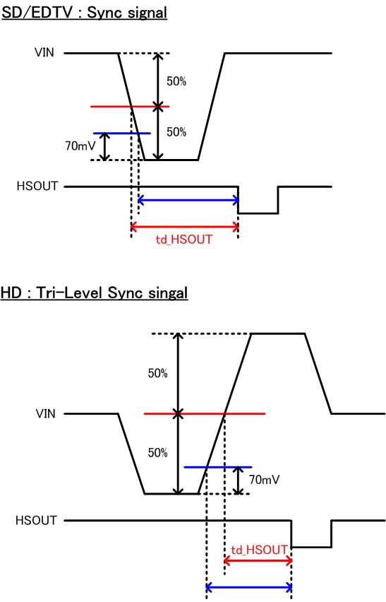

Hello Team,
Please allow me to confirm the slice level for LMH1980.
I am understanding the slice level is +70mV above V_sync clamp level.
Is this +70mV threshold applied to tri-level sync, too ?
Kawai
