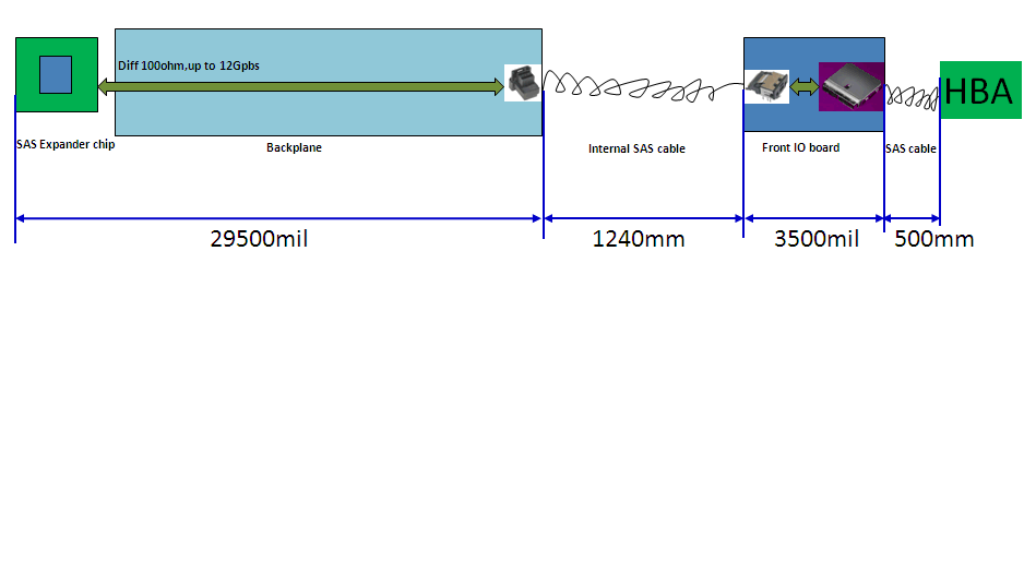

         Customer already get our IBIS model of DS125BR820 for simulation. Their project is urgent and can't have much time to tuning X parameters on IBIS model. They also evaluate MAXIM and they directly provide a X parameter for their simulation and the simulation results are better than DS125BR820 currently....
          Could we also provide a best and suitable X parameters of IBIS model base on the topology to customer? Due to customer has no more time to tuning step by step for that. Thank you.
