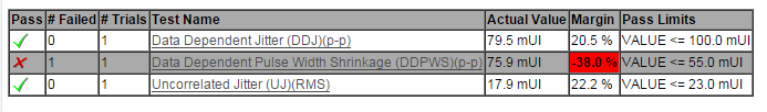

    2. For PRBS9, should i set the Channel Register 0x0C value as "Default = 08'h" or "Change to = 00'h" ?  Now, with the initial setting (0x0C = 00'h) on my board, the PRBS9 fail report as blow. It's the DDPWS item fail.
    I have never seen a waveform of that rate on an SFP+ interface.  Can you take a picture or draw a block diagram of your setup.  According to the horizontal timebase the high portion is over 4 microseconds in duration.

    For the 8180 abnormal waveform, maybe we have found the reason: As i told you before, the initial channel register 0x0C value = 00'h. So, when the 8180 pattern is abnormal with the initial configuration, I just re-write the register ="00'h", and as the feedback to you, the waveform is still abnormal.  But, when I try to write the register ="08'h" first, and then write it ="00'h" again, then, the 8180 pattern can be generated normally. and the test result is pass on one port. (Another ports will be arranged to test tomorrow ).
    So, for this phenomenon, can you explain it ? It seams the direct setting 00'h is not valid, but the value is indeed read as 00'h.
  • Since the 8180 signal has no single bit transitions, the DS100DF410 will not lock to this pattern by default.  Removing the signal bit transition check and restarting the DS100DF410's attempt to lock should result in a lock condition and an 8T clock pattern at the output.
