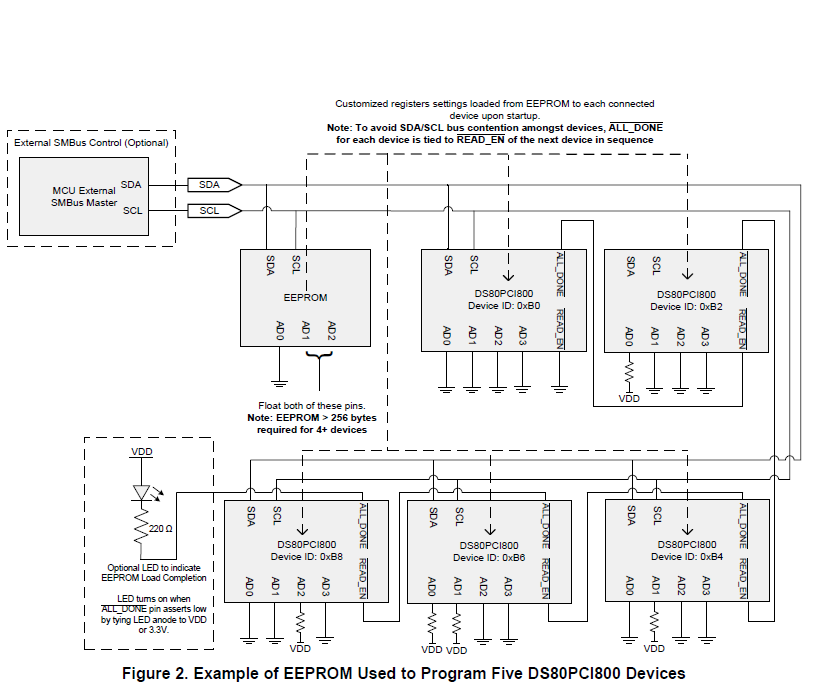

Hi Team,
The customer is using DS80PCI800 and DS80PCI810.
The customer uses two DS80PCI800 devices together. Now, he can only configure x8 bandwidth for DS80PCI800 through the PIN Config mode . VCC is 3.3V.
The customer has the DS80PCI810 device. If the customer needs to  configure x16 bandwidth for the DS80PCI800 and DS80PCI810 devcies, how does the
customer  configure?
