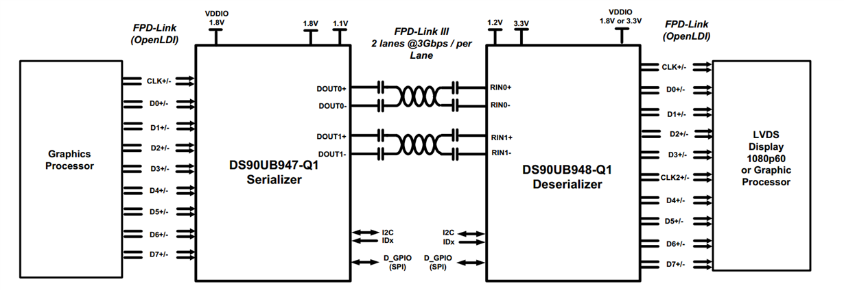

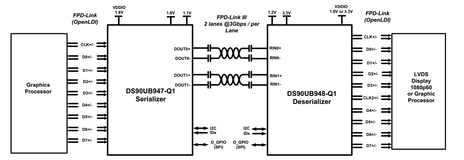

My customer application like enclosed files, and we want check if 947+940 can use this kind of application?

Boge,
you can refer to our EVM design or d/s application circuit, you can use 1 port or 2 port. this is our chip's function.

Hi Steven,
I read datasheet DS90UB947-Q1 pin DOUT0+/- and DOUT1+/- must be AC-coupled with a 33nF capacitor, and DS90UB940-Q1 pin RIN0+/- and RIN1+/- too. In case i use FR-4 PCB trace connect DS90UB947-Q1 and DS90UB940-Q1,Do I need to use capacitor between 2 IC?. How many capacitor I need?.
