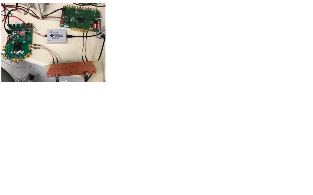

Our customer is considering STP or STQ cable, but 953EVM and 954EVM are for Coax.
Are you planning to release an evaluation board for STP or STQ cables?
They want to obtain a STP or STQ evaluation board for reference.

    1. We have SVBs (very limited quantities) with SMA's . These can be connected to an SMA-STP daughter card and then to an STP cable. A picture of this setup is attached.

    1.
    You mean that you will not be preparing an evaluation board for STP in the future?
    We are considering the use in STP and we believe that a mechanism for establishing communication is necessary for reference.

  • 1. As I had shown in the picture, we have an SVB with SMA's attached and this can be connected to a daughter card with SMA to STP conversion. This can be used as a board for establishing the connection.
