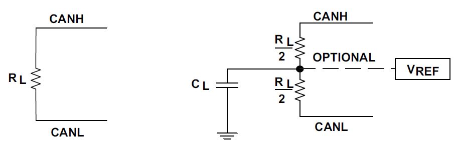

Hi Hirotaka,
Vod can suffer in amplitude in a setup like this when the bus is long and heavily loaded.By changing the termination resistors to 10K the corner frequency of the 3dB point is being moved from 1MHz to ~333kHz and extra loading is being placed on the system. This causes a smaller common mode filtering effect as well as forces the Vod to take an extra hit on amplitude due to the additional loading. Please refer to this wiki on the topic for more information: http://e2e.ti.com/support/interface/industrial_interface/w/industrial_interface/2513.can-termination-techniques.aspx
In situations where there are not to many nodes and the distance of the bus is not that great your customers termination scheme should work. Please let me know if you have any more questions?

Hi Hirotaka san,
The ISO11898 CAN standard specifies that the bus lines be terminated at each end with a characteristic impedance of 120 ohms. There are two common bus termination techniques that are used on CAN buses:
The first method call for a single termination resistor of 120 ohms while the second method calls for a split termination of two 60 ohm resistors with a capacitor to ground to filter the common mode noise. The resistors that your customer is looking to use is 100 times larger than then recommended value of 120 ohms. This will cause the Vod to take a larger hit in amplitude to due the voltage drop across the termination resistors.
Now the 3dB roll off point can be calculated using:
So you can see that the larger termination resistance is going to move the corner frequency to a lower value. I hope this helps answer your questions.

Hi Hirotaka,
For split terminations the R used when calculating the corner frequency is simply 1/2 of the differential pair. In your case R would be 10k yielding an Fc of ~3.4kHz where as a 60 ohm termination resistor would yield an Fc of 564kHz.

Hi Hirotaka san,
You are correct, if you exactly follow what ISO11898 says than the bus is simply teminated with 120 ohms at both the two end points and all the nodes in the middle do not use partial termination networks like the 2 x 10k ohms that we have been discussing. Partial terminations will not prevent the system from working (i.e. 2x 10kohms), I just recommend that you do not that this.
Partial terminations are implemented by designers to try to reduce the amount of reflections on the bus that are caused by excessive stub lengths. If the ISO11898 standard is followed correctly than there are no excessive stubs and these partial terminations are not needed.
