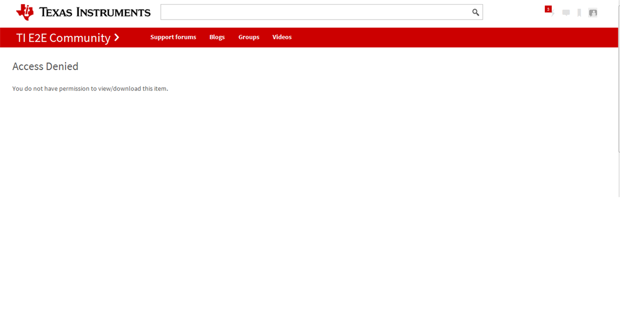

    When we open URL-link e2e.ti.com/.../409702, the following messages show.
    That'why, we made a new distribution.
    "Access Denined
     You do not have permission to view/download this item."
    Could you let us know what it causes?
