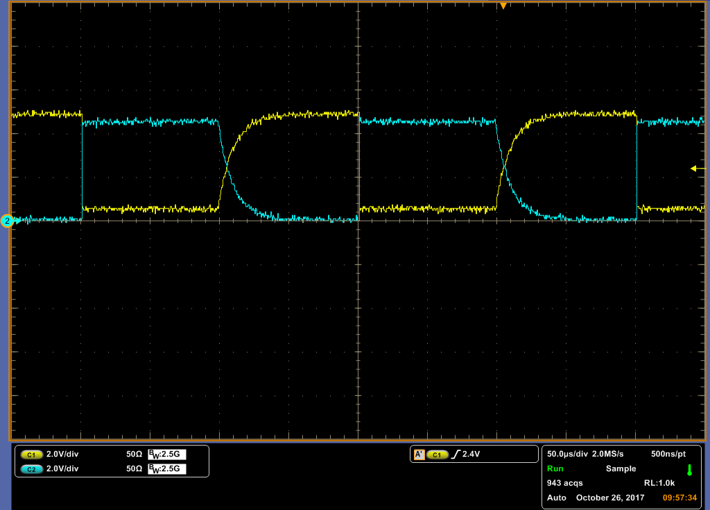

    I wanted to share some updates on this.  We did confirm similar behavior when evaluating THVD1550 in our lab, and so we experimented with some other transceivers to see if there would be another device that would have more symmetrical edges upon the driver disabling.  It appears that the SN65HVD3088E device is able to maintain symmetry on the A and B lines:
    In case internal IEC ESD protection is needed, then the SN65HVD82 device could be used instead.  We also evaluated this device in our lab and saw performance that matched the above image.
