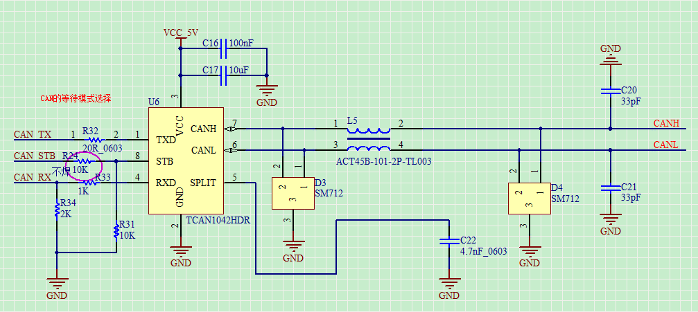

TCAN1042-Q1: The design is shown in the figure. At present, the problem is that the design causes damage to SM712 on the back end. At present, there are several SM712 damages that cause no communication problems (all of them are bad for D4)
Part Number: TCAN1042-Q1
