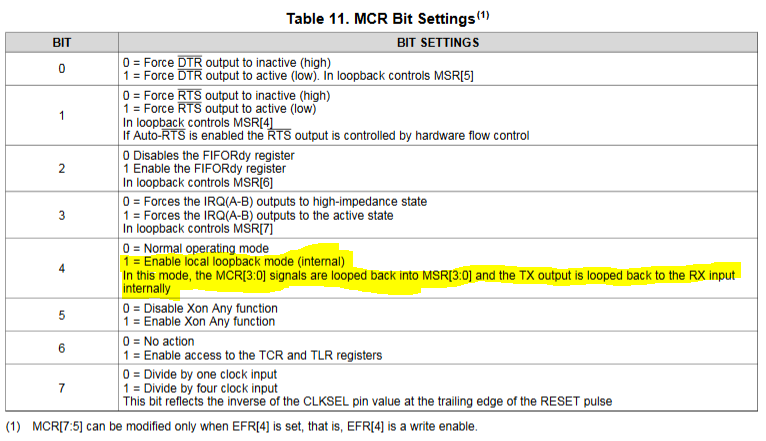

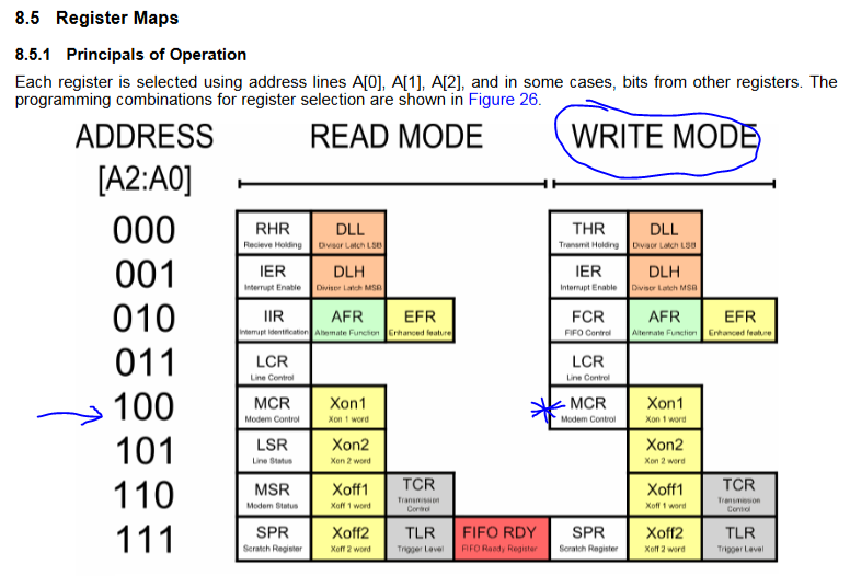

  • Hey Elangovan,
    This may be a silly question but did you enable the loop back setting on the device before trying to do this test?
    MCR bit 4 needs to be set to 1 in order for loop back testing to be done.
    Reference on where this is located:
    Reference for writes:
    -Bobby

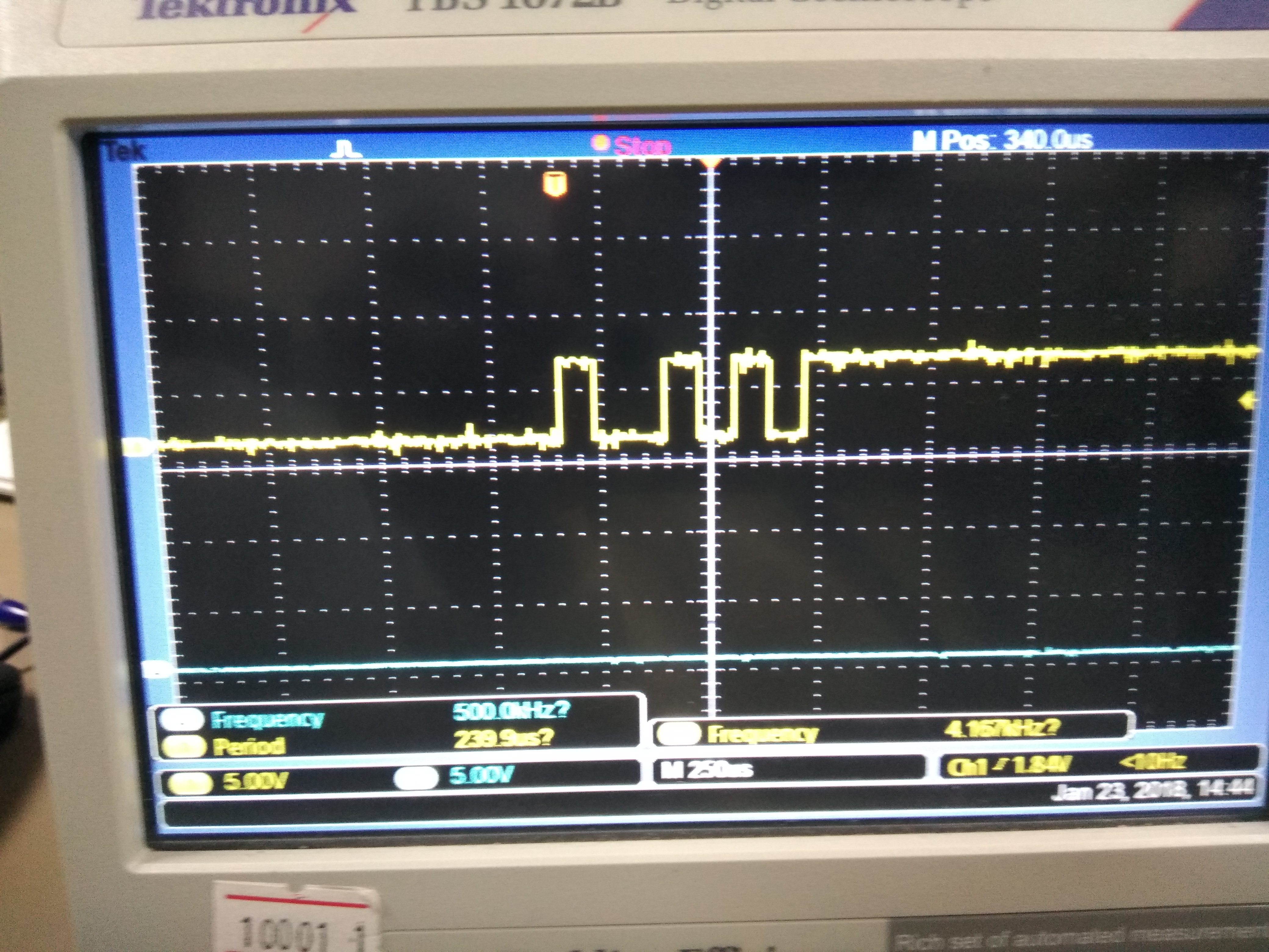

  • Dear Bobby,
    Thank you for the inputs. We performed the External loop back test and found the below observations.
    Please find the waveform captured at ‘CSA’ (Pin 10) and ‘TXA’ (pin 7) in the chip part number TL16C752DPFBRQ1 (Considered channel 1) during Pass and Failure cases for your reference.
     The waveform captured at pin ‘CSA’, Channel 1 selection is identical in both pass and failure cases.
    The waveform captured at pin ‘TXA’ is not identical in both pass and fail cases. Please refer the attached waveform, where you can find the difference signal change over before start bit transfer. (Red marking in the image)
    Request you to review and comment immediately.
    ElangoTL16C752D_Waveforms.zip

  •  Dear Bobby,
    We are enabling the loopback test (Verified both Internal/External for both channels) for both channels, there is an issue observed only at channel 1 during device initialization and first byte transmission irrespective of Temperature (Occurs at some cases).
    Example, we Transfer A9 11 12 on both channels for loopback test, Channel 1 reads C4 11 12  at Terminal. I have attached the waveform captured at pin 'TXA' for failure case.
    For RS232 Data Transmission,  In Idle Mode, the bus will stay in HIGH and HIGH - LOW for Start bit and then transfer the Data bits. But in Failure case, The Bus Stay in LOW in idle mode, then Goes HIGH and become LOW for Start Bit. This is where A9 is printed s C4.
    CSA keeps HIGH in idle Mode and Interrupt keeps LOW.
    Can you help us why it is happening only in Channel 1.
  • Hey Elango,
    Your device may be entering the break condition and pulling TXA low.
    What is the LCR bit 6 value set to? What is IER [3:0] set to? When INT is low, are you able to read the LSR?
    Try turning the break condition off by setting LCR bit 6 to "0."
    -Bobby
