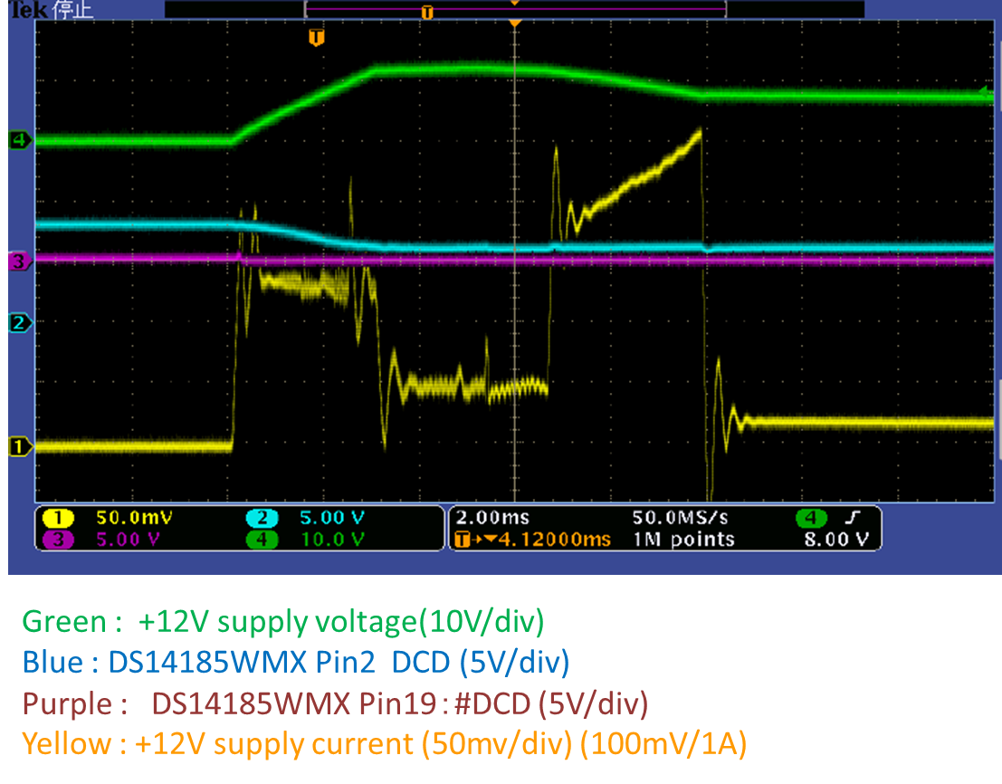

My customer has used DS14185 for their module and got an issue now.
Could you measure pulled current at 12V power supply of  DS14185 When the device is started up with 5 V applied to 2 pins and 3 pins?
 They saw large current was pulled in the condition as below, and its current caused over current error in their system.
The condition looks no problem under Absolute Maximum Ratings also, they would like TI to check there are some active parasitic diode or something under no supply condition.

    It looks like there is a shoot thorough current during power ramps up when Rin is high. Can you check if the current is related to the ramping speed? Can you also provide V- condition, like was it ramping down symmetrically as V+? Since it's an old part, it may take some time to dig out the information. My wild guess is the internal circuitry are in unknown state when V+<9V. I'll try to see if I can duplicate the result in the lab as well. Other option would be to try SN75LP1185, which is pin-to-pin compatible. Thanks,

    According to the customer, they seem to see some voltage at -12V power supply when applying 5V at Pin2 and Pin3. There might be diode pass or something between -12V supply and these pins under no power condition.

  • Hi Hao-san,
    I talked with the engineer, and I clarified what we should be clear today. Please forgot the capture I attached at the first. According to the engineer, it seems that leakage from -12V pin causes this unexpected behavior anywhere in their system. So, they want TI to check whether the leakage from -12V pin is an inherent behavior of DS14185 or not.
    Can you check that  there is leakage from those pins to -12V supply pin with no power condition  soon?

    I tested Pin2 and Pin3 to V- (-12V pin) with no power condition. It showed about 3MOhm resistance and 2uA leak current with voltage difference from 0V up to 20V. I also did test to ramp up V+ from 0V to 12V with Pin2=5V, Vcc=5V, V-=-12V, but didn't see V+ current go above 10mA during the test. The board I used doesn't have any external components.
