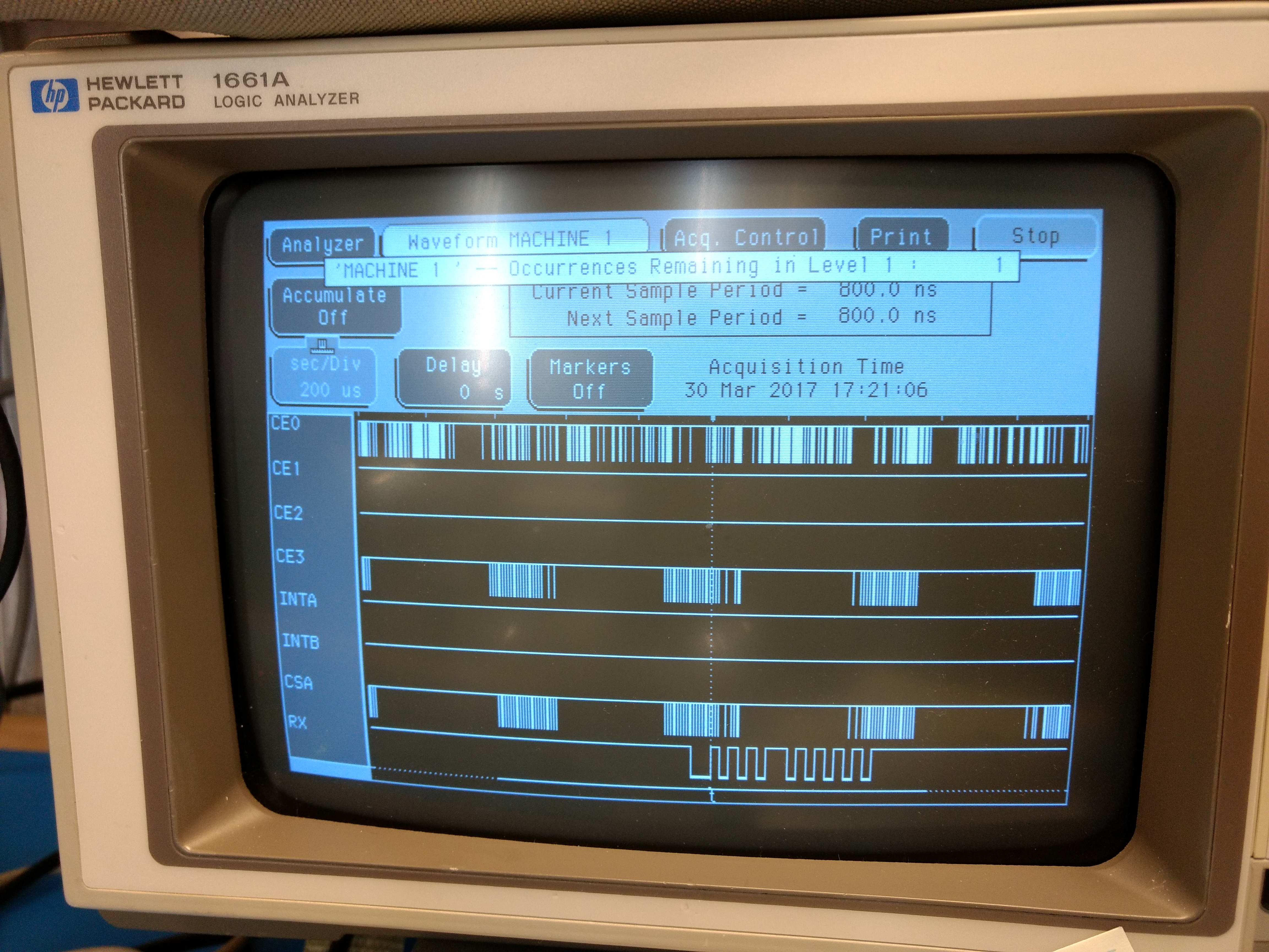

Hello TI  team,

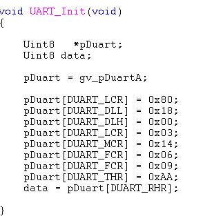

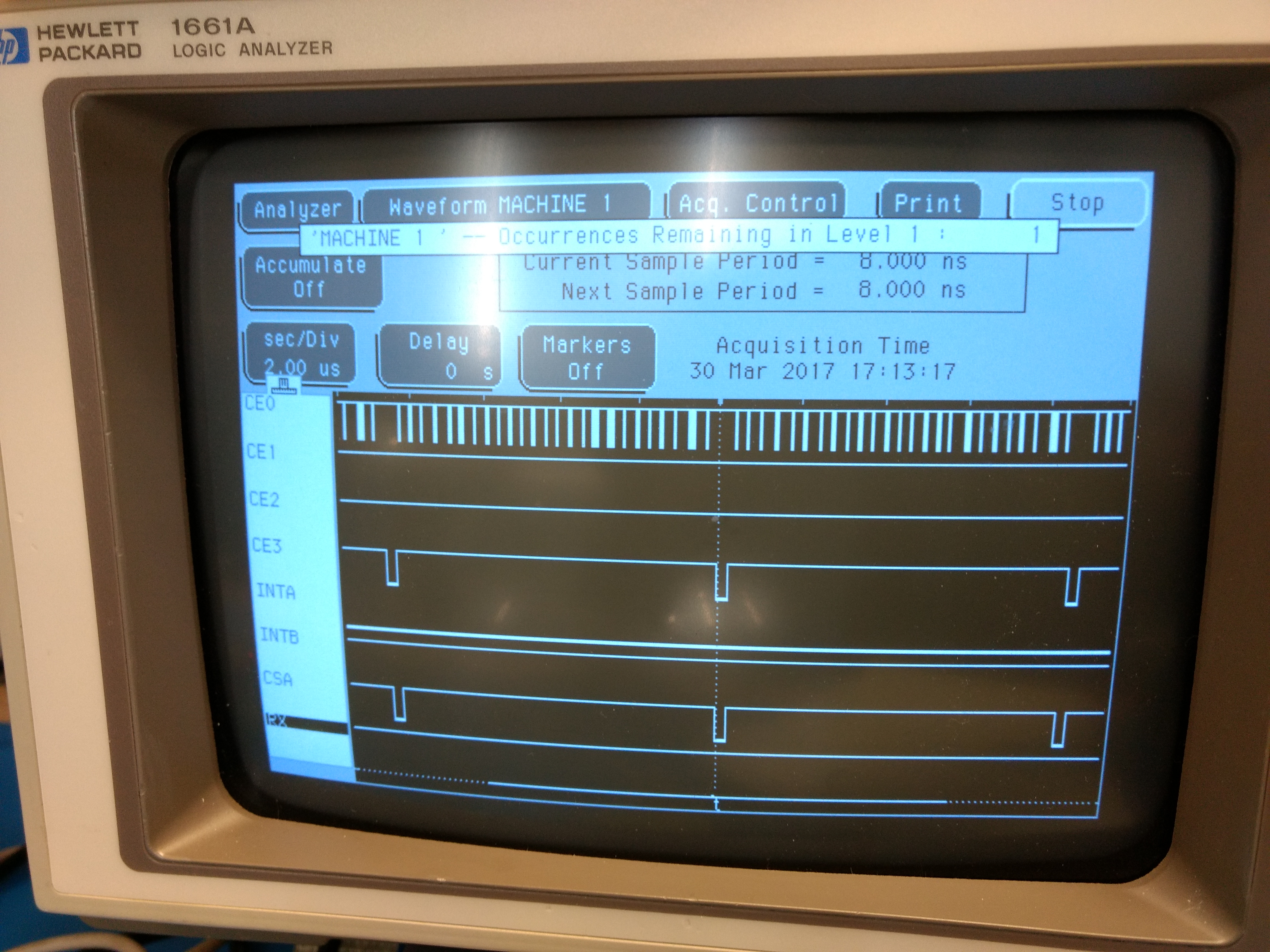

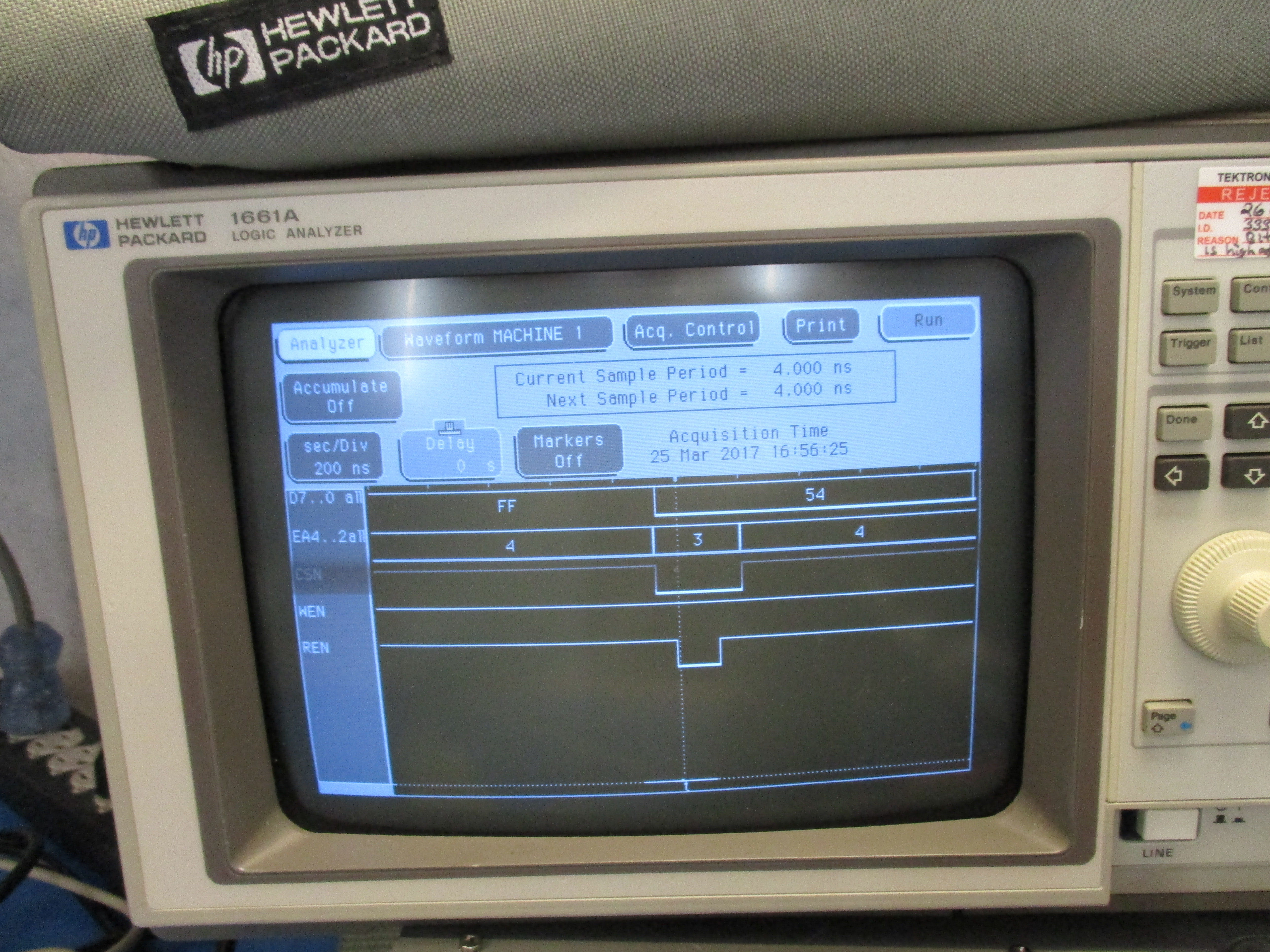

TL16C752C DUART A has been mapped with C6711 DSP and DUART chip has been configured for 38400 baud rate, 1 stop bit, parity as None. It has also been configured in FIFO mode. I am transmitting some dummy data from PC to test the communication. LSR register is updating that DUART has received some data in its Rx Buffer but RHR register is always providing the data as 0 (decimal).
We have tracked Chip select pin for UART A with oscilloscope also and it is working fine.
Another update is that - This is the legacy system and previously we were using TL16C752B part and code is working well for this part.
Please update at the earliest.

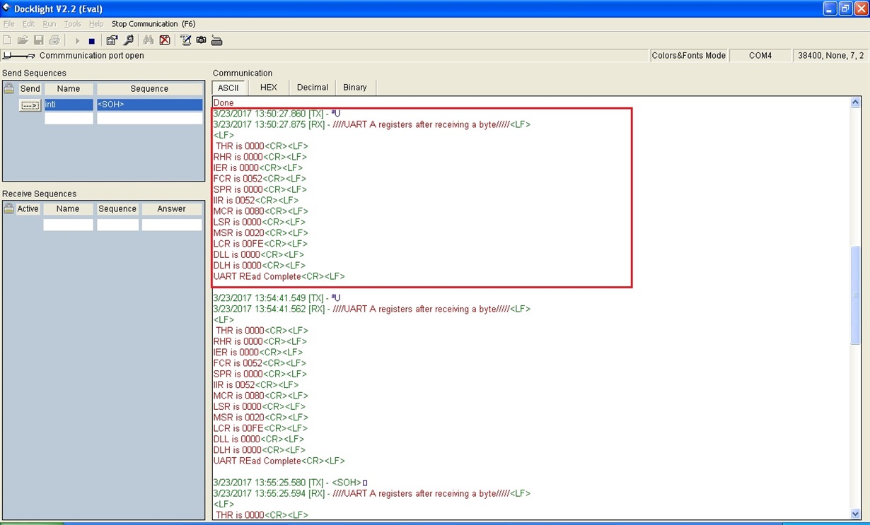

  • My FW engineer stepped out I am the EE. We are using +3.3V at it is ok at the part. I have an external crystal this is at a stable 14.7456MHz.
    We are using a PC to send TX data into the Device. I have a test wire at pin 5 and see our data there. When the SW engineer sees the LSR Register, LSR register provides value as 0x61 which updates that data is present in Rx FIFO and there is no any parity, overflow and framing error. When he reads the RHR register it provides only 0's... He sent in nine bytes and he detected 9 bits received each time the register indicated data was there.
    Data can be transmitted out of the DUART when it comes from the Parallel port side of the DUART.. so we believe that side of the DUART is functioning.
    We are working with channel A and B, channel A we use to program the DSP and channel B is interfaced with Bluetooth module.
    We have an external Reset signal at pin 36. It is stable and is produced by a supervisor chip.
    I believe my FW engineer looked at the posted errata, and believes this errata is not causing this problem.
    We previously used TL16C752B with no problems..

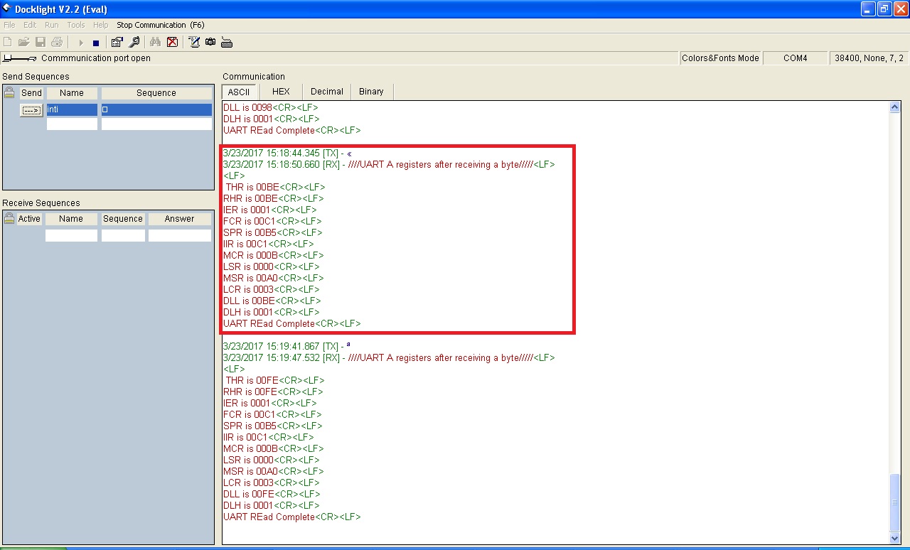

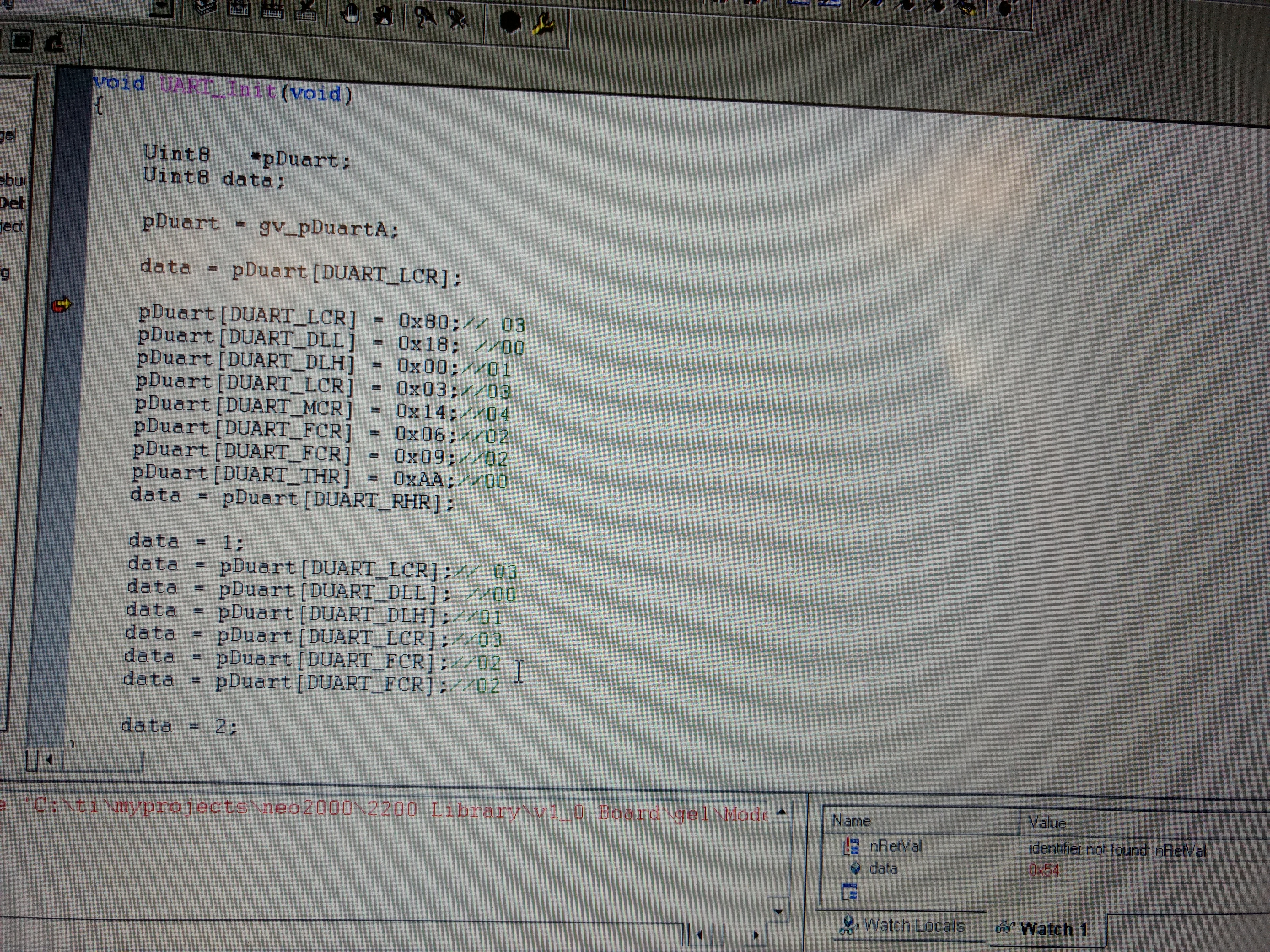

  • Tom thanks for your feedback.
    I can to understand that the CHA and CHB are working like receiver and both UARTs are programed as the same way.
    So please, Can you please explain how you program the baud rate?
    Can you confirm if the registers DLL and DLH have the value that you programed before and after the communication?
    Can you confirm if the reset pin is in low level?
    Can you please add an extra reset before of the communication?
    Can you send the value of the LCR register?
    Which is the value of the prescaler?
    Do you have this device in a socket?
    I asked these questions to understand better the issue and give you the best recommendation.
    Francisco
  • Dear Francisco,
    From Tom...
    The IC is soldered to the board. The reset applied to the part is from a supervsior IC. Once power is good the reset is deasserted.
    We cannot apply a second reset without cycling power. The reset is active high
    I have included the Baud Rate function
    Prescaler value is 1.
    I will confirm the values of DLL, DLH and LCR registers later and update you.

    byVal = pDuart[DUART_LCR];
    pDuart[DUART_LCR] = 0x80;
    // Set the divisor
    pDuart[DUART_DLL] = byDivisorL;
    pDuart[DUART_DLH] = byDivisorH;
    // Go back to normal operation
    pDuart[DUART_LCR] = byVal & ~0x80;
    // Good operation
    return TRUE;
    } // end UART_SetBaud

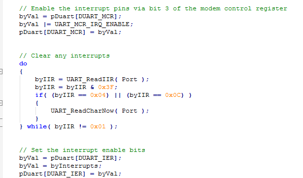

  • UART.c
    #include <stdio.h>
    #include <std.h>
    #include <csl.h>
    #include "UART.h"

    	// Access the clock rate divisor
    	// Set the divisor
    	// Good operation
    	return TRUE;

    // Function:	UART_EnableInterrupts
    // Description:	Enables the UART interrupt line for the given interrupt(s).
    // Parameters:	Port [in] - The UART port to use
    //				bRx [in] - TRUE turns on receive interrupts
    //				bTx [in] - TRUE turns on transmit interrupts
    //				bRxStatus [in] - TRUE turns on receive status interrupts
    //				bModemStatus [in] - TRUE turns on modem status interrupts
    // Returns:		None
    // Caveats:		None
    // Maintenance:
    // 09-26-06 RDM	Genesis
    void UART_EnableInterrupts( UART_PORT Port,
                                Bool bRx,
                                Bool bTx,
                                Bool bRxStatus,
                                Bool bModemStatus )
    	Uint8 byVal;
    	Uint8 *pDuart;
    	Uint8 byInterrupts;
    	Uint8 byIIR;
    	// Select the port
    	switch( Port )
    	case UART_A:
    		pDuart = gv_pDuartA;
    		break;
    	case UART_B:
    		pDuart = gv_pDuartB;
    		break;
    	default:
    		return;
    	// Set up the interrupt enable register bits
    	byInterrupts = 0x00;
    	if( bRx == TRUE )
    		byInterrupts |= UART_IER_RX;
    	if( bTx == TRUE )
    		byInterrupts |= UART_IER_TX;
    	if( bRxStatus == TRUE )
    		byInterrupts |= UART_IER_RX_STATUS;
    	if( bModemStatus == TRUE )
    		byInterrupts |= UART_IER_MODEM_STATUS;
    	// Did any interrupt turn on?
    	if( byInterrupts == 0x00 )
    		return;
    	// Enable the interrupt pins via bit 3 of the modem control register
    	byVal = pDuart[DUART_MCR];
    	byVal |= UART_MCR_IRQ_ENABLE;
    	pDuart[DUART_MCR] = byVal;
    	// Clear any interrupts
    	do
    		byIIR = UART_ReadIIR( Port );
    		byIIR = byIIR & 0x3F;
    		if( (byIIR == 0x04) || (byIIR == 0x0C) )
    			UART_ReadCharNow( Port );
    	} while( byIIR != 0x01 );
    	// Set the interrupt enable bits
    	byVal = pDuart[DUART_IER];
    	byVal = byInterrupts;
    	pDuart[DUART_IER] = byVal;
    } // end UART_EnableInterrupts

    I don't know if possible, but I would like to know if you can do an small test? this test will be using the loopback mode, in this mode you won't see the signal in Tx nor RX. You will send data in the same UART from TX to RX internally.
    The code is
    LCR (0x03) => 0x80 //Active the value of the divisor
    DLL (0x00) => 0x18 // low part, value for your boud rate 38
    DLH (0x01) => 0x00 // high part
    LCR (0x03) => 0x07 // No parity, 8 bits, 1 stop bit
    MCR (0x04) => 0x14 // Loopback mode enable and FIFORdy enable
    FCR (0x02) => 0x06 // Reset TX and RX FIFO
    FCR (0x02) => 0x09 // DMA mode enable and FIFO enable
    THR (0x00) => value // Value that you want to share
    RHR (0x00) => Read the value
    This activity will be in the UART A. Please test this one and let me know your feedback.
    Francisco
  • I have executed the same code to transmit 0xAA but I am receiving 0 only from RHR register. Attached image is the piece of code. I have also attached UART.h file which gives the indexes of all the DUART registers.
    AnujUART.h
    I read out the DUART configuration registers from both old Master board (with TL16C752B) and new Master board (with TL16C752C) using the same Source Code and the new DUART register values are not matching with old DUART register values. In new GDS board, I am configuring the DUART for 8 data bits, 1 stop bit and no parity but when I read the configuration register back, it updates configuration as 7 data bits, 2 stop bits and even parity.

  • Hello Francisco,
    I am the firmware engineer working on this project.
    We confirmed the voltage levels at Vcc pin, Rx and Tx pins and it is 3.3 volts. We also confirmed the reset line and it 0 V. I have attached "Rx data.jpg" image which displays the voltage level of Rx line.
    I also verified the LCR register value as you suggested and I read the value as 0x54. Below screens provides the code in debug mode and the value read out.
    Same we verified with logic analyzer and following is the screen:
    Above image also updates on IOR, IOW, Data Lines, address Lines and Chip select lines.
    Another update on this issue is - As I told we have old working board with TL16C752B  part so we swapped the TL16C752B part on Old Board with another new TL16C752C part and the old Board is receiving and transmitting the data perfectly. Even I executed this loop back test code with old board (with TL16C752C DUART part) and this test is also passed.
    Anuj
  • Hello Anuj
    For the value of the register, it looks like doesn't work well, but for your signals, it looks like is working.

  • Hello Francisco,
    We have not yet tested the version D part but today I tested version C part with respect to interrupt line and following is my test case and result:
    Case 1: Receive Interrupt is not enabled and reading the IIR register in while loop until Interrupt is cleared
    Below image displays the Code which is the part of UART.c file which we shared previously:
    Result:
    Rx line is always high
    Interrupt A line is always low
    Chip select line is going low as per functionality
    IIR register returns value as 0x3B (not sure what it depicts) and the interrupt is never getting cleared so not coming out if while loop.
    Below is the logic analyzer image which displays Rx line as "RX", chip select line as "CSA" and Interrupt line as "INT A". I also traced CE0 - Interfaced to SDRAM, CE1 - Interfaced to Flash, CE2 - Interfaced to FPGA, CE3 - Interfaced to FPGA which generated CSA signal and CSA signal is input to DUART chip.
    Case 2:
    In continuation of case 1, transmitting the data continuously through PC,
    Result:
    IIR register is returning the same value 0x3B.
    Rx line is displaying the data transmitted through PC.
    Interrupt line is always low.
    Case 3:
    Enabled the receive interrupt and then reading the IIR register in while loop until interrupt is cleared
    Below image displays the code:
    Result:
    RX line displays the data sent by PC
    Interrupt is high
    IIR register is providing the same value 0x3B and interrupt is never getting cleared so not coming out of while loop.
    Below is the logic analyzer image:
    Please check and analyze the values of IIR register mentioned in above cases.
    Anuj

  • Hello Francisco,
    Following is summary of EMIF interfaces with DSP C6711:
    SDRAM has been mapped at 0x8000 0000 address same as old system, ECLCKOUT is 100 MHZ
    Flash has been mapped at 0x9000 0000 address same as old system
    FPGA has been mapped at 0xA000 0000 address same as old system
    DUART has been mapped at 0xB000 0000 address same as old system.
    DSP's CLKIN is 150 MHz.
    I was debugging further this morning on this issue and I am looking at the memory address 0xB000 0000 to know about the values of DUART registers using the "View Memory" option of Code Composer Studio 3.0 IDE . I was executing the loop back code line by line using the breakpoints. Initially Loop back code writes the 0x80 value in LCR register and I can see this values is getting written at 4th Byte of 0xB000 0000 address location. Then after writing DLL and DLH in loop back test code, LCR is written with 0x03 and this 0x03 has also been written successfully at 4th Byte of 0xB000 0000 location. After this step, MCR is getting updated with 0x14 value. I verified the 0xB000 0000 address location again just after writing the 0x14 value in MCR and LCR value is completely changed from 0x03 to some other value.
    I executed the above test code with old DUART part on old system and this LCR value corruption is not happening there. Can you please suggest something helpful by this test case results.
    When I executed above test case, initially i was able to debug the code but later debugging is not taking place. Debugging is never appearing to main() function. Debugging is taking place on old system with same Source Code and same Gel file. Would you please assist on this also.
    Anuj
