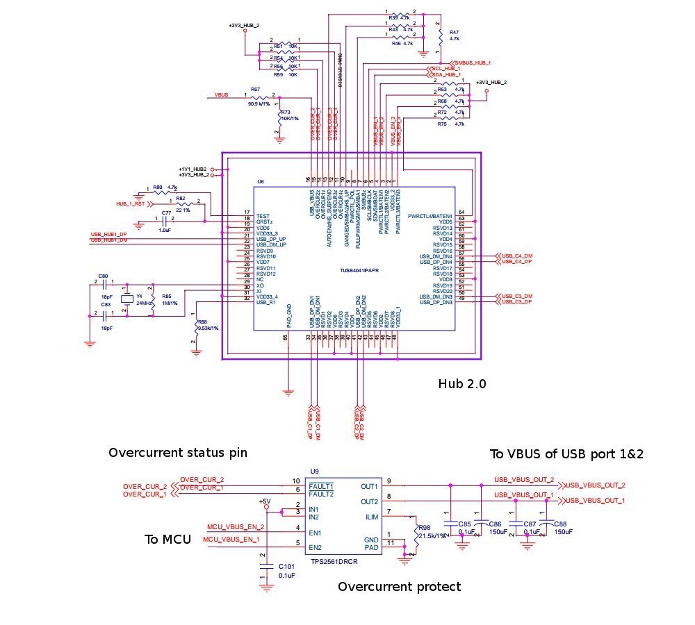

Hi all,
I am facing a problem with TUSB4041I, when I plugged a shorted cable to a USB port, the BATEN pin of this will be 0, and I couldn't enable charge when I plugged a good cable until I reset HUB. (protect IC is: TPS2561DRCR)
But before when i had used TUSB8041, when plugged a shorted cable the BATEN pin of this will be 1. The USB port could charge right after i unplugged a shorted cable, and plugged good cable + phone.
The difference of this because TUSB4041I behavior or my schematic is wrong? Please give me some advice.

    When you say "shorted cable", do you mean a short between VBUS and GND? If so, then PWRCTL#/BATEN going low is the expected behavior because you will be generating an over-current condition.

    TUSB4041 connected to a "main hub",  and this "main hub" connect to a PC. You're correct about "shorted cable".  When BATEN = 0 after shorted, I couldn't set BATEN = 1 again, although I used SMBUS wrote 0x0F to  Reg06 of  TUSB4041. How can I activate USB port after shorted but needn't reset HUB, or power off and on again?
    I attached a schematic.
    And below schematic i remove EN1, EN2 of TPS2561 from HUB (only control by MCU, EN is always high), because I want USB port can ready right after shorted cable is unplugged. But when I use this some time my USB port is died (only charge device, couldn't recognize device  from PC  ever).
    Best Regards.
    When you short VBUS to GND on the USB connector the OVRCUR# input on the TUSB4041 is driven low indicating an over-current condition and thus the TUSB4041 will "de-assert" PWRON#/BATEN.
    After this, only the USB Host is able to clear the over-current "flag" on the hub, this is the expected behavior required by the USB spec.
    You need to connect the tUSB4041 to a USB Host and remove the over-current condition so the USB Host send the instruction to the TUSB4041 to "assert" the PWRON#/BATEN signal again.
  • Hi Elias Villegas,
    Thank you very much about this, and what about the second circuit, when I only connect pin EN of TPS2561 to MCU, and the port of hub is died, can't detect device any more.
    Phien nguyen
  • If the OVRCUR# input is being asserted low, then it will happen the same.
    In order to isolate the power switch from the Hub you will have to disconnect both the PWRON# and OVRCUR# signals.
    If you are going to control the power switches with the MCU, You will have to report to the Host that the Hub does NOT support power management (FULLPWRMGMT#=high) in order to pass USB compliance tests.
