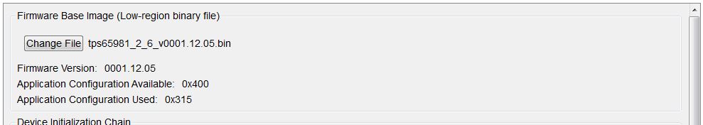

Hi daniel,
Can you update your low region file to the latest version of the FW?
Here is the latest FW version attached: tps65981_2_6_v0001.12.05.bin
Thank you,
Eric

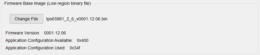

Dear Eric,
Thanks for your advice, V3.10 Configuration tool can pass USBCV billboard.
I found the Low-region binary file of V3.10 Configuration tool is v0001.12.06, which is newer than v0001.12.05. Is this the root cause to solve billboard test?
Additionally, can we test billboard function on laptop which support DP? because the desktop PC can pass USBCV billboard test.
But USBCV would show no device found when laptop detect.
