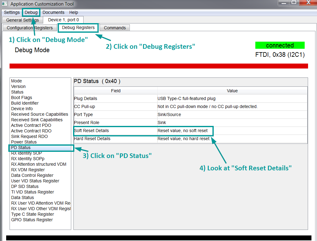

I wanna set TPS65986EVM to be a DRP which send signal to monitor from device via EXPANSION board and provide power to device .
Attached is a FW which I use.

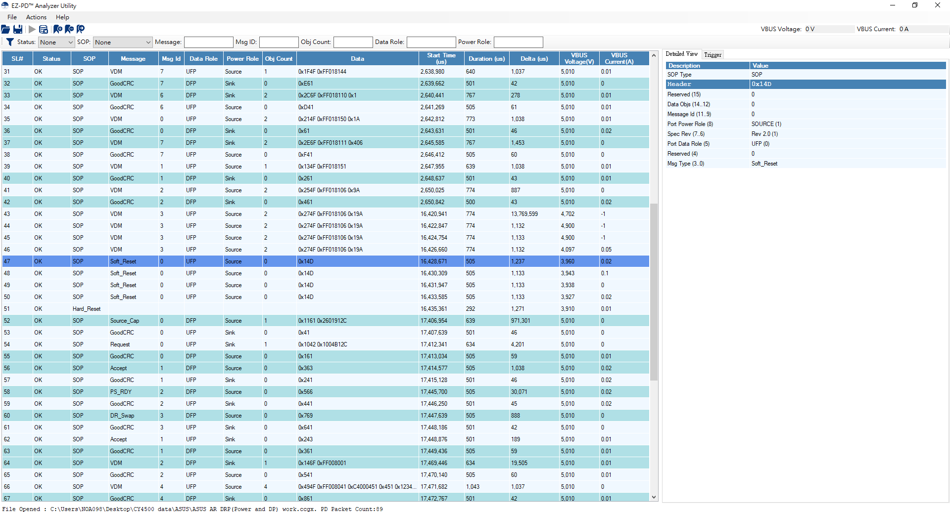

It can work on LG G5, but it fail on ASUS Zenfone AR. I use Type-C analyzer to capture some log, and I found it always soft reset.
Joshua
DRP-Ver20180103.pjt
  • Hi Joshua,
    Welcome to E2E! You're in luck, on the Application Customization Tool (During Debug mode) there's a register called PD status. This register will tell you the details on what's causing the soft reset (look below for a screenshot). Load the TPS65986 template on the GUI ==> Flash the firmware onto the device ==> After flashed, click on Debug Mode ==>  Click on Debug Registers ==> Click on PD Status ==> Look at the Soft Reset Details. FYI, make sure the device is connected to your laptop during debug mode.
    Also, it might be useful to take a look at our Host Interface Technical Reference Manual which can be found here: http://www.ti.com/lit/ug/slvuan1a/slvuan1a.pdf . This guide goes over all the registers and values for our TPS65981/2/6 PD controllers.

  • Hi Aramis:
    Thanks for reply.
    I followed your instruction and Soft Reset Details showed "tps6598 soft reset sent after retries were exhausted".
    What is this mean?
    How should I resolve?
    Joshua
  • Hi  Joshua,
    It seems that the PD controller is trying to ask for a Vendor ID but the Asus Zenfone isn't communicating one per your log above. This might be an issue with the PD controller in the Asus system.
