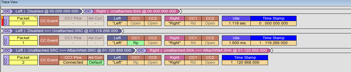

The first picture is the handshake protocol when NOTEBOOK power on,and the second picture is the handshake protocol when BOTEBOOK power off.

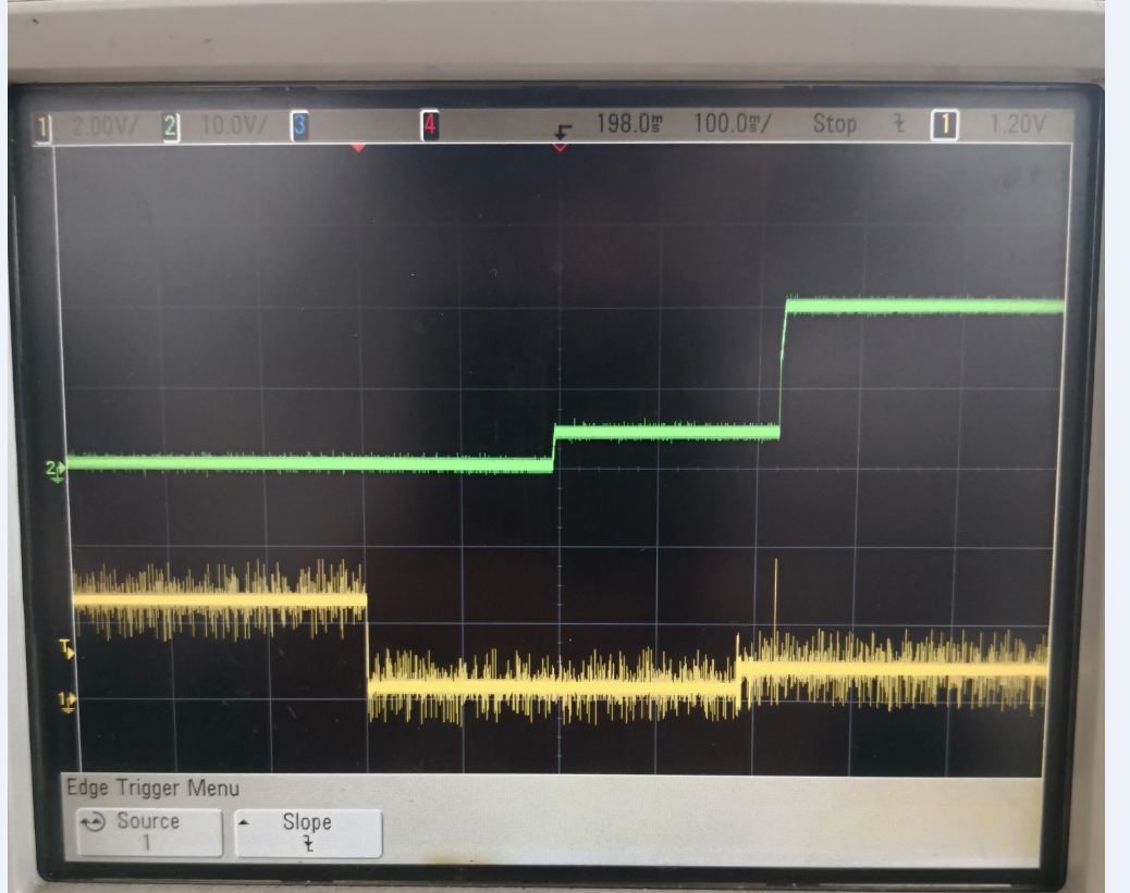

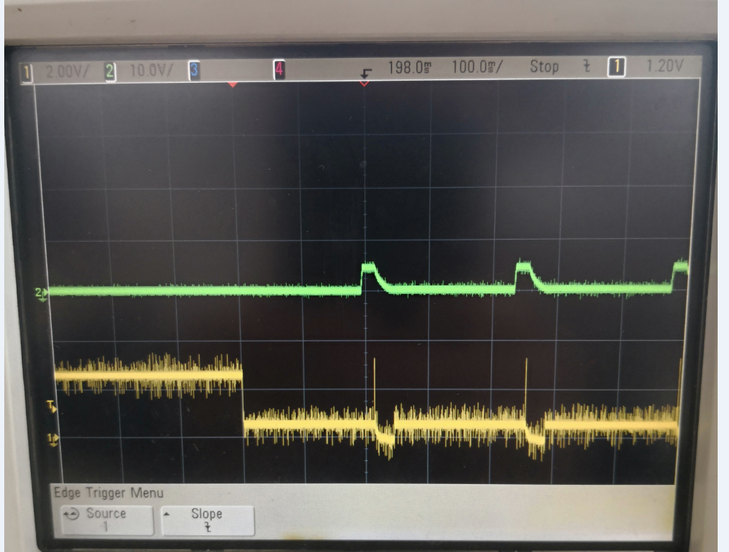

    The first sequence diagram is collected when NOTEBOOK is power on,and the second sequence diagram is collected when NOTEBOOK is power off.
    I have find a strange phenomenon yesterday : Give a short time 5V power to VBUS line,the adapter can also charge NOTEBOOK when it is power off.
    Yellow - CC        Green - VBUS.

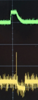

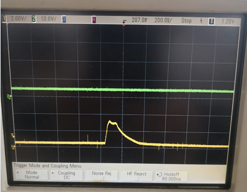

  • Hi Huazi,
    In the notebook off scope capture, can you zoom in on the CC line?
    It is possible that the notebook does not have Rp when first plugged in and the TPS25740 deglitch time on the CC is too fast and thus never sees an attachment.

    The CC line status shows in the following pictures.
    Huazi
  • Hi Huazi,
    It does look like the debounce time of the TPS25740 is too short and is causing the issue. We have seen similar issues with the TPS25740 when used with a TPD8S300. The TPD8S300 will remove the dead battery resistors for a short time (about 400 us) and the TPS25740 sees this as a disconnect due it's short debounce time. Unfortunately there is no fix for the TPS25740 but you could try the TPS25740B which has a longer debounce time. I can ship you and EVM so you can try and see if it charges please email me if you want to try this (d-porter1@ti.com). The TPS25740B will advertise 5, 9, 15, and 20 V though which I know you only need 5 and 20 V.

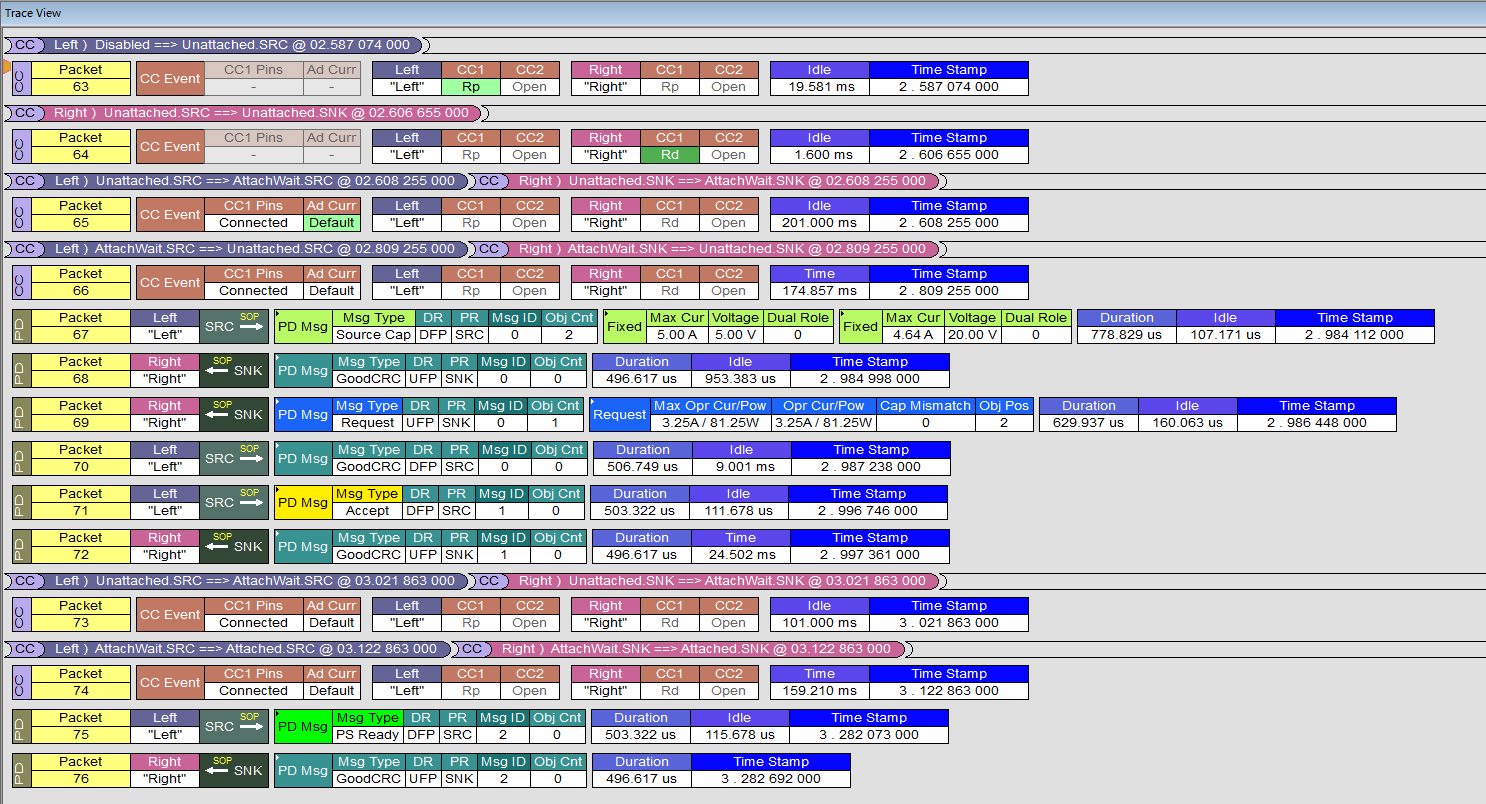

    Could you also post shots of the original adapter working and/or the adapter with the TPS65982 please?
