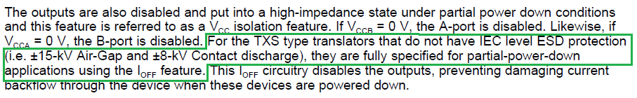

    By the way, according to the data sheet of TXS0101 and TXS0102 these parts support the partial power-down mode.
    In addition, it seems that TXS0104E supports it in the following application report.
    So, could you please double check it ?
    http://www.ti.com/lit/an/scea044/scea044.pdf

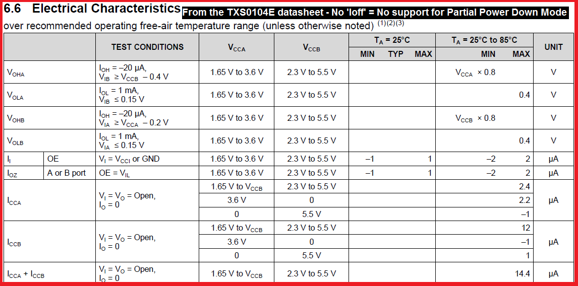

    I am sure that the TXS0104E does not support Ioff. I went through the design database to make sure.
    Also, shown below is a portion of the application note that you mentioned. It states that Ioff is supported in TXS devices that do not have IEC level ESD protection. The TXS0104E does have IEC level ESD protection, so therefore it does not support Ioff.
    From the application note (SCEA044):
    From the TXS0104E datasheet:

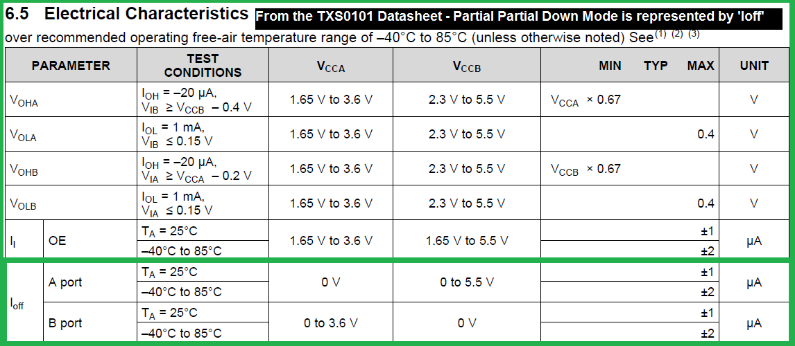

  • Sadanori,
    In the future, you can use this post to determine if a Level Translator supports Partial Power Down Mode.
    Check the Electrical Characteristics section of the datasheet for the parameter 'Ioff'. If it exists, then the device supports Partial Power Down Mode.
    For example, shown below is a portion of the TXS0101 datasheet. Since it lists 'Ioff', it therefore supports Partial Power Down Mode:
    Now look at the TXS0104E datasheet, notice that there is no 'Ioff'. This means that Partial Power Down Mode is not supported.
    Hope this helps you out in the future. Thanks.
