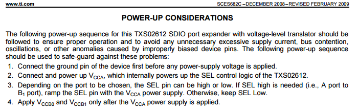

For TXS02612, I have provided a jumper option for select pin. Can I hotswap SDcard by not selecting the port B1 by SEL pin?
Do I need to disable the power to port B1 while hotswapping?  Schematics is given below.
Also, Will TXS02612 support UHS-1 speed? (Normal case level shift from 1.8V to 3.3V and if UHS-1 is detected use 1.8V on both sides)

    In your case, you want to hot swap the card by not selecting the SEL pin to be high; yes, it can be done in this fashion. If SEL is left floating, then the internal circuitry will pull all of your CMD and DATA lines high through 70K resistors and pull the clock signal low. Internal defaults set like this are functioning akin to the second recommended setup for handling multiple SD devices. In this case however, both devices will be disabled since neither will receive a clock. When you are ready to jumper the SEL pin, if you pull it high, the SD card you inserted in port B1 will receive the multiplexed clock and become active. If you pull SEL low, then the WiFi module on port B0 will receive the multiplexed clock and it will become active.
    Operating this chip in the method you intend to, you shouldn’t have to disable power to the B1 port while conducting a hot swap. However, make sure that you follow the “Power-Up Considerations” on the 15th page of the datasheet for proper functionality.
