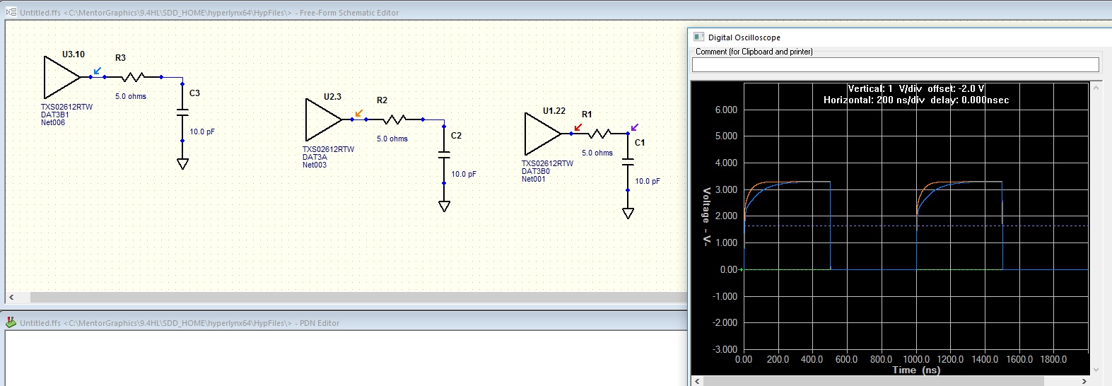

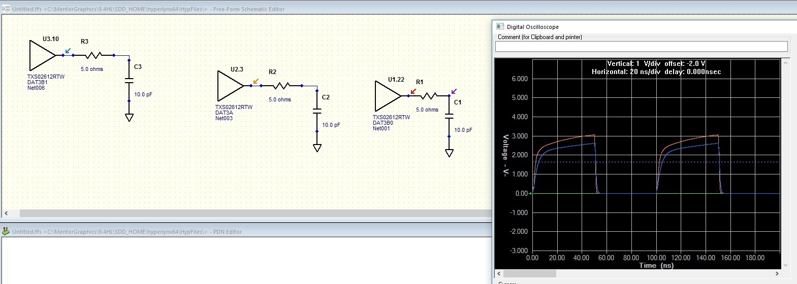

  • Wang ,
    I simulated the IBIS model here as attached. The A to B0 and the A to B1 shows capacitive loading but B to A didn't show similar behavior.
    The snapshot shows the simulation done at 5 ohm R and 10pF loading, 1Mhz frequency.
  • attachment below shows the same IO behaviour for 10Mhz frequency , note the loading effect on the IO channels which cannot reach the full 3.3V range.
  • Dear Shreyas
    thank you , it is clear now for me !! but where does this 5 OHM 10PF come from ? you see that in my simulation , there is no PCB , no components , only TXS02612 , even more , the soldered line is short .
    in my simulation setup , the B0 is floating .
    thank you very much ~~
  • Dear Wang If you look in the datasheet of the device, the Cio for the A port is 7.5pf max and 10pF max for the B port.
    The wires will also add distributed cap loading however short it is.
