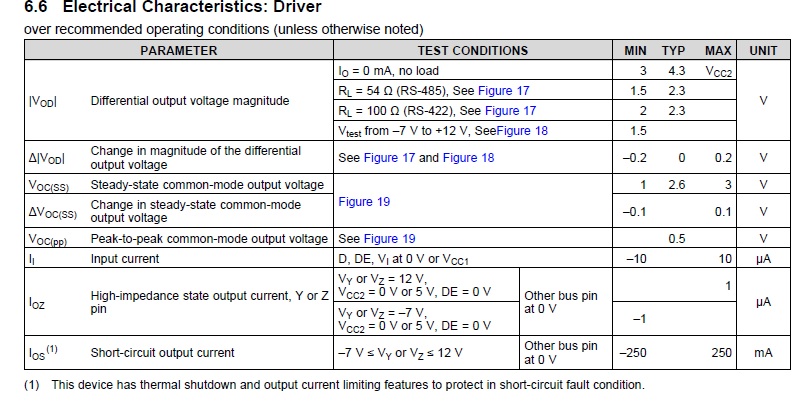

    We are driving ISO3086T TI Chip. From the datasheet of ISO3086T the drive current on D , R ,DE,RE are 10uA.
    Can you please confirm this so that we can close this case ?
  • Ram,
    I think TXB is good to use in your case since the leakage is under the rated load current supported by the TXB.
