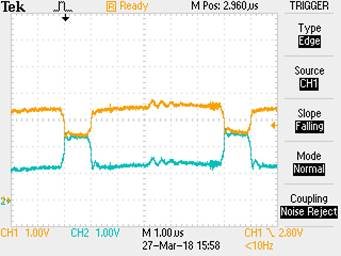

R1 = 120 Ohm / R2 = 120 Ohm @ 1Mbps test fail. CH1 and CH2 is CANH and CANL
R1 = 100 Ohm / R2 = 100 Ohm @ 1Mbps test fail. CH1 is ISO1050 Rx. CH3 and CH2 is CANH and CANL.
R1 = 60 Ohm / R2 = Open @ 1Mbps test Pass. CH1 is ISO1050 Rx. CH3 and CH2 is CANH and CANL.

    In Figure 1: (Scope shot): R1 = R2 = 120ohms;   in dominant CANH = ~3.4V, CANL =  1.2V and Vod = CANH - CANL = 2.2V; this is typical and healthy swing for a dominant bit. In recessive state, both CANH and CANL should be similar and they are around  2.4V. Again,  the amplitude levels are all within spec, so I am trying to better understand the fail classification.
    Scope shot 2:  R1 = 100ohm, R2 = 100ohm;  Again I see healthy amplitude levels for both dominant and recessive states. Further, the RX output is faithfully following the CAN bus and is correctly reporting Recessive (RX = high; CANH - CANL = ~0) and Dominant (RX = low; CANH - CANL > 1.5V). so, just like above, any info here on why this is classified as a fail ?
    Scope shot 3:  R = 60ohms; R2= open;  this is  also similar to above.  Signal level is OK for both states (Dominant and Recessive) and RX output is following what it sees on the CAN bus.

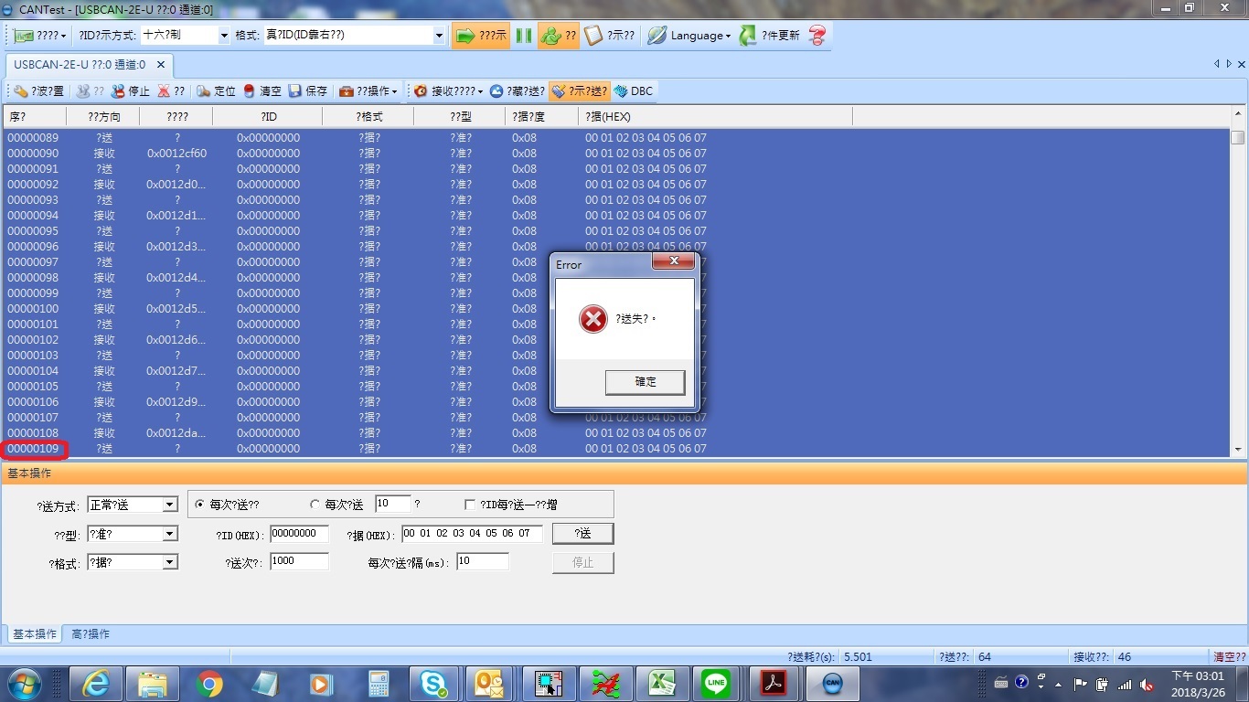

    3. I can not change duty cycle from USBCAN-2E-U and please kindly reference the test results from USBCAN-2E-U tool.
    Test Fail
    Test Pass

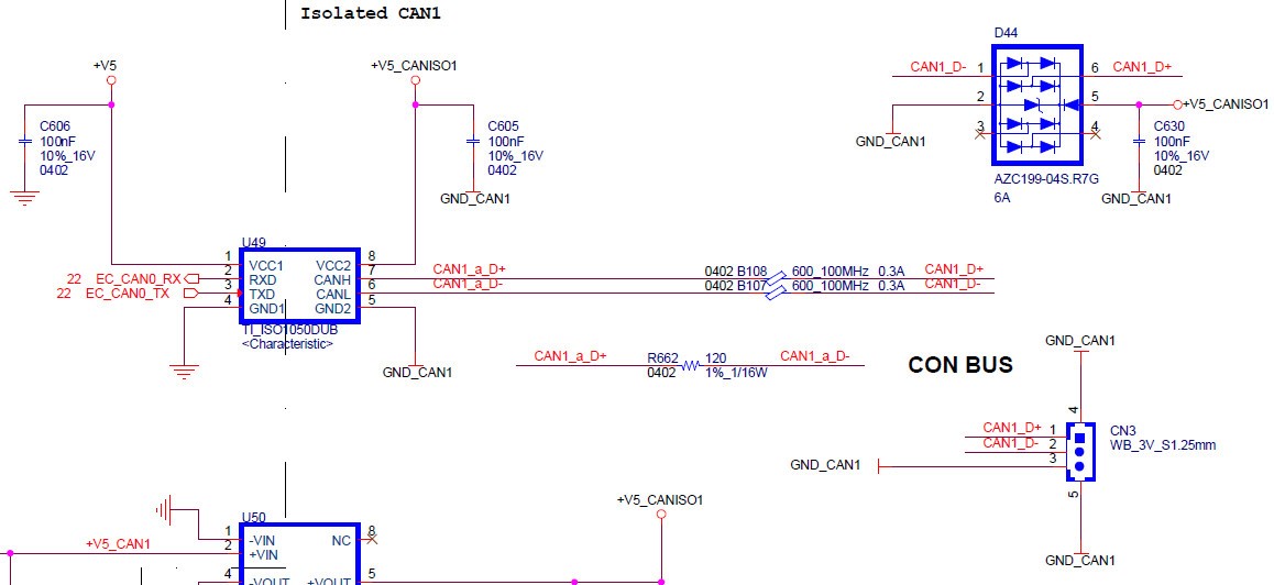

    4. Please reference schematic on below.

    1) I apologize that I couldn't fully understand the settings in the software screenshot since it is mainly in Chinese , but overall is it correct to say that the software settings are the same between pass and failing test, and the only difference is termination ?

    4) Are B107, B108 Ferrite Beads with 600 ohm impedance @ 100MHz ? Can you please remove the beads and TVS (just for debug) and put R1 = R2 = 120ohms and repeat the test if possible ? This will provide useful information on timing.

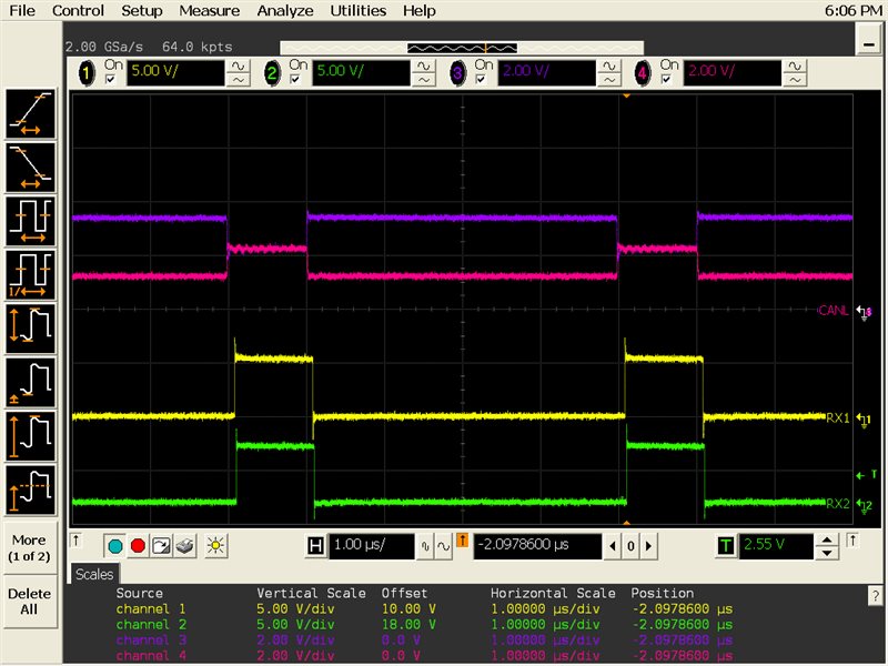

    3. ISO1050 side
    USBCAN side
    4. We have already removed B107 / B108 and D44.

    - Scope shots: The bit level amplitude and timing looks healthy, both at ISO1050 side and also on USBCAN side.
    So perhaps some issue is going on at the __frame__ level ? To analyze this:
    (a) we will likely have to zoom out in the scope and try to get at least 29 bits of data, and see if there are any missed bits in the frame.
    (b) When we do the above, we may have to get two set of scope shots,:
    - TX, RX, CANH, CANL with 29 bits on ISO1050 side
    - same as above on the USBCAN side.
    Again, thank you for your patience as we work together to debug this issue.

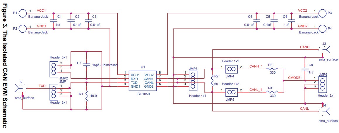

    Good day. Can I ask another question about ISO1050 EVM schematic? Why is the EVM put 60 Ohm termination resistor. Thanks~
  • Dear AJ,
    In a real CAN network, we expect the two end  CAN nodes  to be terminated with 120 ohm resistor each to match the cable impedance. Two 120 ohms in parallel will give us an effective impedance of  60ohms.
    On an EVM , since we have only one node ( = one transceiver), we directly use the effective impedance of 60ohms as a standard load.
    This is also consistent with the CAN standard and CAN datasheets, where 60 ohms is used a standard value when measuring just one CAN transceiver.
    I hope this helps.
    Abhi

    Good day. We provide video record on below for you reference. Is it likely to be a matter of compatibility problem? If any suggestion please kindly let me know. Thanks~
    R1 = 120 Ohm / R2 = 120 : 0:03 second is start transmission and 0:19 second got fail.
    R1 = 100 Ohm / R2 = 100 : 0:04 second is start transmission and 0:06 second got fail.
  • Dear AJ,
    Thank you posting this. On Friday and today, we have been in email and phone discussions with our Field team there to look at this. I am re-posting some of that here for convenience.
    There is a possibility of the USB2CAN module doing something here, so compatibility could indeed be a factor. We saw the videos and in the beginning, the scope shot looks OK, but only later do we see the bits getting affected and moving around.  This may be due to interference, or even the software trying to do something in the middle of transmission. **if** this was a hardware issue, we would have seen ***all ** bits getting affected and not only some in the middle.

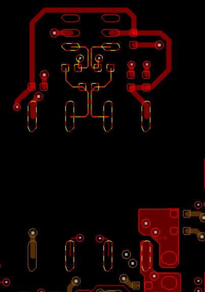

    If possible, please kindly help me to confirm if layout needs improvement. Thanks for help~

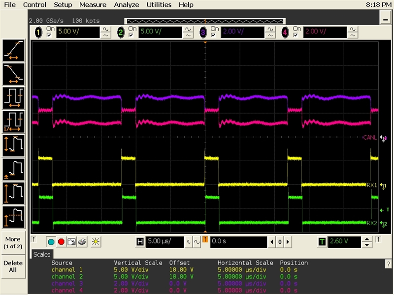

    Also, for completeness, I wanted to share an additional scope shot (courtesy Daniel Kisling; thanks Dan).
    This is with two ISO1050 EVMs, 120ohms on each side and separated by 20m cable with a lot of stubs (= unterminated sections) in between to deliberately make this a difficult test. Device 1 transmitting and listening and Device 2 listening. As you can see,  there is small noise (due to stubs), but despite this, the ISO1050 has no issues communicating.
    This addresses the termination side of the question as well as the cable length.
    Purple = CANH,
    Red/pink = CANL
    Yellow = RX1  (receiver output on device 1)
    Green = RX2  ( receiver output on device 2)
    This data leads us to believe that there may be a USB2CAN related issue or a software config issue.
    We can double confirm this when you can also test with two ISO1050s.

    3) Video : sent you feedback over email. Essentially - appears to be error frames being sent in the middle. Maybe a controller config (software issue), because if this were to be a hardware issue, then you will see this in every few bits and not just in the middle.
    4) Layout: Hard to review like this in general (best done over a call , selecting layers , traces and components) but in general , we can recommend the following:
    • supply and ground planes are clean
    • Decoupling caps (100nF) is placed as closed to the device as possible, including paying attention to the VIAs between power  and ground planes. (Vcc1-Gnd1; Vcc2-Gnd2)
    • CANH and CANL lines/traces are roughly equal/symmetric
    • CANH, CANL lines are not routed next to high-speed switching lines from Micro (can cause interference).
    Doing the tests you plan to do with PCB, EVM and USB2CAN module is a good idea.
