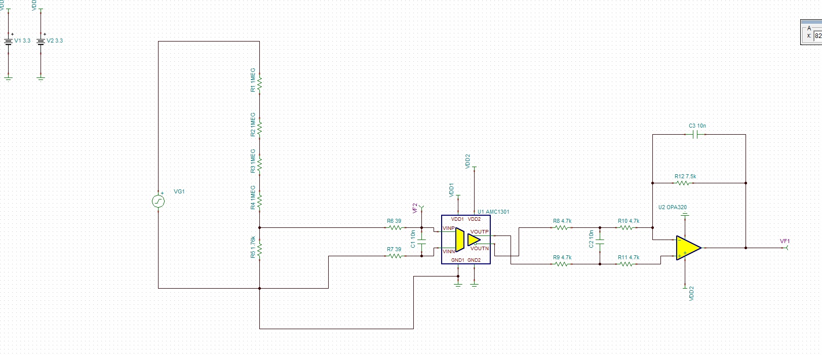

    i did a simulation using TINA for the reinforced amc1301 circuit that is in tidubx1b.pdf
    for sensing the DC bus input voltage.
    i wanted to sense a 566 AC volts with 50 hz frequency
    and i got the following results
    the peak value of the input signal is 322mv
    and the minimum value is -124mv
    and  the output of the opamp was clamped at the maximum and not a full sin wave
    i expected to see +/- 250mv at the input  and a full sine wave at the output i tried of biasing the input but the output was still clamped ,do you have any idea why?  how to correct the circuit in order to utilize the range of the 250mv input  566volt main line sense1.TSC
    i attached the Tina design

    Are you calculating the 322mV peak and -124mV minimum using the DC transfer characteristic?
    Using Analysis -> AC Analysis -> Calculate Nodal Voltages, I am seeing 224mV Amplitude and 186mVrms on the input.
    The output of the OPA320 should be 0 to 3V, correct?

    i attached a screen shot of the simulation
    as you can see the input is with 322mv max amplitude and -124mv   when i take the deference between this values  its about 340mv which is much higher than 250mv input swing of the device this is one problem
    and the second one is this input sine wave is not centered around 0v
    from the resistor divider network at the input should be 250mv once there is 566v at the input line .
    and the out put op the opamp is clipped at the max peak of the output wave  , and yes the output should be between 0 and 3v cause i feed it to my ADC    e output of the opamp should be between 0 to 3v cause i feed to my adc
  • hii i also attached the schematic that shows the resistor network that i use at the input
    by voltage division if there is 566 VAC by phase i should sense 250mv
    and this is not happening in the simulation the amplitude  as i mentioned above 322mv and -124mv
    and i suspect that is whats causing the clipping at the output on the op amp.
  • 566volt main line sense1_AS.TSC
    Hello Aied,
    I believe the error is due to the AMC1301 bias current model. The AMC1301 has a typcal output bias current of 15uA on both VINP and VINN for a total of 30uA output bias current. I am unable to verify how much bias current the simulation model produces. If you look at the file I attached, the DC offset is mostly removed when I scale down the input resistance by a factor of 128. This is impractical for a real application due to thermal concerns of the resistors, but I thought it would help to at least simulate the OPA320 stage.
    I also added an additional resistor to the VINN trace to help minimize the DC offset. This configuration can be seen in figure 52. of the datasheet. Look at equation 1 in section 10.2.2.1 Design Requirements to see the gain error equation. Since the input impedance of the AMC1301 is low, when a comparably sized resistor is used for the shunt then it creates an additional resistor divider. Try to get the shunt resistance as low as possible if you are going to use the AMC1301 for voltage sensing. Considering an isolated amplifier for voltage sensing (AMC1311, ISO224) is another route to go as well if you are unable to perform system calibrations.
    I made a few changes to the OPA320 stage. I added VCM of 1.5V connected to the positive input terminal of the OPA320 which sets the common mode to 1.5V (halfway between 0 and 3V ADC input range) and changed the values of the feedback resistors to fit the fullscale range.  There seems to be some clipping on the negative side of the output swing (85.74mV) that is most likely due to the model. The OPA320 datasheet specifies less than 50mV for all cases of "Voltage output swing from both rails", so I am not sure why I am seeing 86mV. I do not support the OPA320, so I cannot speak to how accurate it's model is. Perhaps you can post to the amplifier forum and they will have an answer.
