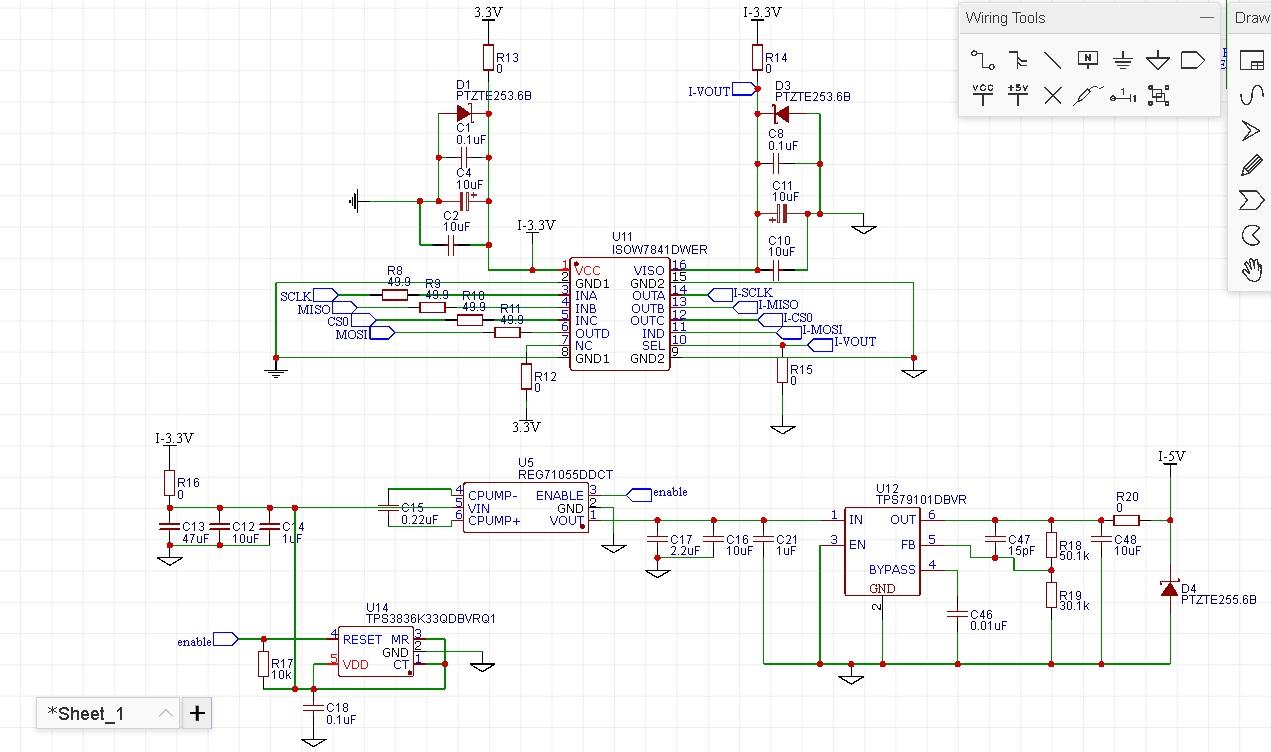

As refering to TI design TIDA 01214 i wired the data isolation as in the picture. Do you see any errors? Thanks a lot and regards
  • Hi Pierluigi,
    I do not see any glaring issues at first glace, but please allow me to review this with the team on Monday. What is the zener voltage of the diodes?
    Dan
  • Hi Dan,
    the diodes close to isow7841 should be 3.9V, D4 on the bottom 5.6V. In the software i used the right parts weren't available (diodes).
    Hope you guys can help me with pcb layout as well. Thanks a lot for your fast answer.

  • Hi Pier,
    I have a few notes after reviewing this with the team:
    1. C1 and C8 should be closes to the supply pins in the layout. The 10uF caps should be placed close to the device as well. They should be placed on the same plane as the device.
    2. Zener diodes look fine
    3. R12 is not needed. NC can be left floating. But it can be left as is in your schematic and will not cause an issue
    4. Current limiting resistors R8-R11 are fine. They can be implemented on side 2 of the isolator if you wish.
    5. Please refer to Section 11 of the ISOW datasheet titled "Power Supply Recommendations" and follow the recommendations accordingly.
    We would be happy to review the layout as well. You can either reply to this thread with the layout or start a new one.
    Please let me know if you have any questions.
    Dan
  • Ok!
    I will put those resistors and leave NC floating.

  • Hi Manuel and all team.
    Happy easter, and, please have a look at the img, for a confirmation.
    I fed 5V to the circuit as we said, added the 49ohms resistors. i had to stop few days cos too much work. hope this is finally right, Kind regards

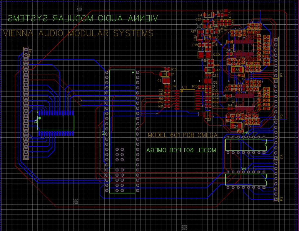

  • Hi Dan, i came out with this pcb design, hope is not too bad...
    i did post also the latest schematic
  • Hi Pier,
    Thank you for your warm wishes! I apologize for the delayed response. Regarding the schematic posted last Sunday, please confirm whether you would like the Viso output to be 3.3V or 5V. In the 3.3V case, SEL should be grounded or left floating instead of tied to Viso. If SEL is tied to Viso the output voltage will be 5V.

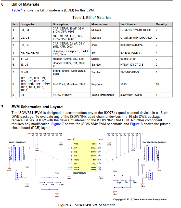

    A BOM of the ISOW7841 EVM is available on page 5 of the EVM User's Guide, and a copy of the table is shown below:
    Regarding the PCB layout, please place the smallest capacitors closest to the ISOW7841, meaning C1 closest to Vcc and C8 closest to Viso, with larger capacitors following in order of value.
    Although the EVM shows three capacitors on Vcc1 and Viso of the same values, if voltage transients are expected in your system where Vcc would drop below 2.7V, an additional 100uF capacitor on Vcc (pin 1) is strongly recommended for reliable operation.
    I noticed there is a connection between Pin 1 of the ISOW7841 and R14 on the PCB. This connection is not necessary since Viso is a sourcing pin, meaning that power will flow out and if an additional supply is connected there may be damage. There is also no visible isolation between grounds in this configuration, is isolation only required on the data lines?

  • Hi Manuel, thanks for your time
    So , not bad for a guitarist eh? ;-)
    "A BOM of the ISOW7841 EVM is available on page 5 of the EVM User's Guide, and a copy of the table is shown below:"
    Thank you, but i didn't get the design from the evm but from TIDA-01214, something missing there..

  • Hi Pier,
    I was just discussing this thread with Manuel in the office. I just wanted to emphasize that GND1 and GND2 should not be connected and Vcc and VISO should not be connected. Shorting GND1 to GND2 will not damage the device - but will essentially mean you have no isolation. And why are you using an isolation part if you do not need isolation?
    Take a look at the ISOW7841 EVM layout:
    Notice how there is a gap between the two sides of the device. There are no traces between the two sides of the device. This is what we need to consider on your layout. There needs to be a clear boundary - free of any conductive materials (traces, other components, etc.) - between the two sides of the device to isolate one side from the other.
    Dan
  • Hi Dan,
    this is really interesting. For what i could understand, using ads8668 in the perfect scenario would mean that grounds are separated, at half level of the ADC chips ( as shown in ADS8668 datasheet at page 70) .
    I've already done that layout (with separated grounds), painful, but the ADC department told me to followe the TIDA design i mentioned and that is better to have a single ground plane for the whole board, as also written in page 69.
    In the latest layout there is only one ground, coming from the first board . is named AGND as on the other board
    I've been talking with Dale li for the setup of ADS8668. i tried to keep all other ics on bottom layer also for this reason.
    I think doing what you say is possible on the top layer, but i still don't understand how (in ads8668 datasheet) what is written in page 67 and 69-70 comes together in reality...
    Please help :-D

    My apologies! A copy of the TI Design BOM is on the TIDA-01214 webpage in the Design files section (underneath the CAD/CAE Symbols). Here is a link.
    For 5V operation, the SEL pin connection is correct. The 100uF capacitor can also be placed near Vcc1 with the other decoupling capacitors as long as it is the furthest away from Viso pin because it is the largest.
    As Dale said, separating analog from digital grounds may be overly complex for this case, but Dan brought up a good point about using the ISOW7841 above. This digital isolator is not meant to isolate analog from digital grounds - it is meant to isolate mixed-domain grounds from each other, protecting them from ground loops, transients, and other dangerous potential differences. When using the ISOW7841, please ensure there are no connections between the left and right sides. The grounds can be shared, but this defeats the purpose of the isolator. I've attached a PDF of TIDA-01214 PCB layers to demonstrate the separation of both sides.

    Actually expander on the left , the 2 mux on bottom right and teensy are placed on bottom layer, all the rest is on top layer, so i hope the placement of isow7841, and the related components looks right.
  • I add some useful things. power (5V and 3.3V) and ground are on the upper left of the 20 pin connector.
    the 20 pin connector also brings in 15 signals from switches. i forgot to mention the DAC7571 actually on top layer.
    Please don't hesitate to tell me whatever you feel is needed to be done
  • Hi Pierluigi, all,
    A summary of our email conversation:
    • it is okay to place components on separate layers, even on the same x, y coordinates
    • some connections previously shown cross what would be the isolation barrier, rendering the ISOW7841 useless. This can be fixed in PCB layout
    • TIDA-01214 does not need to be isolated if modified for this scenario. Isolators do improve reliability and robustness and are necessary when large ground potential differences are expected
