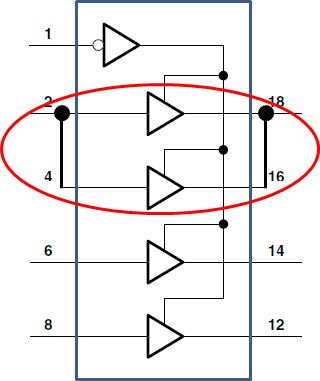

Hi Everyone,
Our customer has evaluated to use SN74LVT244B with inserted configuration to increase the drive capability. Then can you give your comments for following questions?
  1. Can you recommend this configuration?
  2. Can you guarantee the specification when they use it within the recommended condition per channel?
Sonoki / Japan Disty
  • This is OK if they keep the input lines electrically the same length. In other words the need the input signal to reach the part at the same time so there will be no bus contention.
    The part will still be in spec if they do this.
