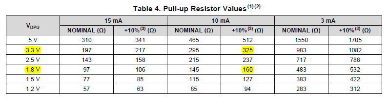

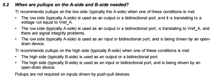

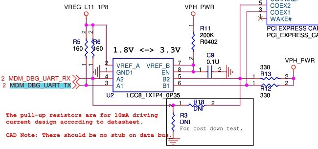

I follow the LSF0102 datasheet Rpu setting but there is some issue in Voltage_Low.
  1. For the following schmatic oniginal setting:    B1 Voltage_Low 1.31V, Voltage_High=3.43V
  2. remove R5:                                                            B1 Voltage_Low 0.615V Voltage_High=3.33V
  3. remove R5/R12,                                                   B1Voltage_Low -0.134V  Voltage_High=1.90V
  4. remove R5, R12 change to 1Kohm,                 B1Voltage_Low 0.184V  Voltage_High=3.6V
Could you help me about the Rpu setting issue?
