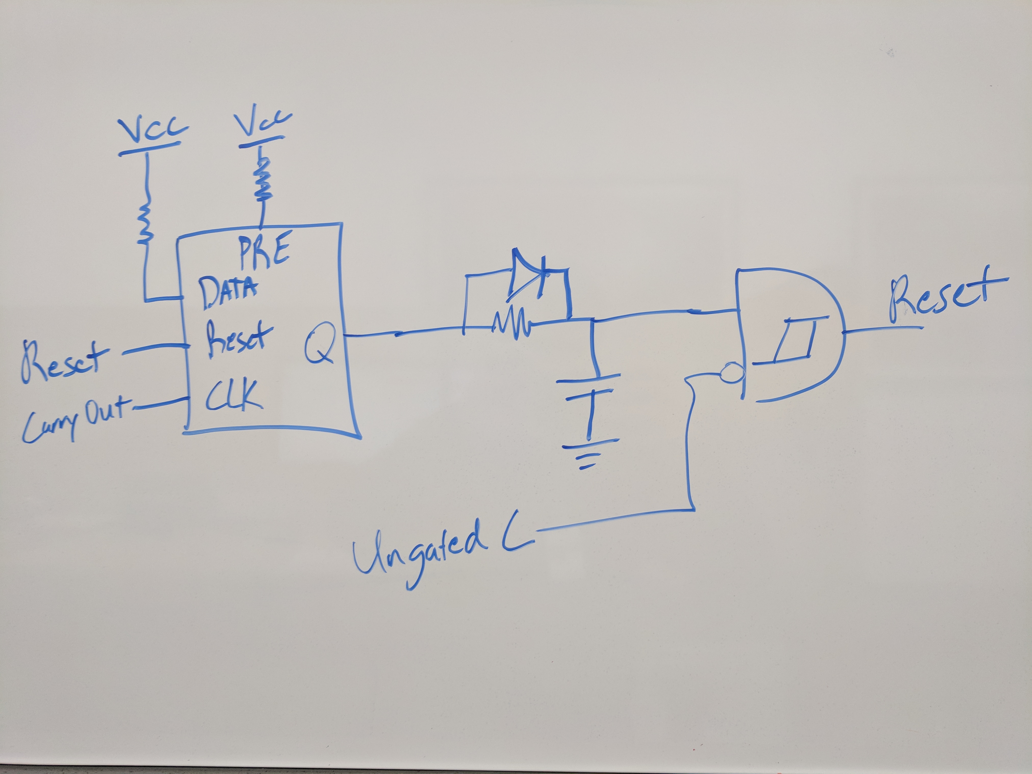

    I was able to come up with a solution that I believe works for 12 bit counting using some external devices.
    Please see the image I drew up attached.
    This circuit will reset the counter at 11 back to 0, so that it is counting by 12's. It allows the reset to trigger once it gets to 10 and then actually generates a pulse at 11.
    The Flip flop would be an SN74LVC1G74 and the AND gate with one input inverted would be the SN74LVC1G97.
    The only extension of this that i can think of to get to 60 would be a counter that counts up to 4 (from 0) based on the rising edge of the carry out and then doing a similar circuit to reset that counter.
    I don't see an obvious solution as to how to use only this chip to do 12 and 60 bit counting, i think additional circuitry is required.

  • Hi Michael,
    I've reached a similar solution, your solution should work, but it's far more simple to use some standard gates connected to the decoded outputs to do the job, or even a magnitude comparator.
