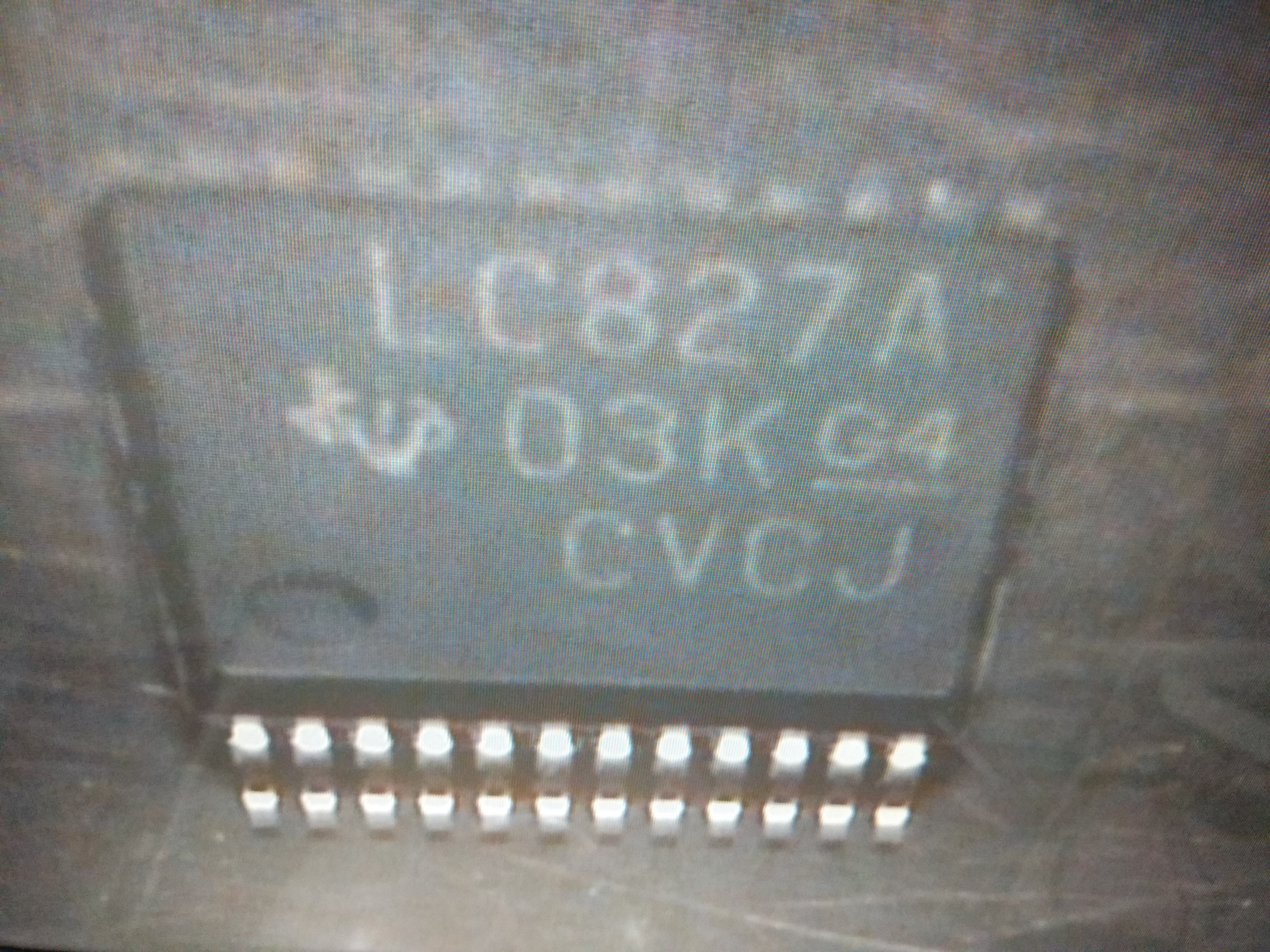

The top side marking of Part # SN74LVC827ADGVR is shown below. We want to know the date code. Please help.

Hi Saravanan,
This application report has some details on how TI marks parts: www.ti.com/.../snoa039c.pdf
It looks like this device uses a 2 digit date code: 03 -- 0 is the year, and 3 is the week code (week 18 to 23)
Unfortunately, with a single digit year code, it's a bit hard to determine the actual year of manufacture -- could be 2010 or 2000.
I can double check when I get to work on Monday -- can't access all the systems from my personal computer.
