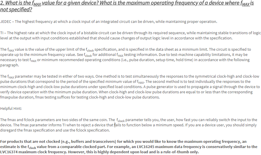

I want to know how to calculate the maximum allowable clock input of a logic IC, such as SN74LVC1G125 buffer.
The datasheet doesn't specify the maximum allowable input rate for transition signals such as clocks.
